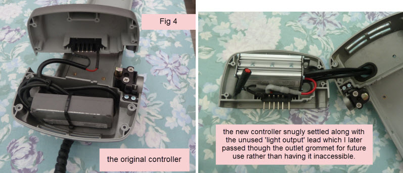

  • Next, the battery holder – first, release the 4 Allen bolts holding the pannier rack to the bike. Then turn the rack upside down to access the 4 screws holding the battery holder to the pannier rack.
  • The ‘790’ controller is located in the front part of the battery holder and is accessed by removing 4 small Philips screw on the underside. Once released, the ‘790’ controller can be pulled free.

  • The new controller does fit comfortably and tightly in the battery holder. You will need to fiddle around a bit to find the right orientation of the controller in the holder compartment but it’s easy enough. Take care of course to not put unnecessary strain on the leads as they exit the holder compartment.
