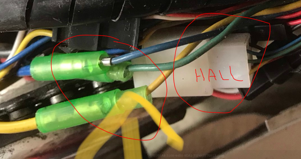

Can I just please make sure that these are the cables that I am continuity testing ?
Yes the three thicker phase wires and the thin ones in the white connector block.

So are the 2 Arrowe sets of wires the correct ones fir mosfet Tests . It looks like It as per the link given ?

I’m talking about the mosfet test As per your link sent to me . not the overall cable test Which is Already done
so Like in the photos on the link it’s green blue and yellow tested against the black and red . So Is my photo the correct ones

Yes, those three phase wires circled are the one to test do exactly as in the link I posted, disconnect the controller to do it and short the controller v+/v- wires together to discharge the controllers residual voltage hele in the main capacitor.
If any wire was shorted and since been repaired by tour man then there is a very good chance a mosfet or two is damaged.
