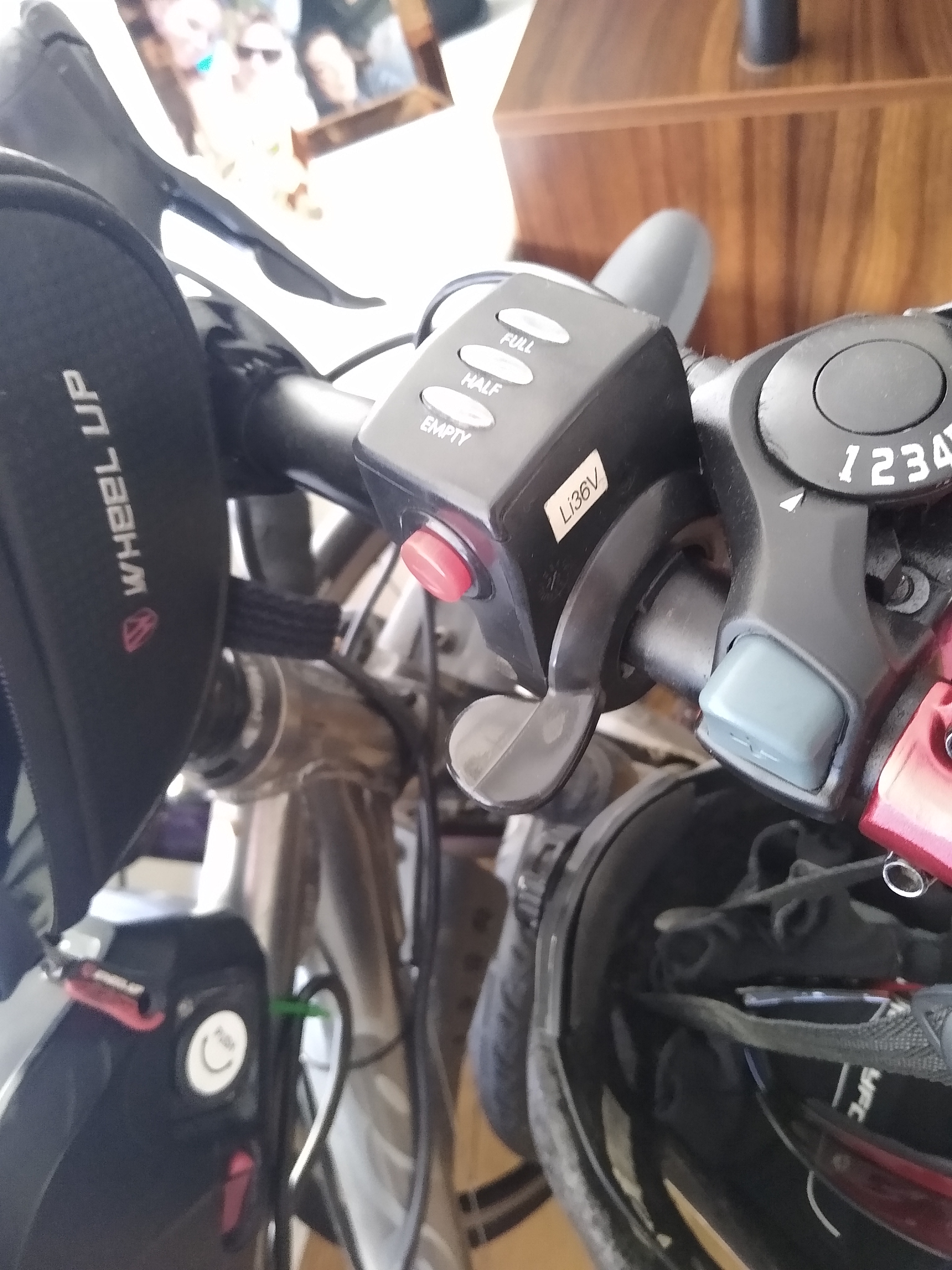

Hello!
I am a tad confused and scared now reading that i might catch fire :D
The person who did a conversion kit for me said the motor was a 500W motor.

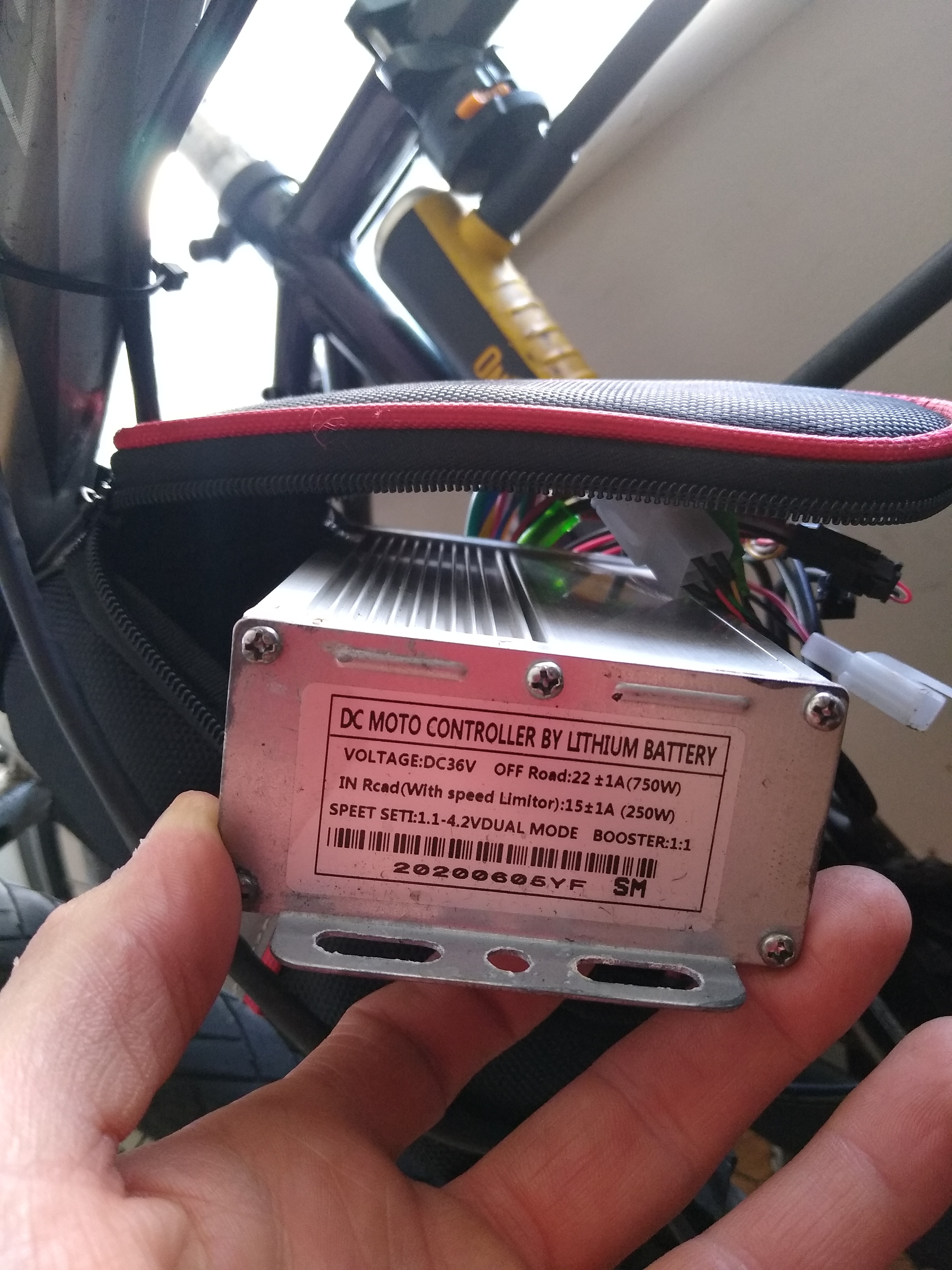

Controller reads 36V 22 A +-1. So that adds up to somewhere 750W?
Off road i manage 44km/h without much effort.

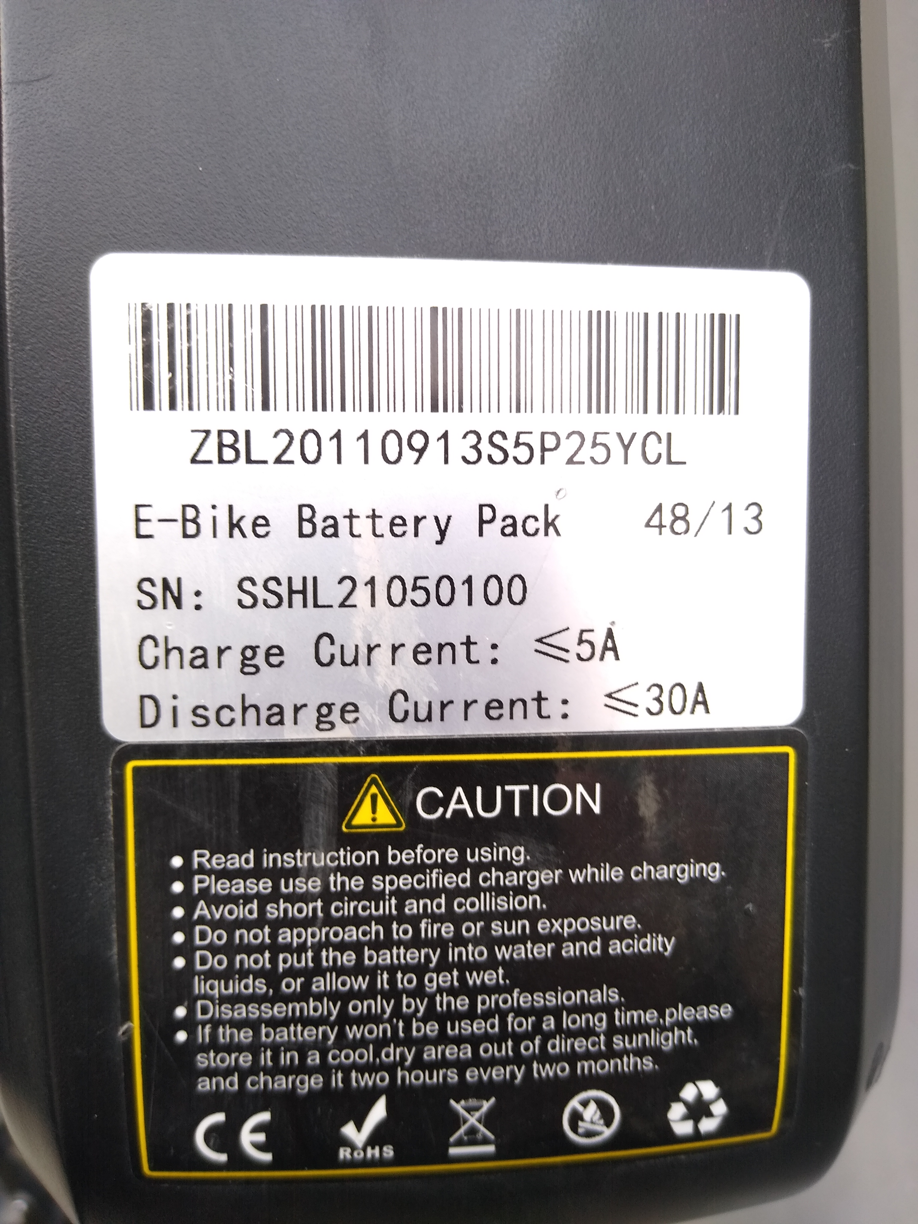

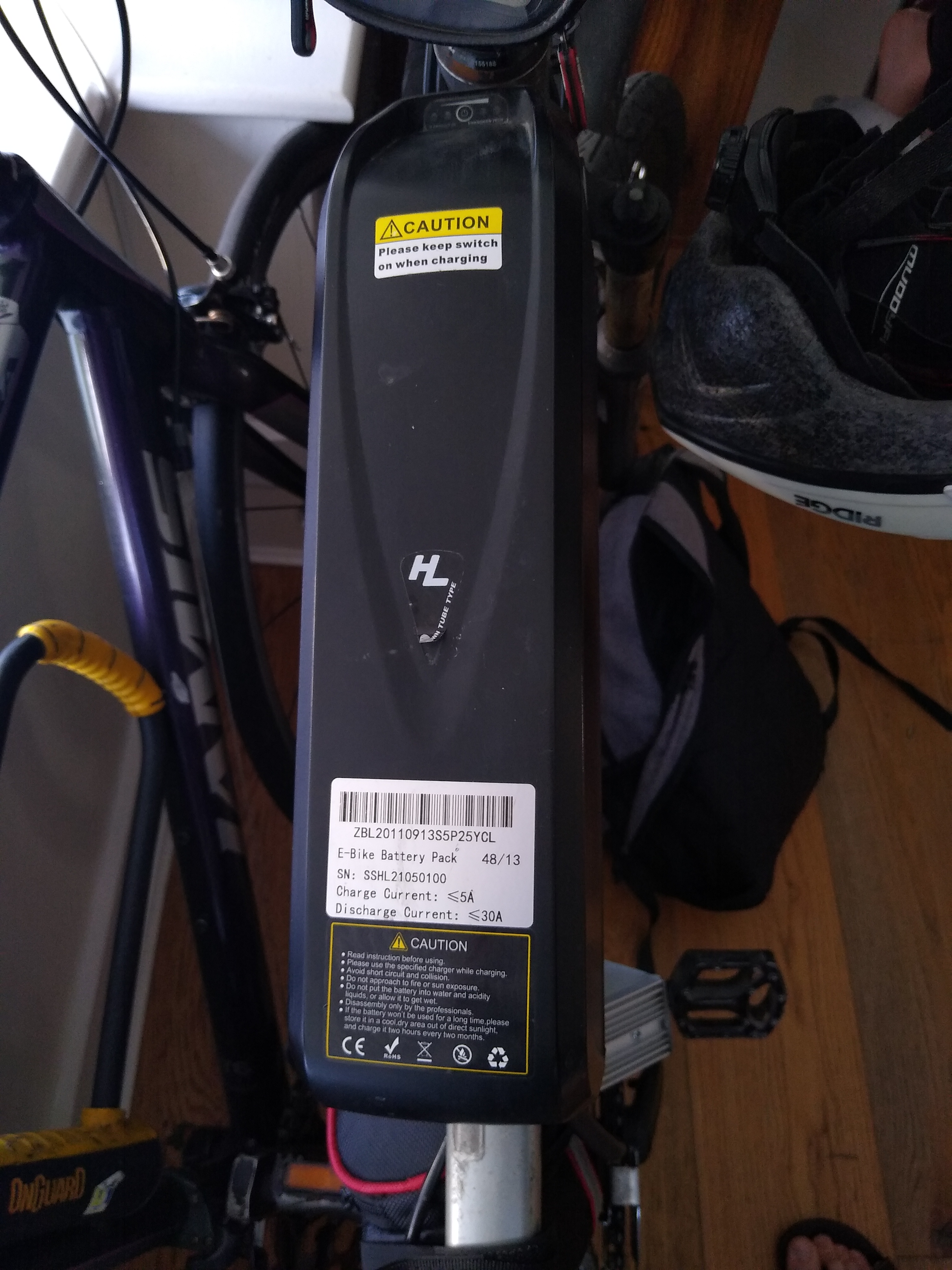

Now what got me confused was that the battery is 48V 13A? Is that the reason my controller gets hot to the touch or is it my pouch should have holes for vents or something?
I dont seem to have problems with it besides controller saying 36V and battery being 48V.
What's causing your controller to get hot is the high speed of the motor. It'll stay cool while you're going fast, but when you're travelling at lower speeds with full power, it'll become hot. Basically, the controller is running at 22A more of the time. It's only rated at 11A.

The controller is only rated at 36v so will be running inefficiently at 48v, one would think you must have a 60v capacitor inside, 22a at 48v nominal is a lot. The hot running of the control will be down to running slowly at higher current.

What may or will eventually happen is the controller will start cutting out thermally as the mosfets will go beyond their temp rating, once they & the controller cool it will work again for a while. Controller can easily go beyond 60c once they get very hot.
You shouldn't catch fire but scalding may occur and if crappy bullets are used they or the plastic shrouds will melt on the phase wire connections.

Okay i assume what you mean is acceleration is harder on controller than staying at high speed.
I red in another thread that having different Voltages between controller and battery/motor will cause damage. I guess i red wrong.
Can you elaborate regarding regarding the 22a at 48V? Since controller is 22 and battery is 48, that means controller voltage is not important?.
I have close to zero knowledge about electronics sorry :)
There comes a point where to many amps x voltage will be add to much heat for the controller to handle, the mosfets will be heat sensitive with a max temp range.
At 36v/22a the controller will typically give 792w at 48v this jumps to 1056w, the components in the 36v won't be normally configured for 48v use continuously.
48v is making the controller work 33% harder so if it can't do so that extra voltage
in your case will be wasted as heat by the controller, the heat is generated by the mosfets. Heat is due to inefficiency of the mosfets.
The motor won't see all of those watts due to efficacy conversion typically at least 20% of those watts will be lost.
At some point the controller will either cut out thermally or fail altogether.

OK, what you have is generally well matched apart from the motor being too fast for the power you're giving it, so it's running with full power more than the controller is happy with. You'll be OK as long as you're gentle on the power at low rpm.

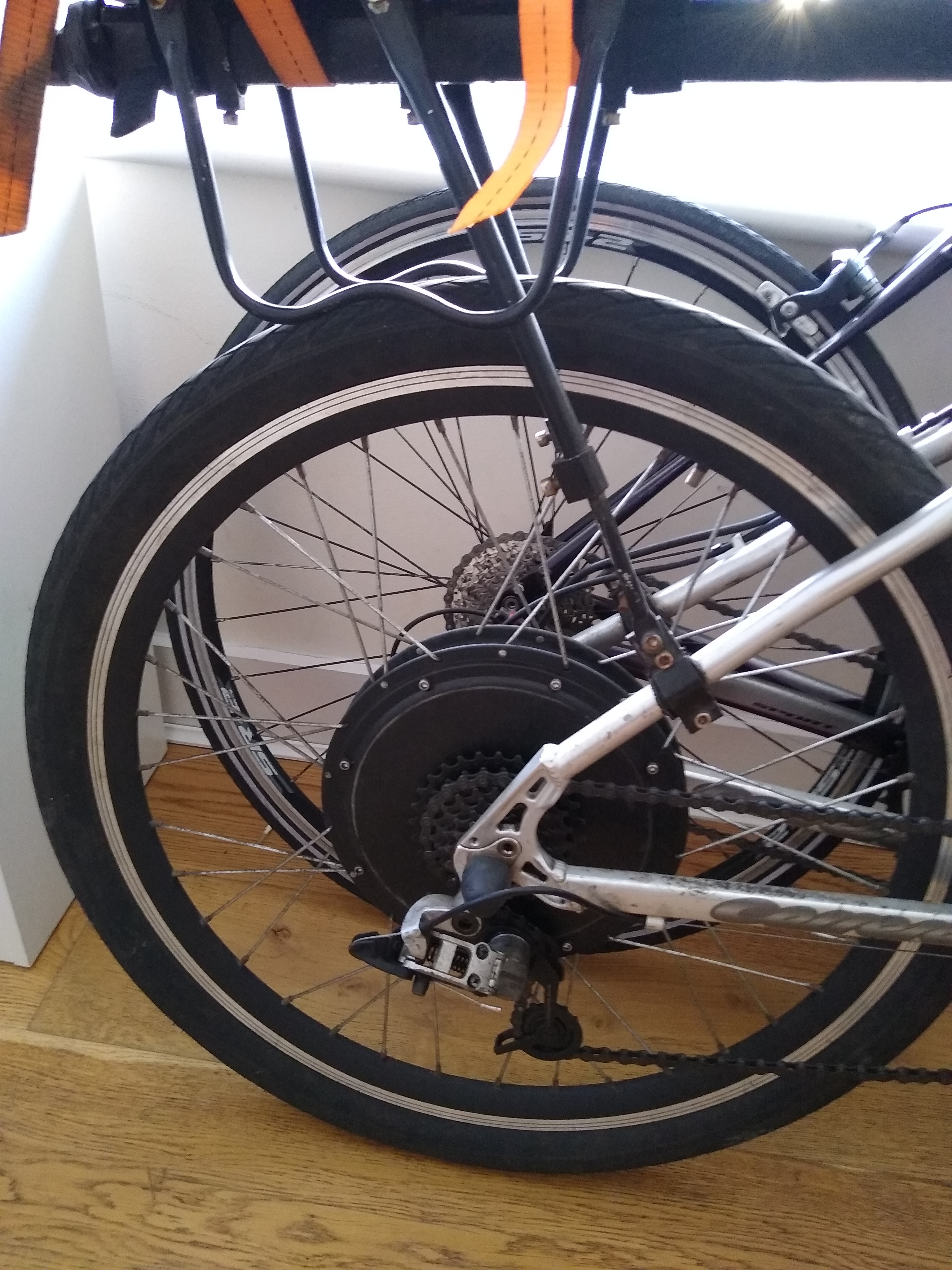

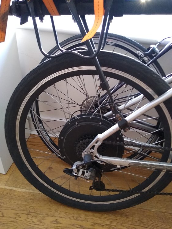

Motors don't have a voltage. The two important characteristics are the size and the speed. Lift the wheel off the ground and spin it up to full speed. make a note of the speed, then measure the battery voltage.
Assuming a 26" wheel and that your speed is set correctly:
Motor KV = rpm/volt = [201 x (speed in mph)/15]/battery voltage.
Makes no sense :D I bet its funny and irritating at the same time for me to make such silly questions.
Your hub is a Direct Drive model although it has a restriction between 250w and we assume 1000w it probably has winding of about 390rpm or so. In a 26" wheel that might equate to around 30mph at 36v/ 22a, at 48v the rpm will increase by some 33% to over 500rpm that in turn would equate to about 39/40 mph.
As vfr has said hubs don't have a voltage but initially they are sold with XXX rpm/winding for X voltage, by adding more voltage then the hub will run faster and at less efficient at low speeds which is where heat comes in to play.
