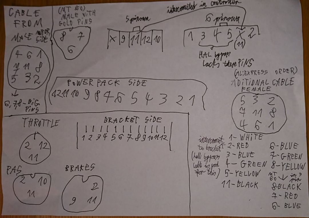

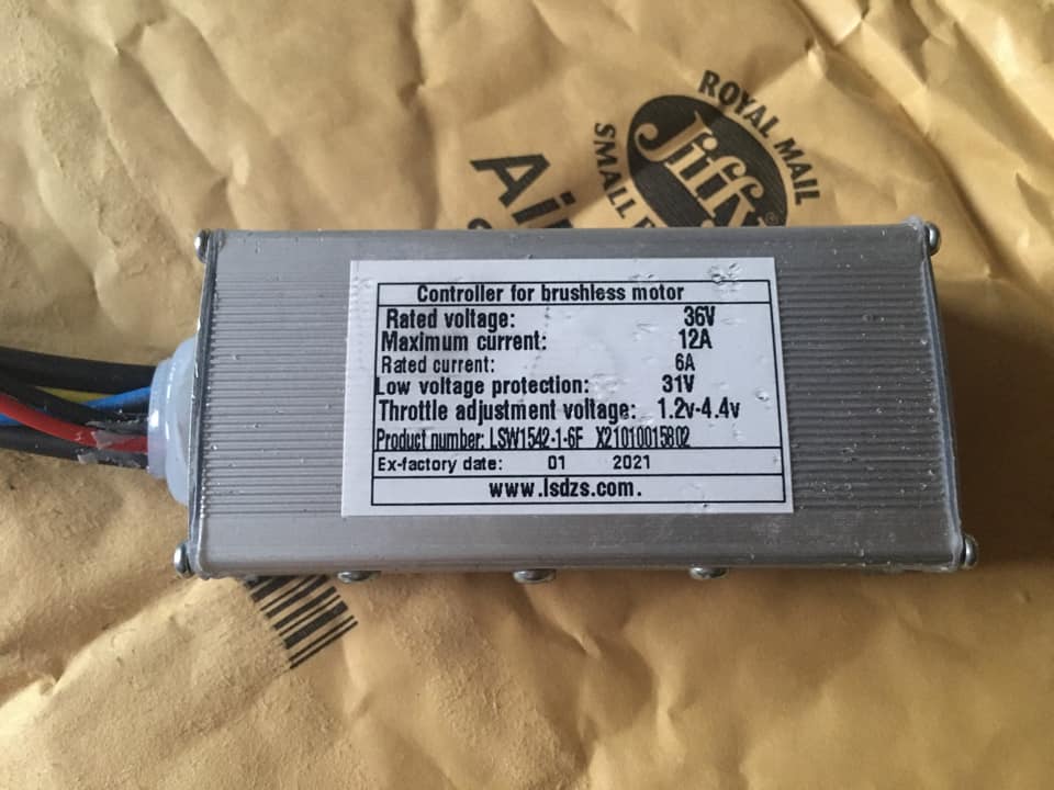

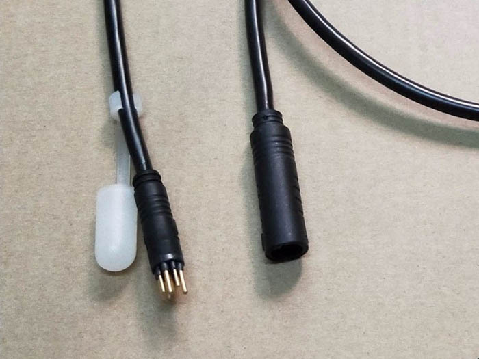

I have started to document this kit. Might be helpful to others. This is the eco kit. See pictures of controllers and pin outs. Believe the motor could be a AKM 85sx (current guess).
Note: these are not my pictures but found them in other forums, etc.

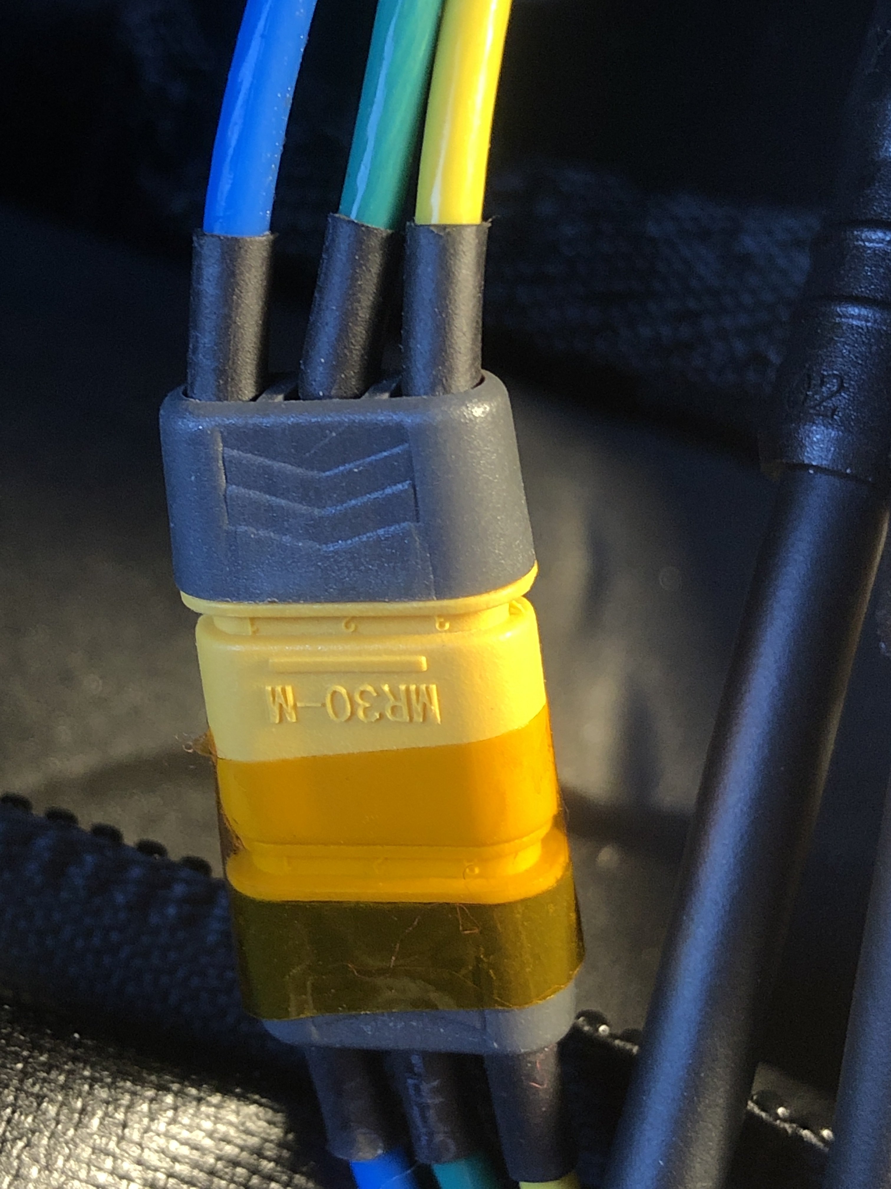

The connector is a weakness because so many contacts have to be disturbed each time the pack is removed and replaced. Must be 8 for the motor and three for the cadence sensor as a minimum? Compared to just two for a normal generic battery.
The taking off from a stand indicates multiple detected 'pulses from the cadence sensor, which if the software is unsophisticated could be a dodgy connection. Better s/w would examine the waveform for clean edges and realistic on/off periods, and signal error if outside reasonable limits.
I think packing the bag contents tightly will make it worse, not better. Now all the inertia of the relatively heavy battery is tightly bound to the connector, and every little bump will be transmitted to it, increasing the likelihood of glitches
Ideally the physical restraint and electrical connections need to be separately implemented..
So yes, I think a new connector might work, but 7 months is a long wait.

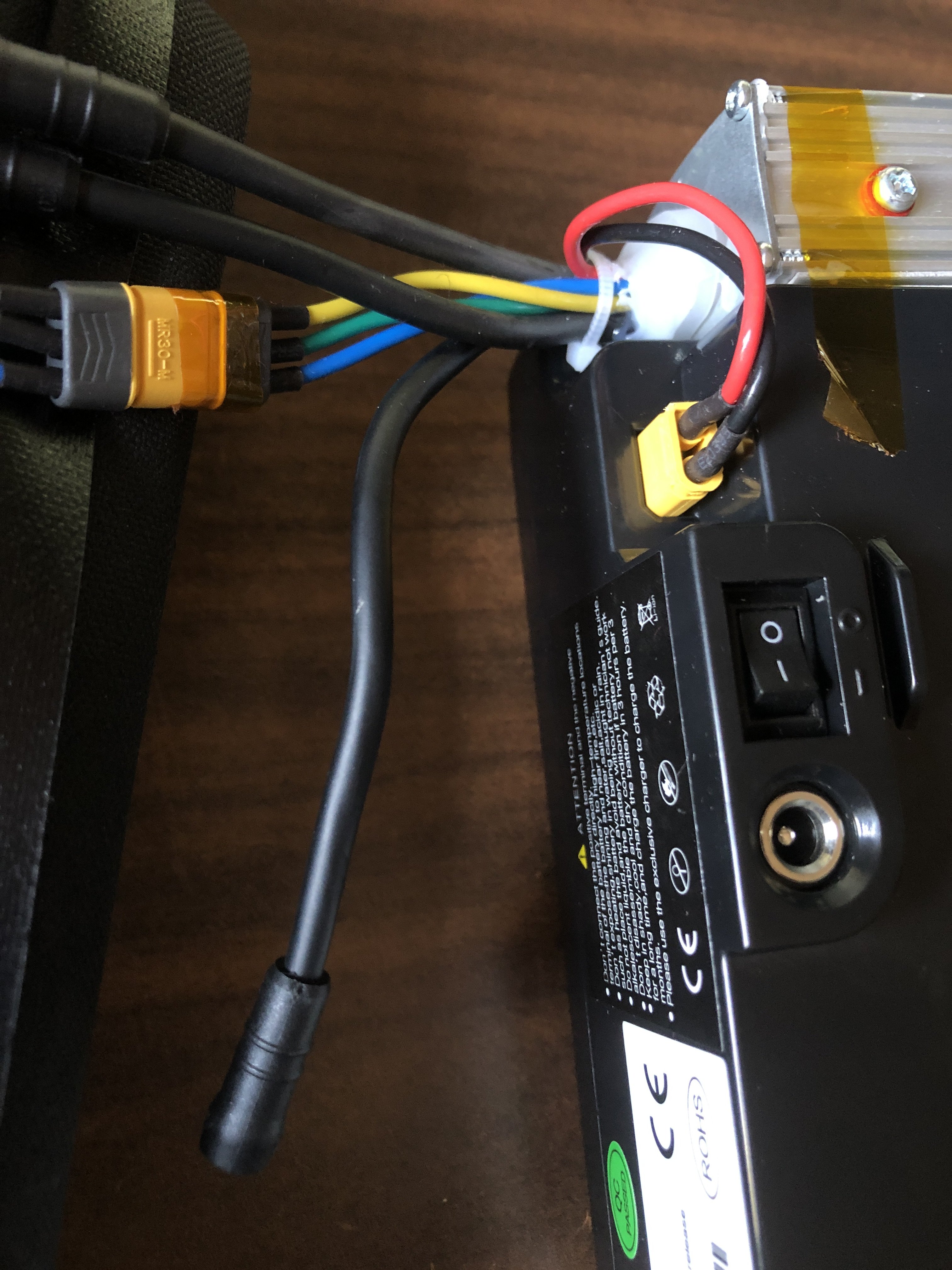

I pulled the battery pack apart to look for any loose connectors that might be unseated. Also verified the controller which which was built 10/2021 but otherwise identical to the picture I posted from someone that received a replacement controller for similar motor cut off problem. A casual observation looked like everything is firmly attached and they use plenty of conforming glue/coating or re-enforced the ends of tehir wires to hold things in place and provide additional mechanical stress relief.
I have not looked too closely at the part they plan on replacing - only from the outside. The few pictures I could take of it and magnify any external wires showed no evidence of stress on wires. Seems to be common enough that everyone has a few workarounds that sort of help for some. As for being at rest and motor starting, It also plausible that something has triggered the controllers walk assist mode which doesn't require PAS signalling and only needs a signal or spurious signal to initiate?

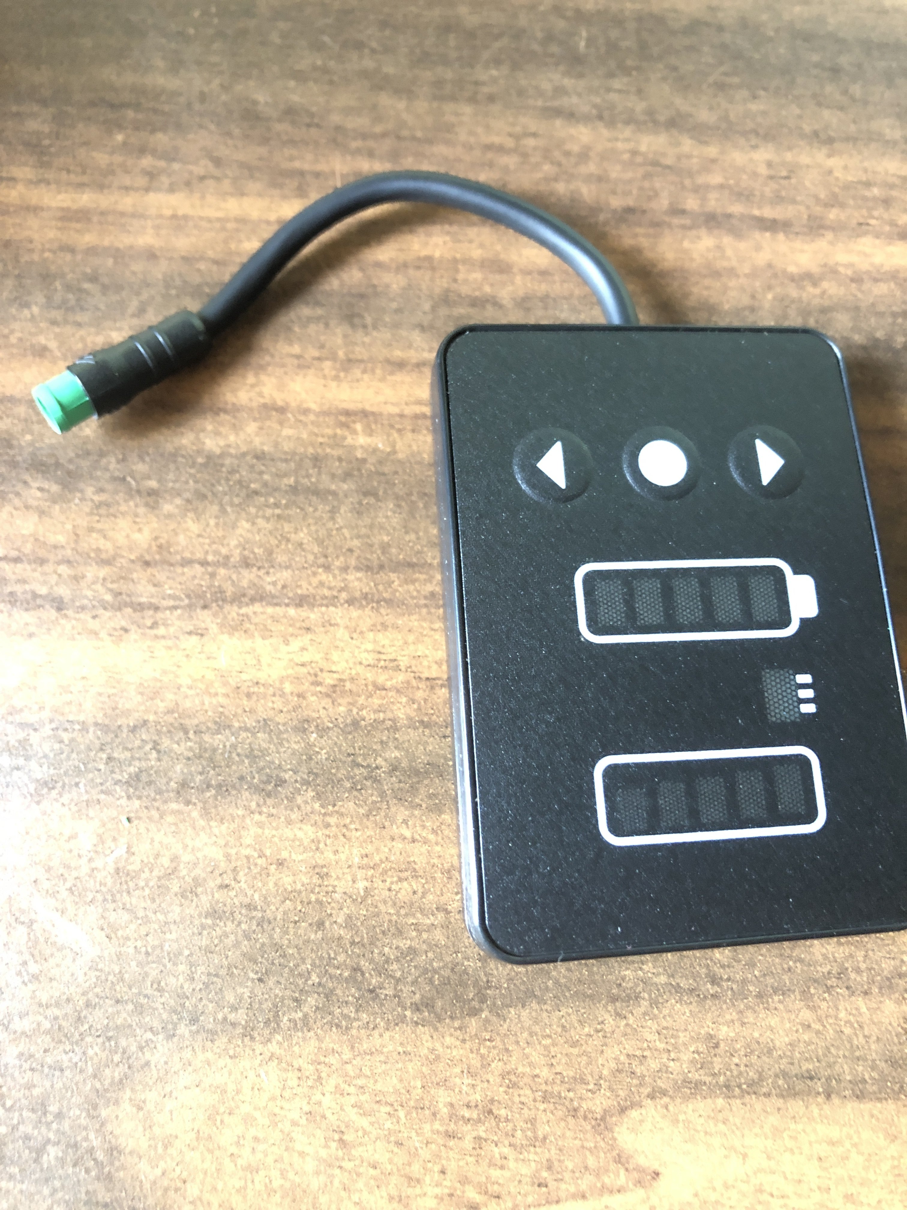

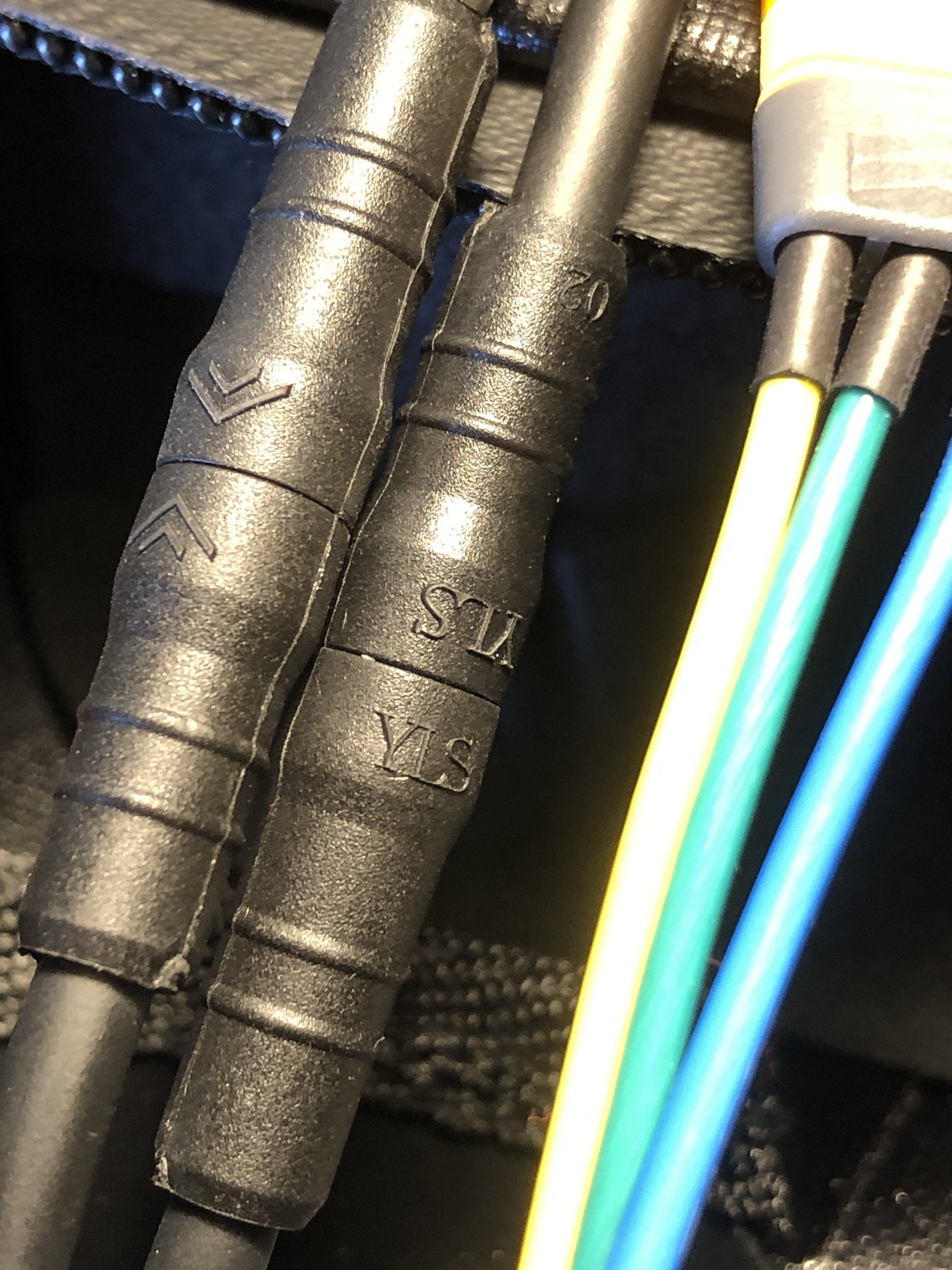

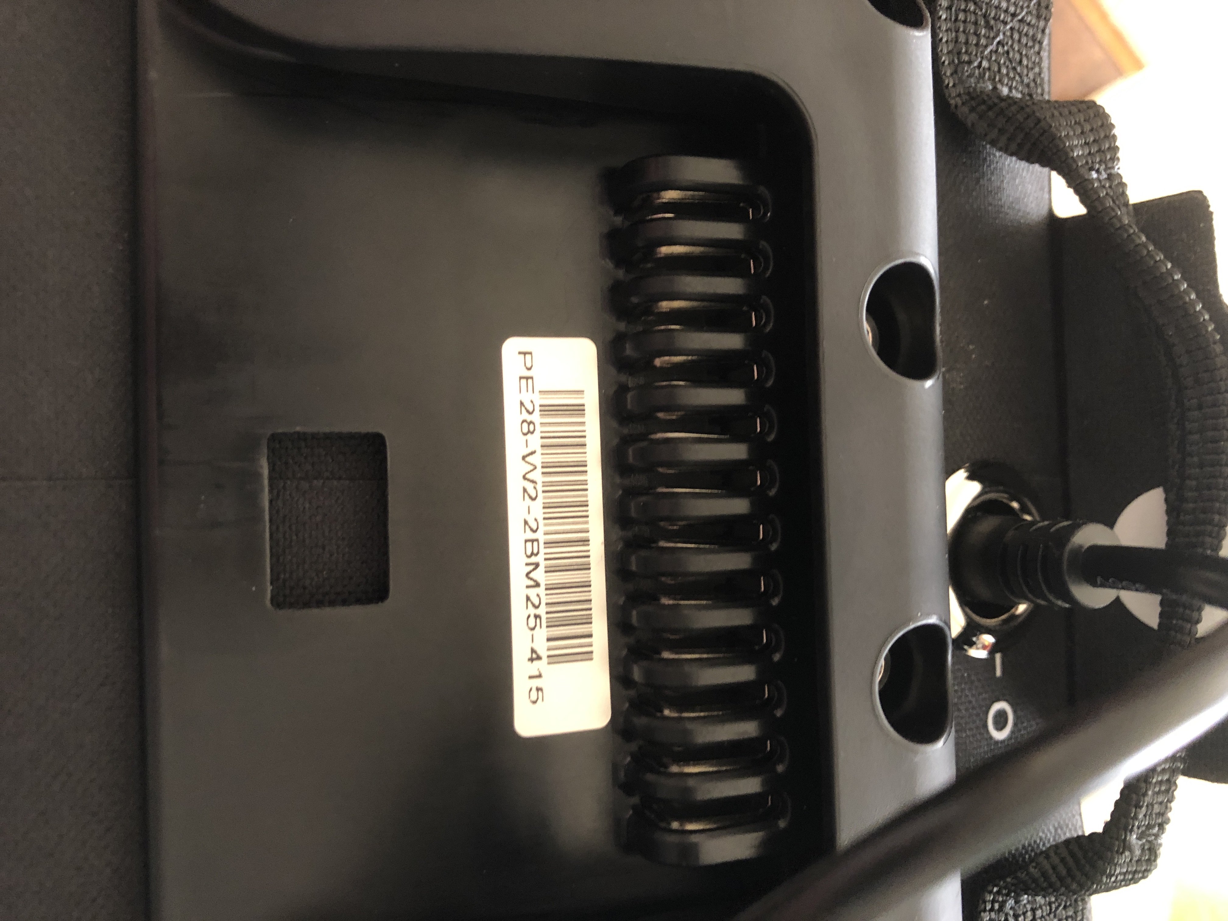

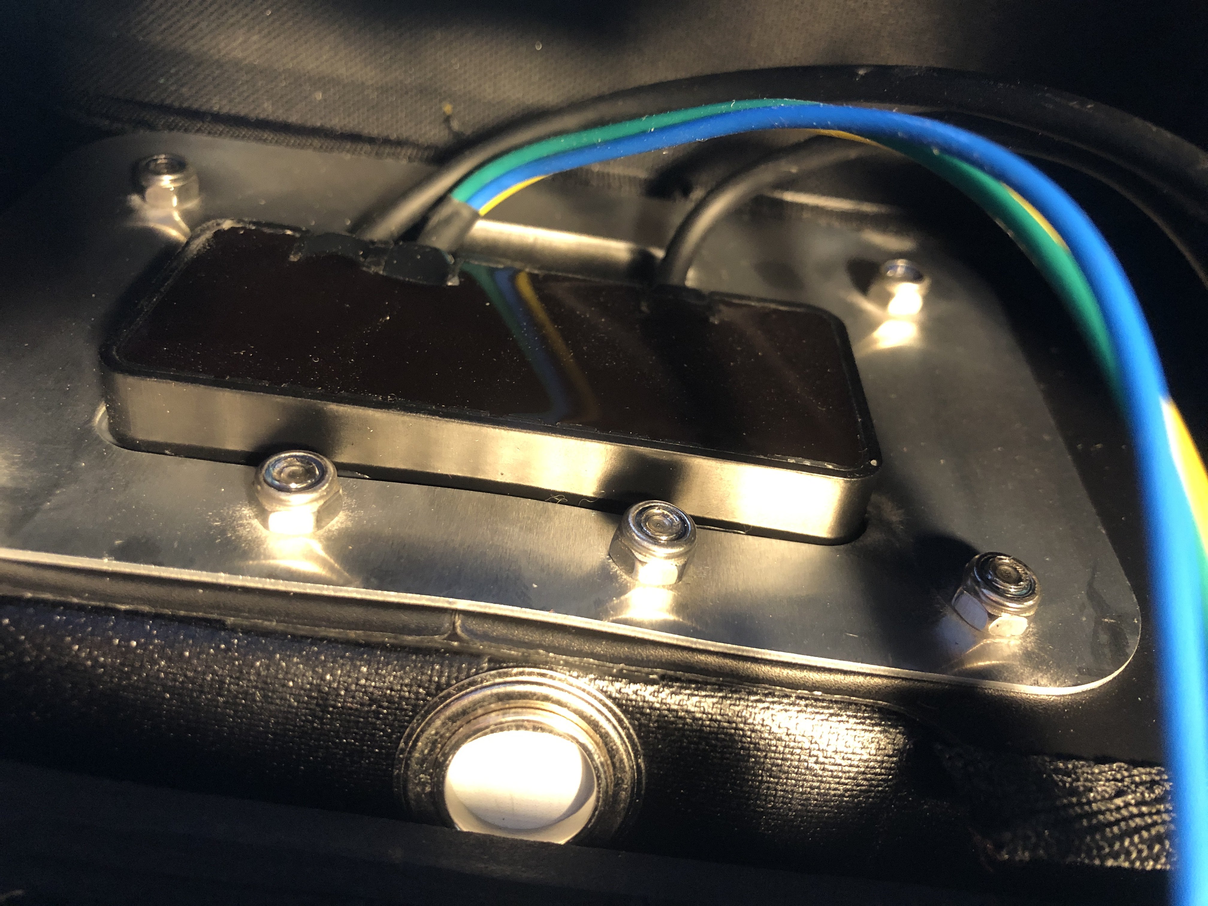

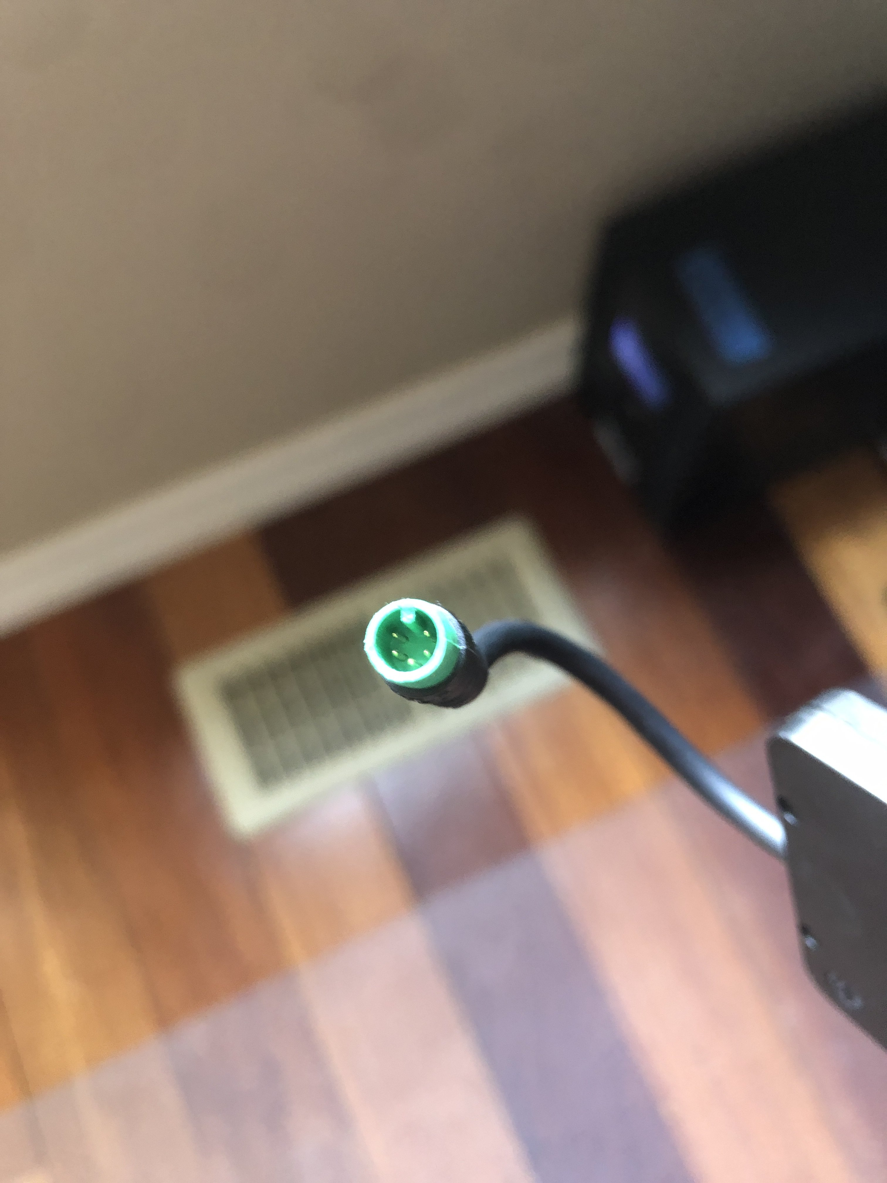

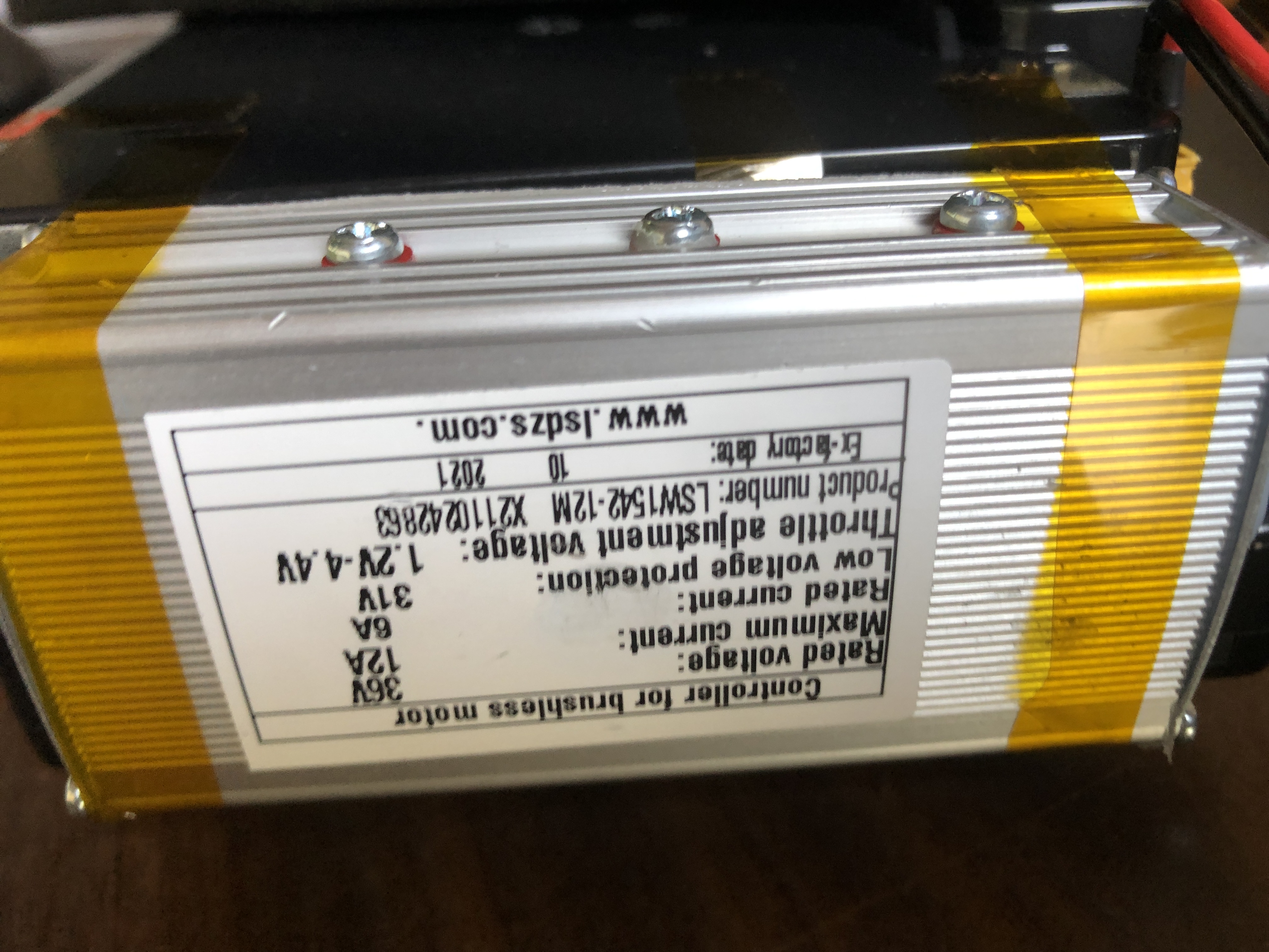

A few more pictures from our kit (eco) to help others identify parts/cables that might be needed in the future.
Those images are really useful, thanks. I’m waiting for an eco kit to arrive for my son’s bike. But they’re messing me about with delivery dates. I was sold on the light weight motor but am starting to question the quality of the kit from what I’ve read!

Two suggestions. I believe the motor has a standard 9 pin Bafang cable?
