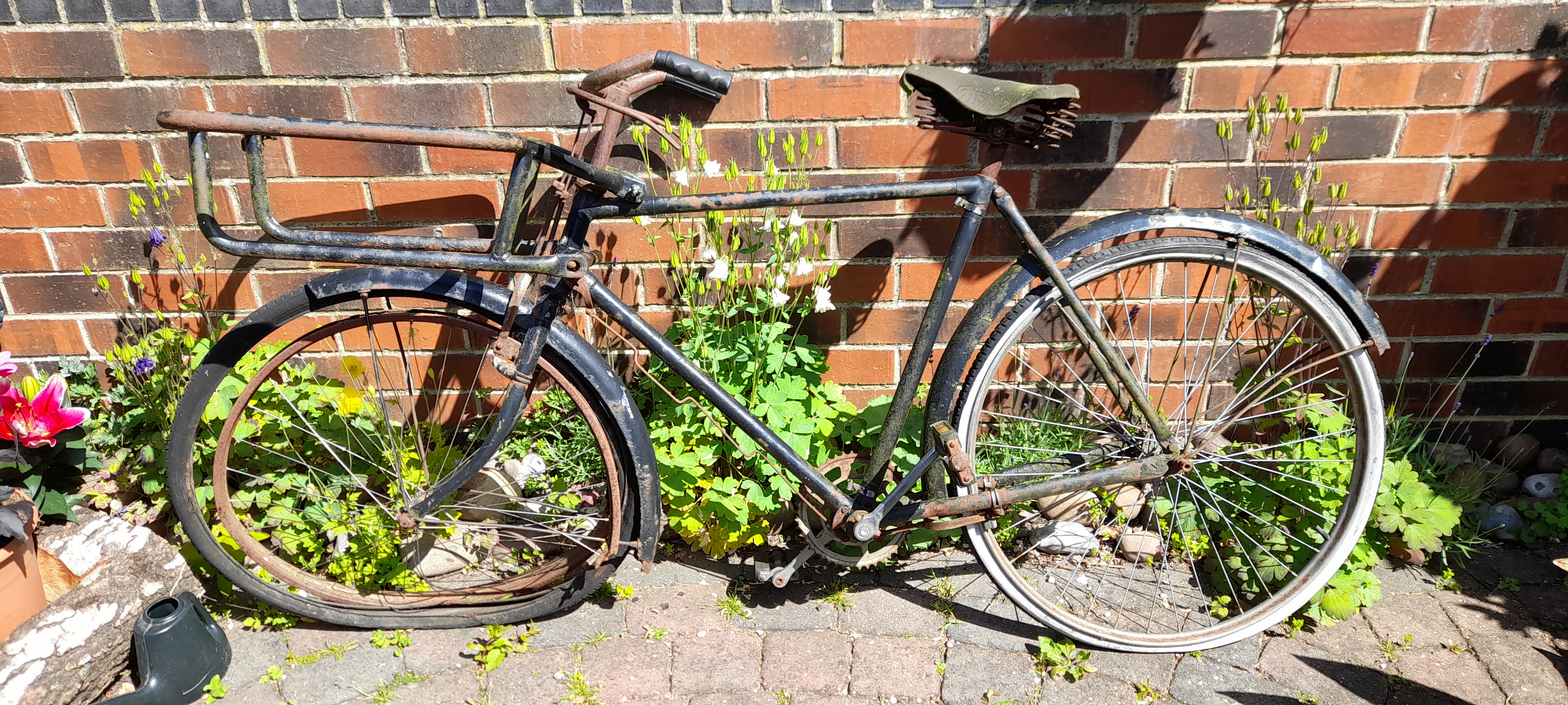

[ATTACH type=full" alt="20220611_105629.jpg]47674[/ATTACH]
So there is lots of patina! - which is the look I want, but the frame and forks are sound. Wheels will be replaced and laced to a front hub motor and at the back I am thinking a geared hub with drum brake so as to keep the look as original as possible. Something like this: https://www.sturmey-archer.com/en/products/detail/rxl-rd5

What size are the wheels? You may have difficulty getting a front wheel ready made up with motor of the right size, but perhaps you were thinking of building it yourself anyway?
If you fit a decent capacity battery under the front basket it is going to add a lot of weight on the front wheel. The bike geometry should be such that it can handle quite a bit of weight at the front, but the battery there will limit luggage weight. On the other hand, put it on the downtube or a back rack and it will destroy the look of the bike.
I suspect the bike was designed to be used at 6-8mph or so, with some daredevil butcher's boys taking it downhill much faster! You'll probably be going a lot quicker than that with a motor.

Point taken on the weight, I considered hiding the battery behind a traditional sign in the frame triangle, but width might be an issue - opento suggestions. Re wheels, yes, plan is for two new rims laced to the drive and gear hubs.
I think the best thing is to get the bike road worthy first, then think about a kit. I know it means messing with the front wheel twice, though one can buy a built rim reasonably on ebay as used.
Pics of the fork drop out as the bike is old, it may even need new forks ?

Will certainly be checking over and replacing/remanufacturing anything that needs it including brakes, bearings and frame/fork elements that need it.
I used to ride one of these on Saturdays as an 11 year old in the 1940s, delivering weekend joints and collecting the money for the local butcher. This style of trade bike always had 26" wheels. The BPM motor that sjpt mentioned would be a good powerful front wheel choice, but the battery should definitely go onto a rear rack to give better weight balance. Those high front goods baskets do make them a bit unstable when loaded.

Your front brake won't work with any standard kit. You need a special rim and it's a special size too. It will be the same for the back wheel too.
The OP has said he will convert to new rims and brakes, a front hub motor with disc brake and if possible, a combined hub gear and brake for the rear wheel.
I am hoping to retain the original rod brake lever assemblies and couple to cable actuated disc on the front and drum on the rear. (Some additional bracket work behind the basket will be required.)

Many if not all front hub motors have an OLN=100mm. Will that work with your forks?
Thats the distance between the fork dropouts? Thanks, will check that.

Just took put the front wheel. Looks to be 88mm between the drop outs.
