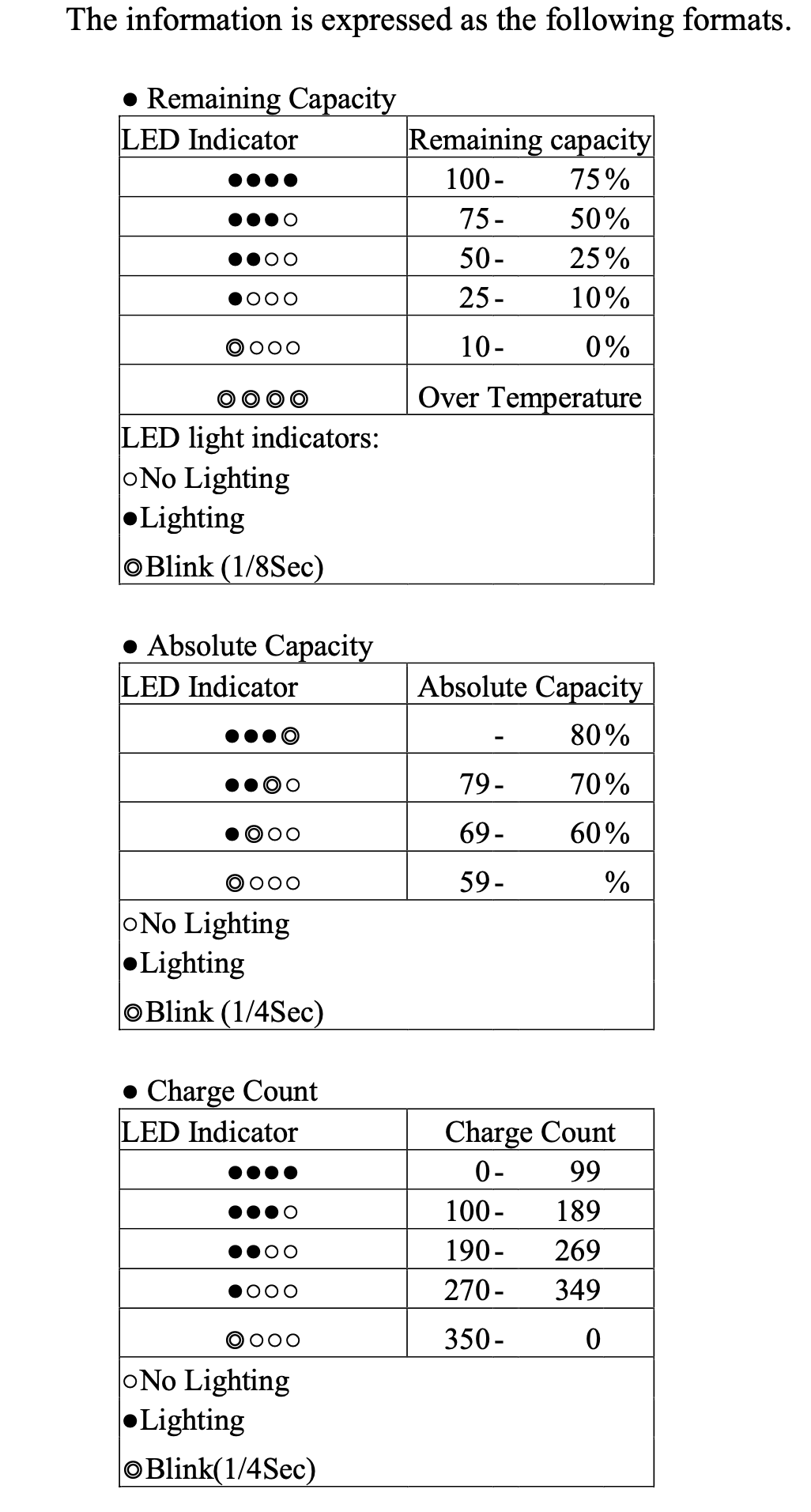

Hey everyone... I missed out on the woosh kit unfortunately - however I found a 2020 carrera subway e with very few miles on it (less than 99 charge cycles, battery showing 80% + capacity) and perfect condition (the tyres and brakes look pretty much new) for £250. I don't know if I'll keep it as those bikes don't seem to have a great reputation - but I'm going to trial it out tomorrow. Can always sell for a decent profit if not. I've also been offered a second battery for a reasonable price, so maybe for now this is my budget solution and I'll build a proper bike when I've decided if it's a viable commuting solution or not. Thanks for the help everyone!
How do you know for certain that it's had less than 99 charge cycles? I don't know much about ebike batteries, but 20%-ish loss of capacity seems like a lot for 99.
Edited by guerney
So it's between 80% and 100%... the battery display only gives you figure accurate to 20%

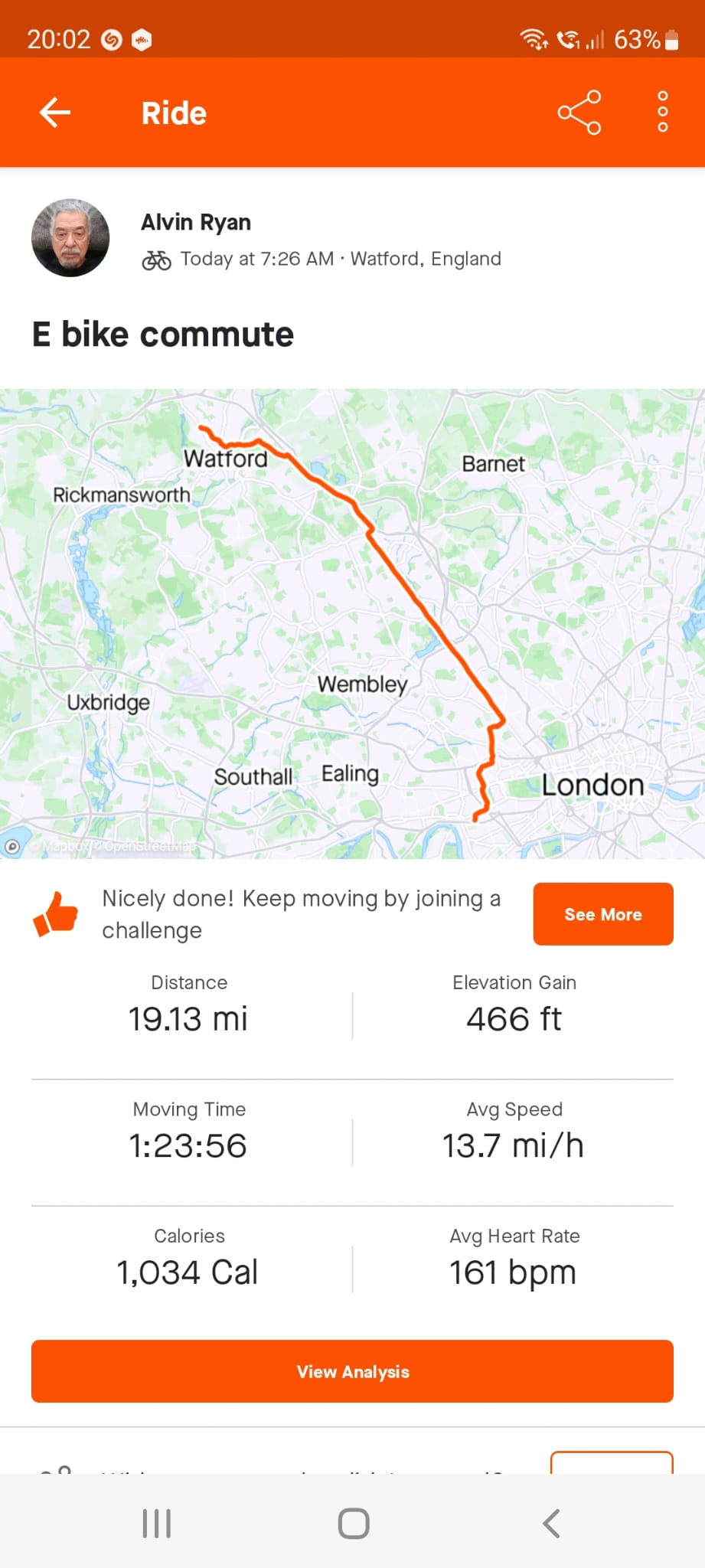

So I trailed the commute today... I was worried the battery wouldn't last, but still had two bars on the display by the time I got to work. Fully loaded with pannier bag etc - also wasn't quite sure of the way so had to stop a couple of times. I reckon I can get it down to 1 hour 15... but I don't think the 15.5 mph restriction is doing it for me - and the careera feels sooooo heavy. Trying to maintain speed above that is hard work. I think I'll end up selling, buy a kit and build something lighter.
