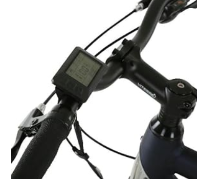

Hi there, any luck with sorting the battery buddy? Can you post another picture please as she's no longer linking? I've just picked one up and i'm thinking about doing a cell upgrade.
Do you have instructions with yours, daft question I know but do you know how to turn on the LCD illumination?

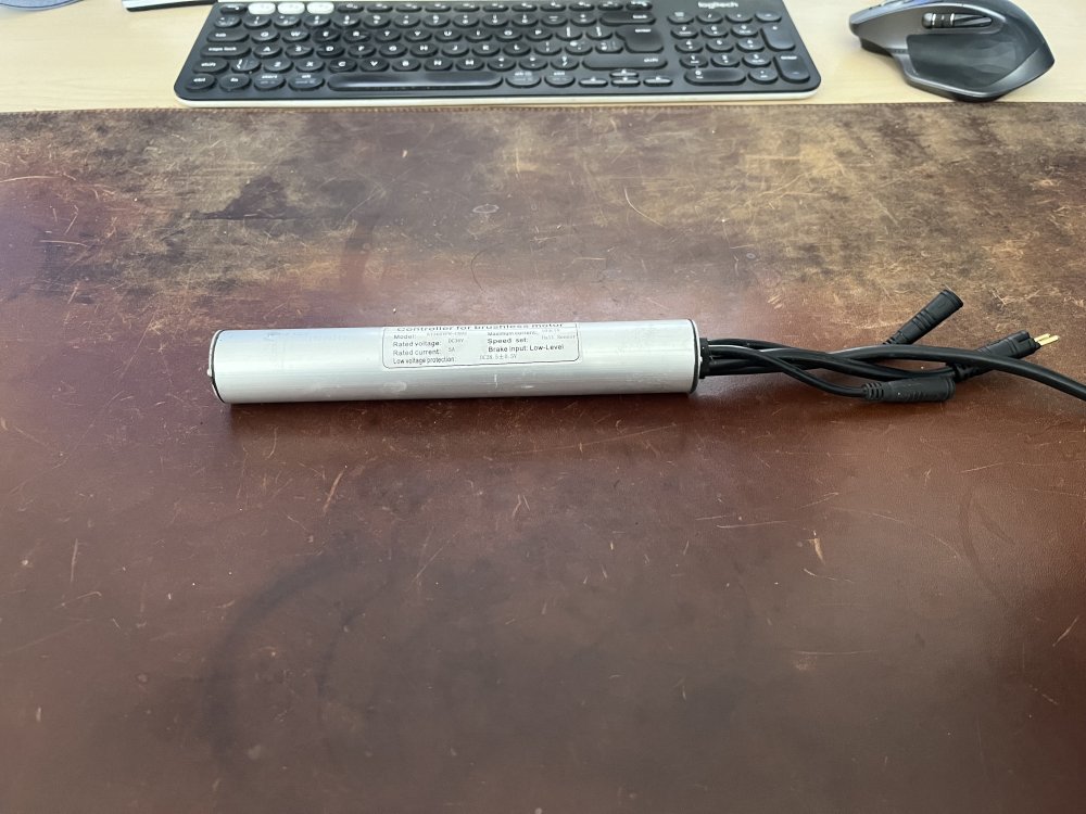

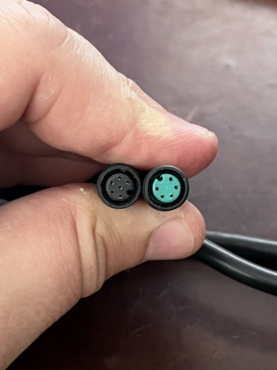

Same as a Swytch kit, you find the two wires between the controller and battery, cut and extend them so that they come outside the frame, put a male connector on the controller side and a female on the battery, so that you can connect/disconnect them when you want, then you can get any 36v battery you want, put a matching female connector on it and have as much range as you want.
If you want to run with both batteries, it's a bit dodgy, but as long as they're both at the same voltahe (+/- 0.5v), you can connect them with a Y-lead, but make sure you disconnect them for charging.
