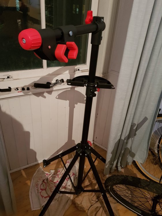

It's unlikely that the stand (I have similar from amazon), will be strong enough vertical locking so for me when my rear hub is on the bike (1500W), I cannot raise the stand as it's too heavy for the screw locks to hold and main stand tube slides down to min height meaning bike is not really raised much. It works OK with rear wheel off, it's strong enough to hold.

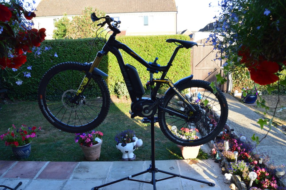

They will though hold up most pedelecs quite safely.
Halfords bike stand I bought this one. It works for me with a 20+ kg bike. Wouldn't be without it.

I bough this one here from amazon about a yr ago and used it a lot to prep my frame for the ebike build. When built I did try my ebike with battery removed and frame/rear hub adds up to 24kg in total (30kg with battery), I tried this in the stand but when the vertical is extended the clamps don't hold it and it slides down to default height, I was a little annoyed tbh it wouldn't hold 24kg.

OK, I see what you mean, attach jubilee clamp where I've marked in yellow (or further down tube for more height) or so it's TIGHT against vertical tube, this should then stop slippage, will probably need to be careful and not over-tighten the clip when wrenching tight

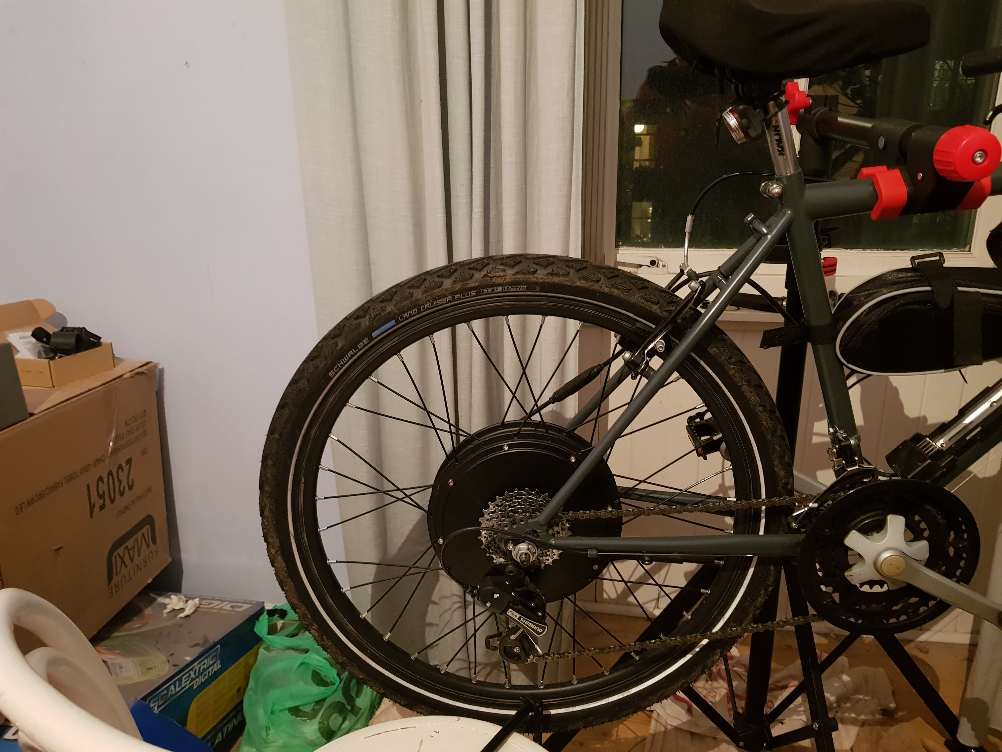

I tried the stand again lifting up ebike with help, after fiddling with stock clamp it will hold ebike in place vertically! I'd like it maybe 6 inches higher so will try that too at some point.
So it will take 24.5kg (weight of my bike) as it's rated for 30kg however not going to try the max by adding in the 4.5kg (52V 17.5Ah) battery pack.
I have to admit I'm slightly nervous it will decide to collapse in the middle of night damaging the rear hub so I've placed an old white chair with old cushions on it underneath rear wheel just in case...
I plan on leaving the ebike in the stand for a cpl of weeks and will report back if it does break anything or collapses....

This looks identical to my cheapo Amazon job. The problem is not the weight of an ebike (just take the battery off) The steel tubes lock together with plastic moldings with tightening clamps as above. Unfortuanetly, after no time at all, all the joints stop been completely lockable resulting in the bike been easly moved (though still safe to work on) Some of the gaps which should tighten up end up been completly closed meaning you can't fully tighten it up. I tried filing down the plastic to make the gap bigger but it wasn't really the answer.
My advice would be to look for a stand with metal joints as I think all the very cheap ones might have this fundamentle plastic problem.
