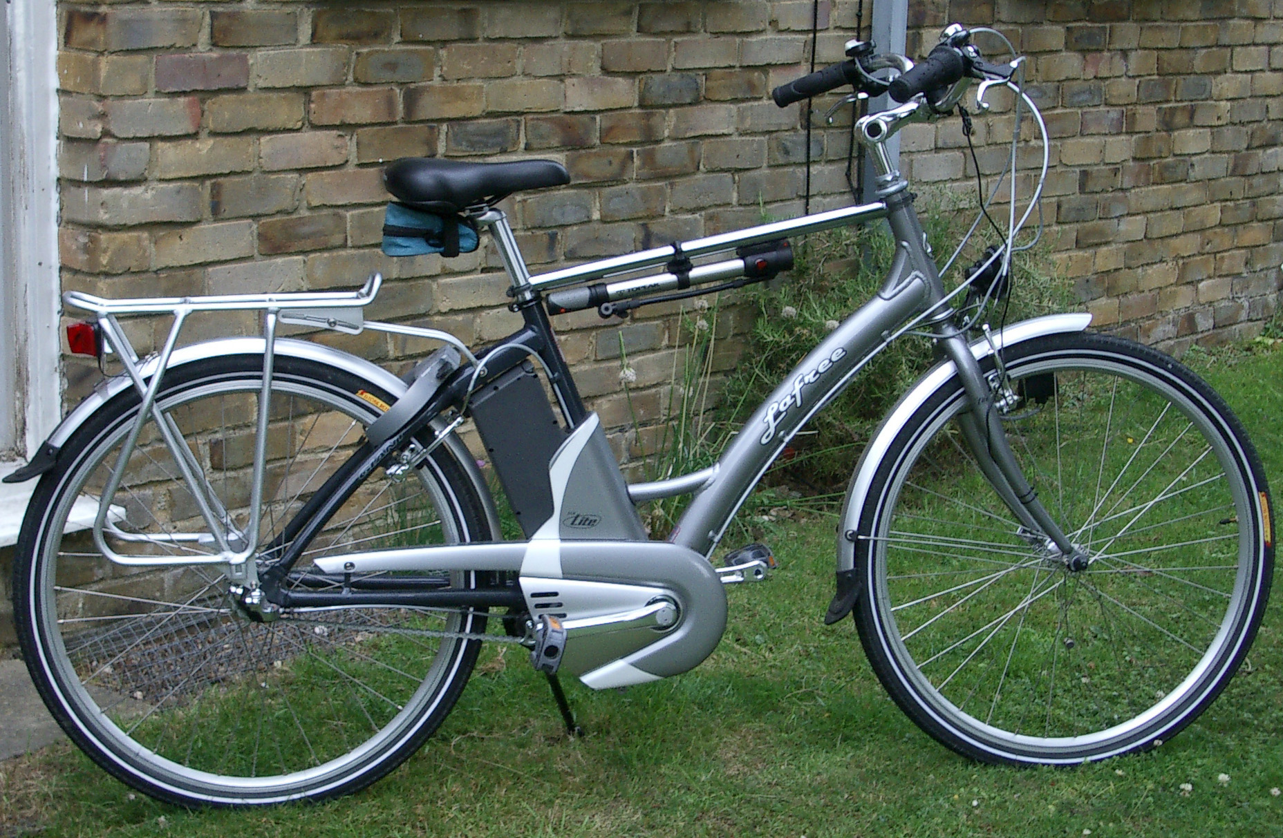

I'm with Neale on racks needing to have a large range of utility uses, so I don't like the trend for attaching racks onto mudguards. Both the Giant Lafree and Ezee Quando I owned at one time had the identical very sensible rack. The best features were:
So strong, it once even carried a big old 32" CRT TV for recycling and on both bikes my car-style central rear towball was attached to the carrier frame to tow my large trailer, not the bike.
For and aft levelling adjustment.
Rear support for pannier bags to hold them clear of wheel etc.
Adequate pedalling to pannier clearance.
I never know why so few racks have that.
