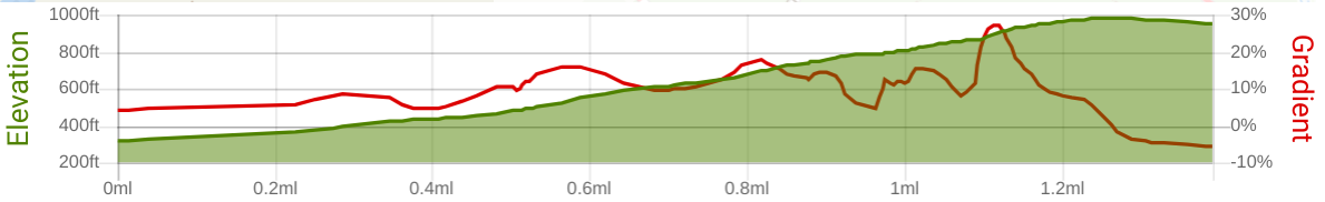

Super impressed with my 48V Bafang SWX02 / G020 on my old carrera (especially with the Woosh Torque Sensor kit). I (100kg+) even managed to get up a local hill that has a short section that is 28% incline - that I can't manage on my 36v XF08C. That is with winding code 12 on a 26 inch wheel.
