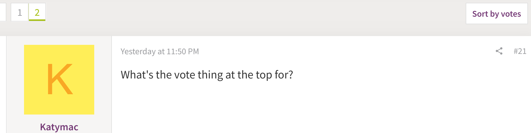

March 7, 20242 yr Moving the post disturbs the flow of the conversation, I'm sorry to say I dont like it Clearly it'll ignite flame wars if downvoters aren't anonymous, which I guess [mention=6303]Woosh[/mention] thought he was As the post went to the end of my feed You've probably got "Sort by votes" enabled. The raspberry one from Evans is only 2 kgs lighter but the weight is in a different place so I may go and test one of those I haven't read much about Specialized motors, they appear to make their own. Are they torque sensored? If so, as with the Fazuaaarrgghh! you might experience the same difficulty of torque from your legs not being sufficient to be recognised by the motor system? They have set the torque to the lowest setting and my legs still don't register I did wonder if there was a fault: If you're saying your bike jumped forward every second left pedal push, when every second left pedal push is applied with the same force at the first left pedal push, that sounds to me like it could be a fault of some sort... The Specialized motor looks kinda small too, might be another of those lightweight low assistance ebikes with small batteries for strong fit riders, similar to the Fauzuaaarrrgghh!? Best test one thoroughly on several hills methinks. Edited March 7, 20242 yr by guerney

March 7, 20242 yr I plead not guilty. TESTING, TESTING..... -1 Oh, this is fun! Such power! I wonder if I can vote twice to cancel that out?
