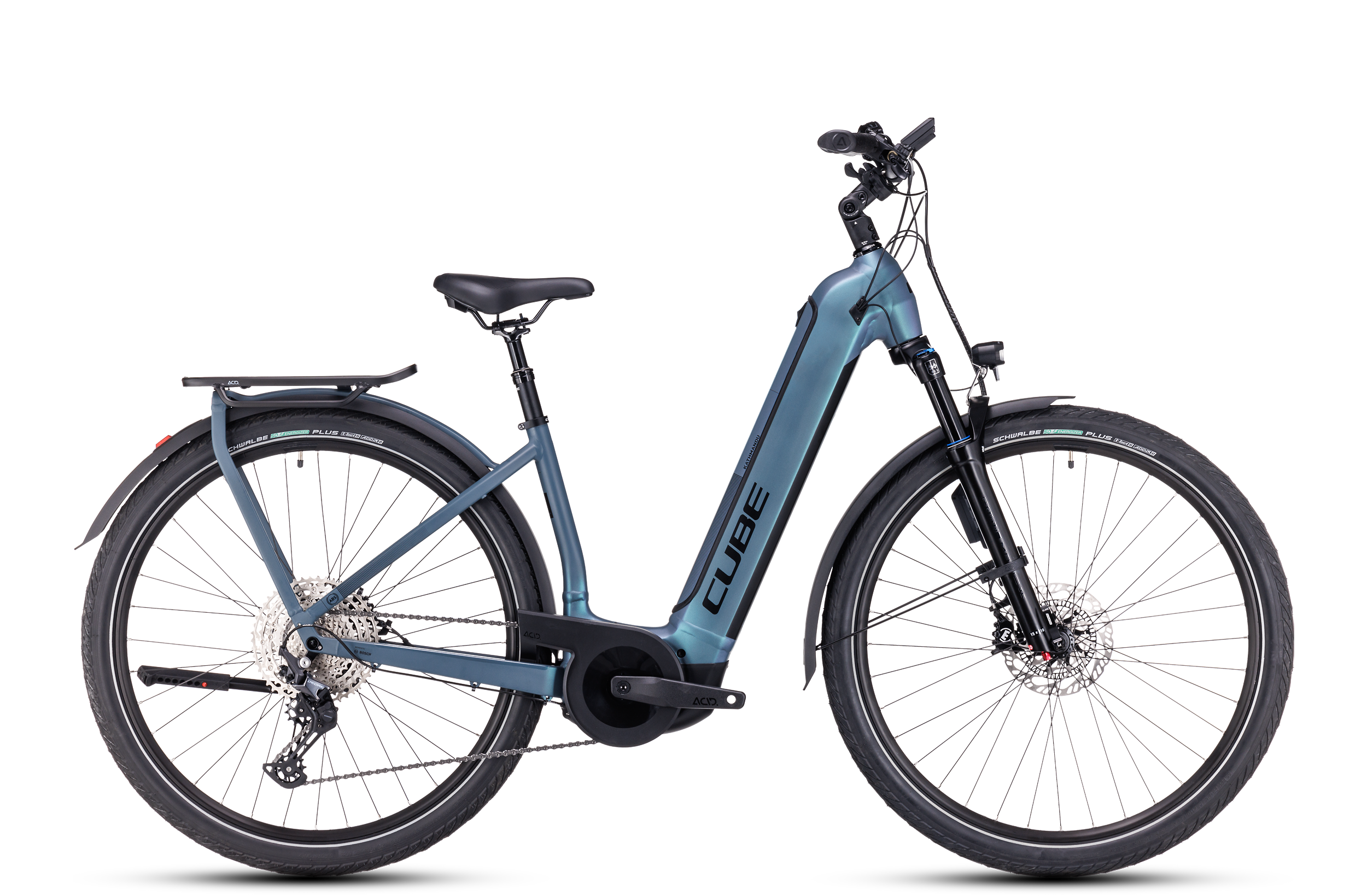

March 8, 20242 yr Cube Kathmandu 750wh, Bosch gen 4 performance CX 85nm motor. ABS braking. About £3k Motor will kick in pretty much on a smidgen of a turn on the pedals. It's not really dependent on anything other than making the pedals go round. Starting off on my Bosch(same motor) with the pedal at about 10 o clock, the motor will kick in by the time the pedal gets to 8 o clock(or maybee 9), it's pretty much instant. 750wh will probably give you 90 miles on eco, or 45-50 on turbo, turbo is 340% so plenty of oomf Edited March 8, 20242 yr by AndyBike

March 8, 20242 yr Cube Kathmandu 750wh, Bosch gen 4 performance CX 85nm motor. ABS braking. About £3k Motor will kick in pretty much on a smidgen of a turn on the pedals. It's not really dependent on anything other than making the pedals go round. Starting off on my Bosch(same motor) with the pedal at about 10 o clock, the motor will kick in by the time the pedal gets to 8 o clock, so pretty much instant. 750wh will probably give you 90 miles on eco, or 45-50 on turbo, turbo is 340% so plenty of oomf [ATTACH=full]56790[/ATTACH]

March 8, 20242 yr Cube Kathmandu 750wh, Bosch gen 4 performance CX 85nm motor. ABS braking. About £3k Motor will kick in pretty much on a smidgen of a turn on the pedals. It's not really dependent on anything other than making the pedals go round. Starting off on my Bosch(same motor) with the pedal at about 10 o clock, the motor will kick in by the time the pedal gets to 8 o clock(or maybee 9), it's pretty much instant. 750wh will probably give you 90 miles on eco, or 45-50 on turbo, turbo is 340% so plenty of oomf [ATTACH type=full" alt="731332_F1_00.png]56790[/ATTACH] It uses a torque multiplying system. We already determined that that system wouldn't be suitable.

March 8, 20242 yr [ATTACH=full]56791[/ATTACH] Yes, but he said he wanted something with power, and simply quoting battery size isnt going to giver you that. You could have a 20ah battery, but if the nm of the motor is only 35nm, then getting up a steep hill isnt happening. Plus the one i quoted is 85nm which is pretty powerful,and about 21ah, with front mount battery and mid drive centralizes all the weight. Rather than putting it all over the back.

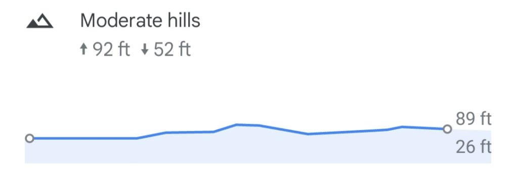

March 8, 20242 yr Author These are my hills home from just about anywhere They don't look steep but they are
