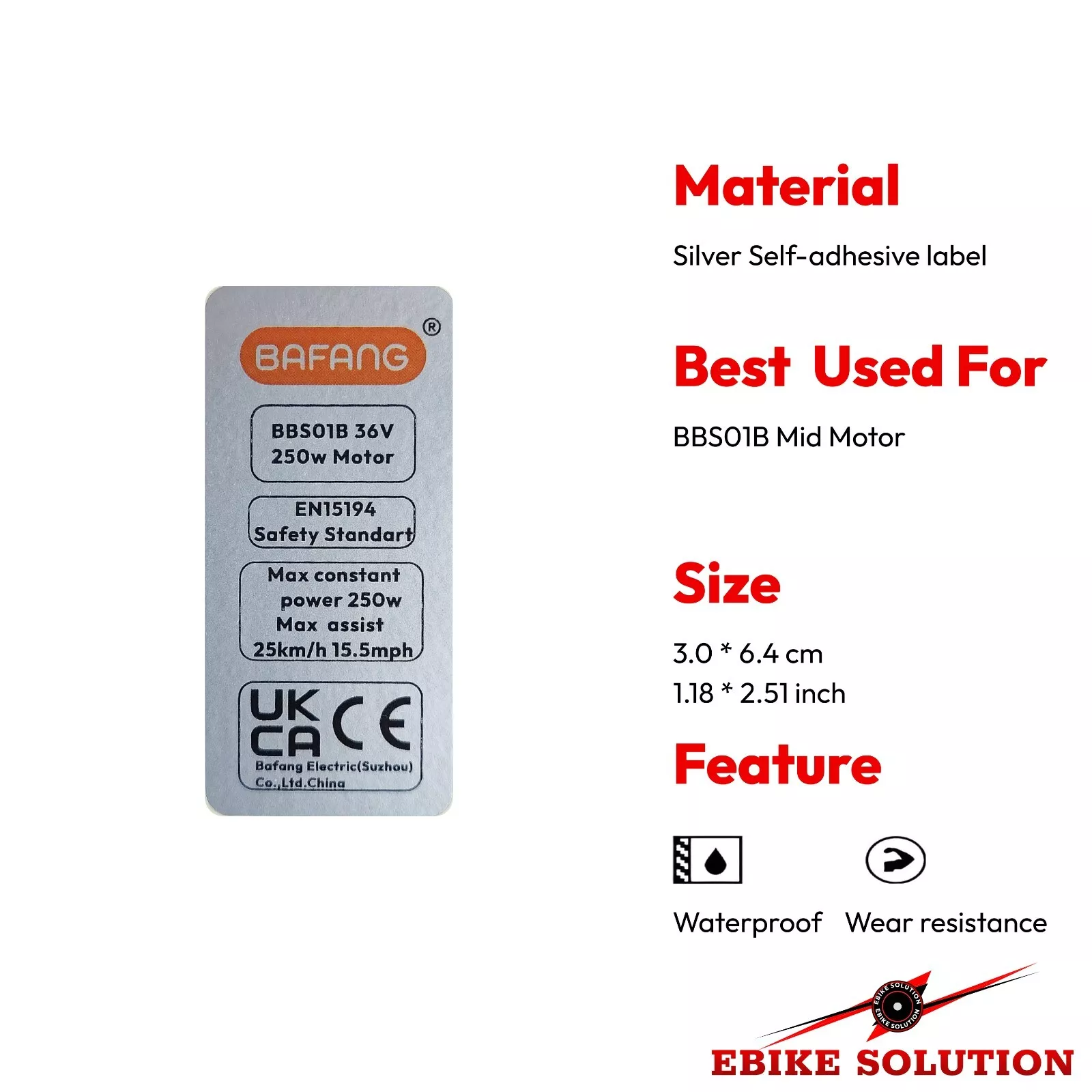

Applying Stickers to Hub Motor
I got some of these from ebay a while back. They seem to stay on and have done some miles both on a hub motor and on the frame of a converted Specialised bike with a crank motor.
I recognise there is an element of fraud in sticking an ebay label on your bike, but in my case I know for absolute certain that the bikes I own absolutely meet the spirit of the law except in the new interest in labelling which some police forces are now displaying. It is my view that that regulation about labels applies to manufactured bikes and was not applicable to conversions.
As far as some enforcement we have seen it is not possible to have a long ago done conversion which in every way other than a label, meets the rules on power, maximum assisted speed and the necessity to pedal the bike.

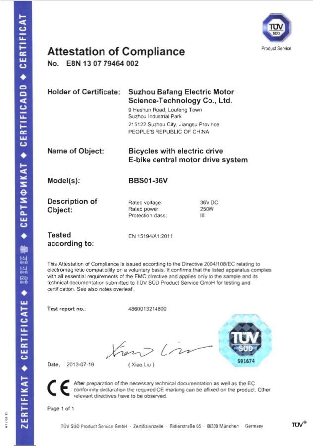

Spotted this Attestation of Compliance for the BBS01, even has the right EN number.
BafangBBS01BAttestationOfComplianceEN15194.thumb.jpg.df3b19a8151df7aca28102281ccb4c6d.jpg
https://static.webshopapp.com/shops/044915/files/083778110/coc36vmm.pdf
I was sent the attached PDFs by the seller of my kit, which might be of interest or use, to the elite and most excellent Bafangers among us in particular, the ones with awesome mid-drive motors vastly superior in every way, towering above the puny and pitiful chaff.
EMC Test Report
Attestation of Conformity Bafang BBS01B Part 1.pdf
Attestation of Conformity Bafang BBS01B Part 2.pdf

Even that rather professional looking attempt has the same spelling mistake!
Well spotted, but I suppose there are two mitigating factors: People probably expect that Chinese manufacturer paperwork is often in 'Chinglish' and the average copper on a wet day examining e-bikes in a town centre is unlikely to actually notice the spelling of the word 'standard'. To be fair, the labels like the rest of my bikes are likely to be spattered with muck, even though I don't ride them anything like as much as you ride yours.
Isn't the motor manufacturer supposed to feature on the label too?
*sigh* OK I made this label too:
Also corrected the EN number:
I have been experimenting with printing on glossy photo paper, results are not too shabby, just need to stick them on with some of that helicopter tape type stuff.
Alternatively, I have also ordered 3 of those stickers recommended by Cadence
I also made this for a bit of a laugh, I changed the Bafang details for MXUS details and corrected the spelling of 'Standard':
