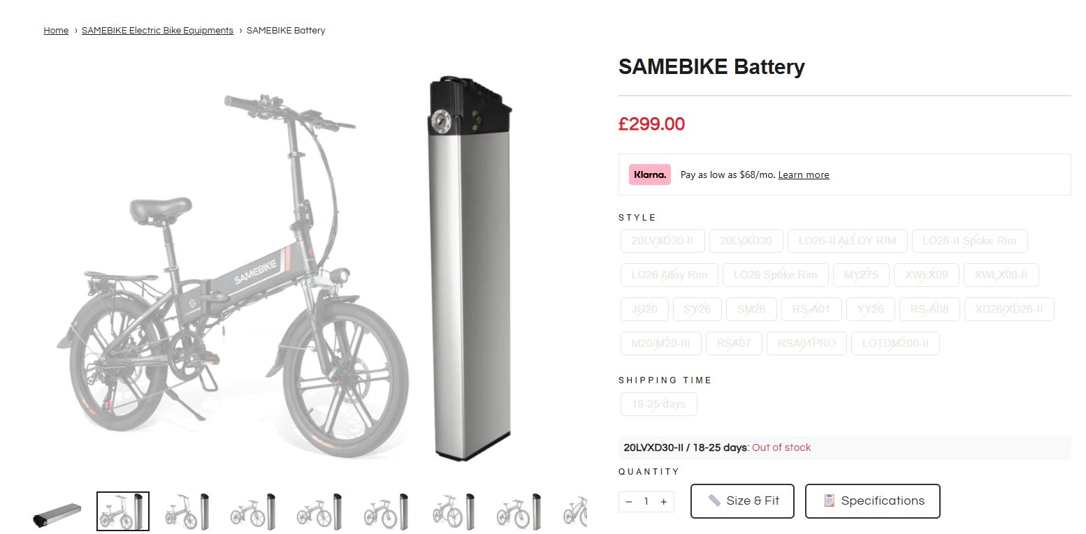

February 11Feb 11 If one clicks on Samebike's website and look for batteries they appear to have no batteries at all in stock for any of their models. If one clicks on Size & Fit or Specifications, they both say no information available. Bit of a red flag right there. I wouldn't buy any bike where I could not easily replace the battery (or any of the other electric components) myself with generic, off the shelf components five years down the line. If you know how to wield a soldering iron, you can buy any of the batteries like that that's the same size case, then swap the insides. There are loads of different ones. The difference is mainly the two plastic ends, so swap the ones from your previous battery.

February 11Feb 11 They dont on the black version, its so awkward buying from these sites because they do not keep info the same. Grrrrrrrrrrrrrrrrrrrrrrrrrrrrrrrrrrr Yes, what with that and the lack of spare batteries I wouldn't touch it with your barge pole.

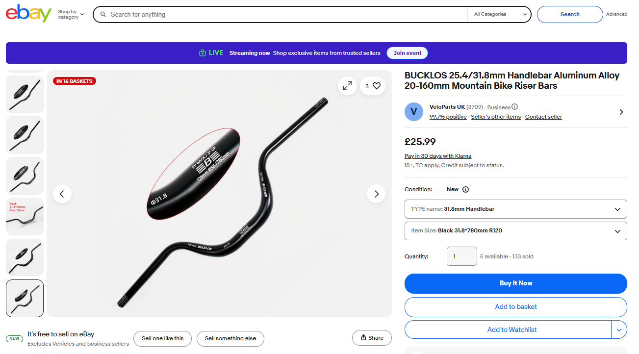

February 11Feb 11 https://www.amazon.co.uk/SAMEBIKE-Electric-Mountain-Absorber-Hydraulic/dp/B0C3VQH15D/ref=asc_df_B0C3VN832N?mcid=300ea7c9174e3256b4856a4ef1d64548&tag=googshopuk-21&linkCode=df0&hvadid=777413954550&hvpos=&hvnetw=g&hvrand=14499917547959242369&hvpone=&hvptwo=&hvqmt=&hvdev=c&hvdvcmdl=&hvlocint=&hvlocphy=1006879&hvtargid=pla-2247111781155&hvocijid=14499917547959242369-B0C3VN832N-&hvexpln=0&gad_source=1&th=1 That one looks pretty good - all standard parts. It has the waterproof sealed connectors and the integrated controller that make fault-finding very tricky, but at the first sign of any issues, I'd swap out the controller for a KT system and put it in one of those controller boxes. That would give you a much better control system. The only thing I'd change immediately would be to upgrade the brakes to hydraulics at a cost of about £35. These bikes are generally medium size and are best suited to someone around 5 ft 7". I'm 5 ft 10" and don't notice anything. You can always get some riser bars and put the seat up if you're taller. It's quite rare for these type of bikes to come in different sizes. Edited February 11Feb 11 by saneagle
February 11Feb 11 Yes, what with that and the lack of spare batteries I wouldn't touch it with your barge pole. It's a standard battery that you can get from anywhere.
February 11Feb 11 These bikes are generally medium size and are best suited to someone around 5 ft 7". I'm 5 ft 10" and don't notice anything. You can always get some riser bars and put the seat up if you're taller. It's quite rare for these type of bikes to come in different sizes. If I were 6' 6" and had that Samebike SY26 (very likely medium frame, like you say). I would buy a longer seat post (if needed). Buy hydraulic brakes (Shimano MT200 for me) with long hoses. Dump the front derailleur, shifter and cable (not needed on an electric bike, alternatively buy a longer cable), buy a longer rear derailleur cable and a set of BMX handlebars. Sam Pilgrim fitted some BMX bars to a mountain bike and loved it. Check out the video at 5:15 he does a backflip! Edited February 11Feb 11 by Waspy
