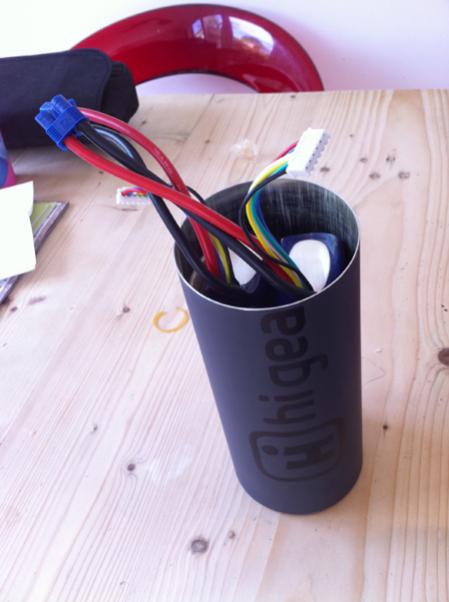

http://www.camelbak.com/Sports-Recreation/Bottles/~/media/CamelBak/Sports%20Recreation/Bottles/Images/Better%20Bottle%2075L/White/75bottle_black-300.ashx?mh=575&mw=441
Then as mentioned before a custom install into a SS water bottle or this kind of thing above made of Tritan super stong poly plastics type stuff.

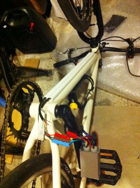

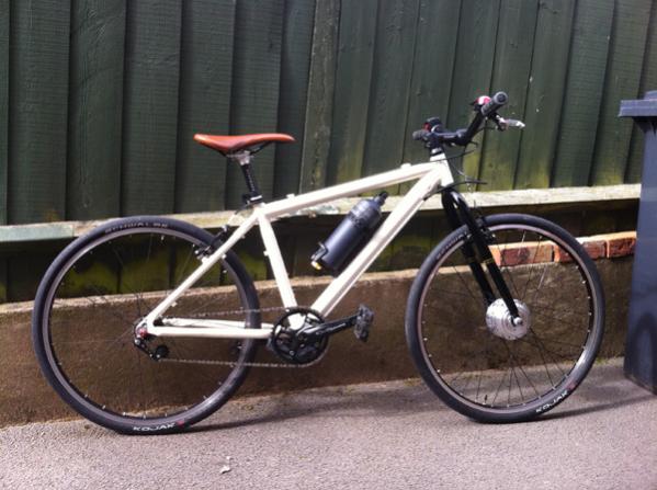

I've started building up the bike cobbled together from another bike and some bits, not finished yet the forks will go and some brakes to go on. I've ordered the Tongxin and controller, batteries and charger.
http://www.dhdesign-uk.com/bikes/IMG_0826.jpg
