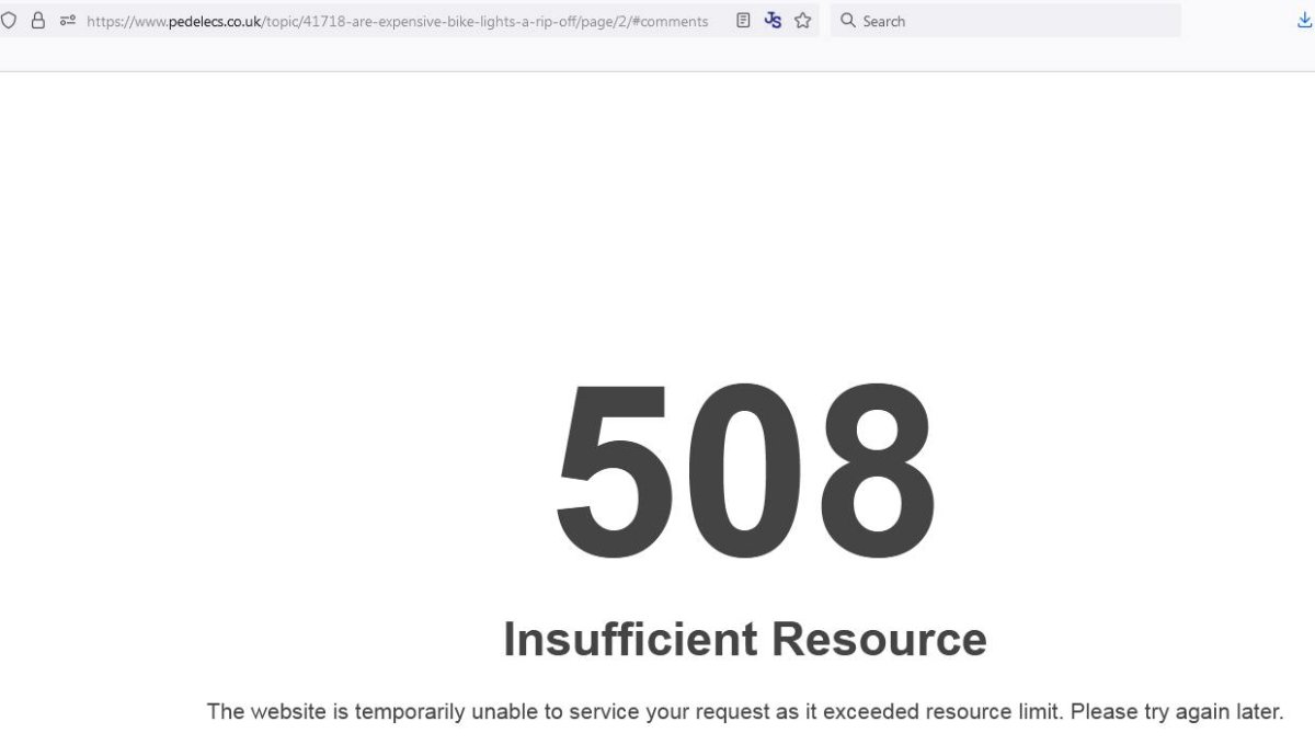

  9. I'm often seeing this 508 error when trying to view threads at the mo. Also "Choose files" uploader doesn't always load, requires browser refreshes to eventually appear. Pedelecs.co.uk needs more compute resources allocated during busy times?

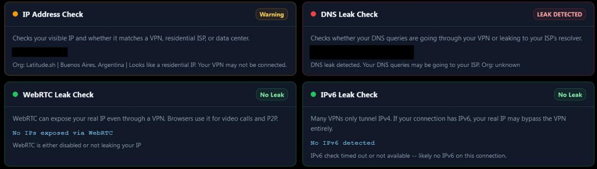

  11. AAAAARRRGGGHH!!!! Contrary to the article, ProtonVPN DOES leak DNS!!! And I use a paid tier! I'm enraged! Will try some other VPN next. https://tools.examineip.com/vpn-leak-test/

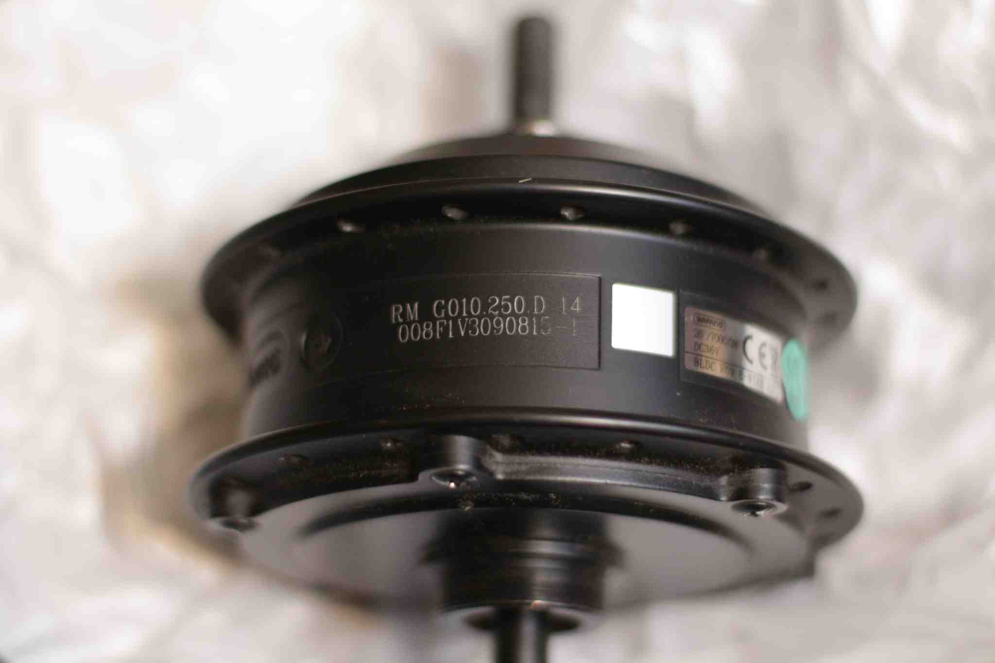

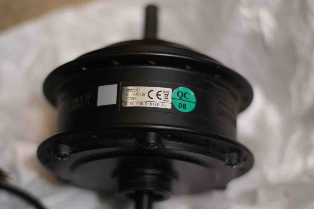

  15. Bafang rear hub motors engraved 250W are out there somewhere - I bought this G010 with a damaged cable for a tenner on ebay, ready for the day when I can eke out time to assemble a sensorless conversion. Too many other priorities at the mo. Trouble is, when the Suez canal gets blocked and/or is destroyed, prices of absolutely everything will increase to the stratosphere and beyond for years and years, so I might have to order soon while it's still cheap, in order for the controller display etc. to arrive and lurk in boxes till I'm ready.
