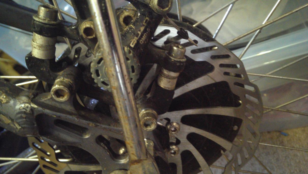

January 3, 201412 yr Executive summary: You only need to add about 10mm of spacers and a longer machine screw to go from a 140mm rotor to a 180mm. You need a 180mm or bigger to be sure that the caliper will be clear of the motor. Your disc-mount on the frame is side-mount. The BMS battery caliper is also side-mount, so you need a 140 to 180mm side-mount to side-mount adapter.They're not as common as side-mount to post-mount adapters and they're more expensive, so its better to get a brake with a post-mount. I did a similar thing to my bike the other day. LBS had the adapter in stock (from 140 to 180) for £12. When I went to pick it up, it was the same bracket as the 140mm, but with four 5mm spacers added (two each end). On closer inspection the spacers were those cupped washers that you get on V brakes: Google Image Result for I declined to hand over my hard earned as I already had these (and longer 6mm bolts) lying around. [ATTACH]7608.vB[/ATTACH] Edited January 3, 201412 yr by Alan Quay

January 3, 201412 yr Executive summary: You only need to add about 10mm of spacers and a longer machine screw to go from a 140mm rotor to a 180mm. Not when you have a side-mount on your frame and a side-mount caliper. All that will do is offset your caliper sideways by 20mm.
January 3, 201412 yr Not when you have a side-mount on your frame and a side-mount caliper. All that will do is offset your caliper sideways by 20mm. Hmm, a fair point. Worst thing is, I have one of those calipers from BMS unfitted, and sitting on my bench and I'd not noticed is was side mount. (Slackens jaw, slaps head, gets coat)
January 3, 201412 yr Join the club. I've got two of them. this ad shows what you need, but they're always expensive. ASHIMA Disc Brake Adapter - IS Mount Caliper to Post Mount Fork (IS-PM) | eBay
January 3, 201412 yr Author I just want something simple and easy to replace. I tend to break things on my bikes lol So new shopping list: Juicy rear brake: Avid elixir 3 rear disc brake | eBay 180mm adapter: Shimano Bicycle Bike Disc Brake Post Mount to Post Mount Front Adapter 180mm | eBay And bmsbattery 180mm disc brake I already have. Is it all good?
January 3, 201412 yr That's the wrong adapter.You need IS to post mount: is to post adapter 180mm | eBay
