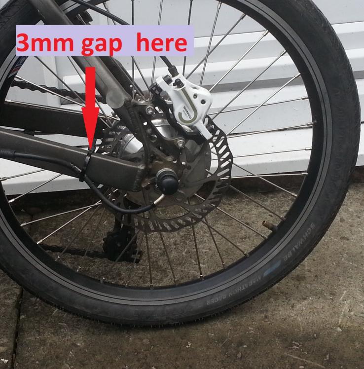

January 4, 201412 yr When it arrives, you can test it very easily and quickly without having to install everything. Lay the disc on the motor after removing the screws. Then put the caliper on the disk in approximately the right position to see if it touches the motor. If it does, you need to install the 180mm disk, so screw it on. When you put the wheel back, you'll need spacers(washers) on the axle to keep the disc at least 3mm clear of the chain-stay (frame) otherwise the caliper won't line up with the disc.

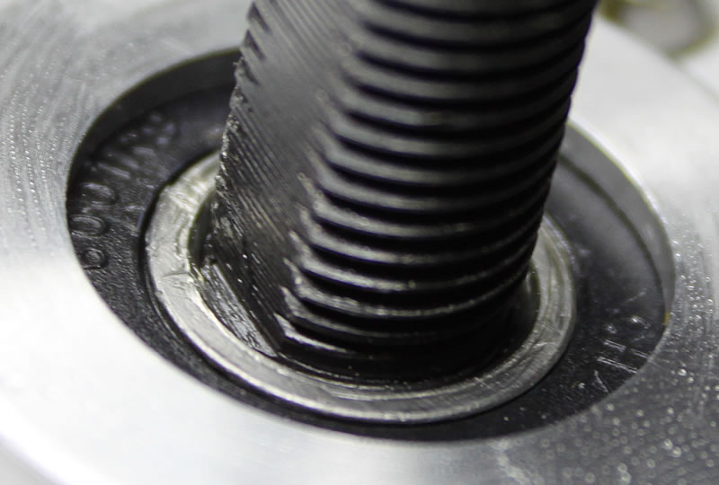

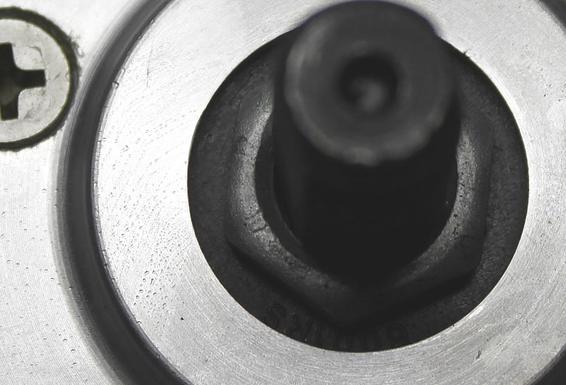

January 5, 201412 yr Getting back to the freewheel action binding, I have something similar on my new Q100 from BMS. I know it's a different motor, but it's similar to what Dave has said. This is a front wheel hub, so one side has the black spacer on the disc and cable entry side. The other side, shown the photos, is where it was binding slightly when spun, unpowered. Like yours, it only then carries on for a second or so, whereas with sealed bearings and no brakes rubbing you'd expect it to on for several seconds, like a conventional, properly adjusted wheel. Loosening the outer nut eases it, like yours. I remember Dave mentioning something like it before on a forum, where there was a superfluous rubber washer under the inner nut, between it and the inner bearing race, causing the washer to rub against the outer bearing race. These two photos show something similar, but I think the problem is a bit more difficult to rectify. One photo shows the wheel square on, with the inner nut obscuring what's inside of it. In the second photo, with it removed, you can see what appears to be a rubber seal on the bearing, (with lettering on it). You can see it's raised slightly above the thin metal collar of the inner bearing race, so it rubs against the inner nut when that's replaced. It seems to be packed with grease, and I'm reluctant to hook it out, because I suppose it would no longer be water resistant ? Maybe I should try a thin spacer washer, the same diameter as the inner bearing race ? [ATTACH]7620.vB[/ATTACH][ATTACH]7621.vB[/ATTACH]
