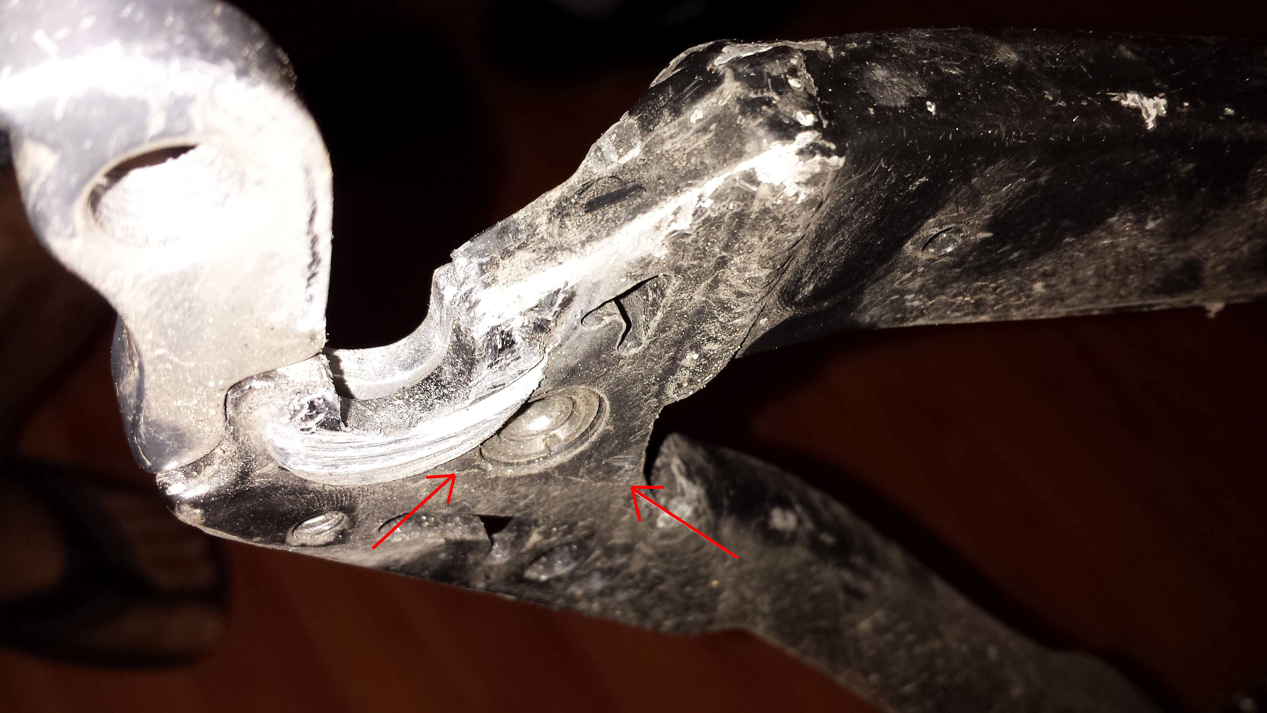

February 15, 201412 yr Author Sanity check.. Dropout looks ok, but the steel clip has been torn.. These are definitely not stainless steel clip
February 15, 201412 yr Sanity check.. Dropout looks ok, but the steel clip has been torn.. These are definitely not stainless steel clip Isn't that a crack, top right?
February 15, 201412 yr Fix it to the disc brake mount like this: http://i451.photobucket.com/albums/qq236/d8veh/Giant/torquearm-1_zps70cd2cd5.jpg
February 15, 201412 yr Just for safety's sake please check the area between the red lines, it may be a scratch but looks like a hairline crack. Don't want you injuring yourself

February 15, 201412 yr Author oh I see. It's not a crack, it's just mark https://www.youtube.com/watch?v=81tqJQLauaA I have my motor rubbing against something, I initially thought it was the disc brake but it isn't... It's not really freewheeling... but I can't see against what it may be rubbing... any idea?
