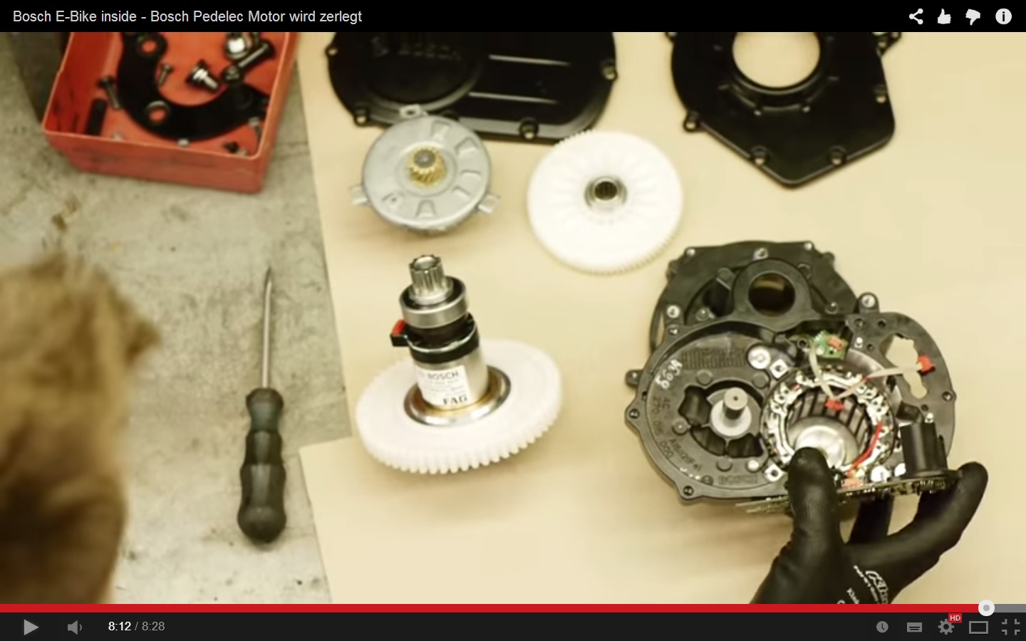

This is what's inside. The crank spindle is the bit in the middle with the white gear on it:

My understanding is the Bosch system uses an ISIS bottom bracket.
I wonder if the white cog on the bottom bracket in d8's pic will disassemble leaving a replaceable ISIS bottom bracket.
the red blob on the side of the BB in the picture below looks like a strain gauge for torque measuring. You can't access the interface between the spindle and the BB shell with standard Isis BB.
bosch-motor-jpg.9338
I've not had one of these apart, so this is just my personal observation... not a professional input. For that you'll have to wait until tomorrow.
The bottom bracket looks to use cartridge bearings so the whole unit, including sensors won't need replacing, it'll more than likely just need the bearings replacing.

Exactly what I was thinking, just two new cartridge bearings, I hope.
No, it's completely different. It looks like there's a ball-race on each end, which you should be able to remove and replace with one from a bearing supplier. They'll have numbers on them that identify them. Bosch don't make ball-races, so don't buy one through the Bosch chain: it'll only work out more expensive for the same thing.
