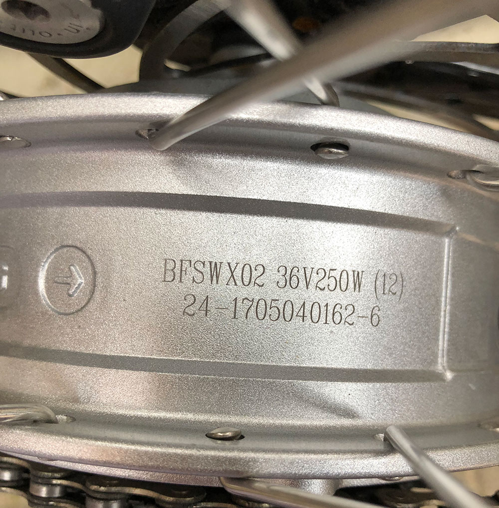

July 10, 20187 yr I got the BFSWX02 36v250w and would like to know if it possible to put in some more Amps in it? It´s 8 right now but if I raise it to 10 its 300 Watts and 12 It´s 420 Watts, but could it handle that? I want it to go faster and bee stronger .

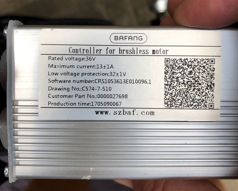

July 10, 20187 yr I got the BFSWX02 36v250w and would like to know if it possible to put in some more Amps in it? It´s 8 right now but if I raise it to 10 its 300 Watts and 12 It´s 420 Watts, but could it handle that? I want it to go faster and bee stronger . Show us a pic of your controller 8a might be it's rating but bet 15+/- 1a is it's max rating and will be outputting a possible 500w + already. 17 or 20a controller should pose little issue for a big Bafang.
July 10, 20187 yr Show us a pic of your controller 8a might be it's rating but bet 15+/- 1a is it's max rating and will be outputting a possible 500w + already. 17 or 20a controller should pose little issue for a big Bafang. Here is pictures of both controller and motor and cant find any data about them on the Internet! But as it street legal here in Sweden then i think the controller is set to 8 amp output! Another thing is that there are 5 cables from the Controller! Battery, 1 brake, Display, magnets,and motor. Edited July 10, 20187 yr by Killerbritt

July 10, 20187 yr The hub is legal as marked 250was as stated by EU legislation, there is no set legislation for controller amps so only can be set to 8a via lcd programming. Yours is 13a +/- 1a so it will give at least the 13a under certain conditions. Hub is marked 24 for 24" wheel. (12) is the hub winding speed which means AFAIK 250rpm no load speed with 210 load speed. Should be able to top out at 30/32kmh unrestricted in a 28" rim.

July 10, 20187 yr The hub is legal as marked 250was as stated by EU legislation, there is no set legislation for controller amps so only can be set to 8a via lcd programming. Yours is 13a +/- 1a so it will give at least the 13a under certain conditions. Hub is marked 24 for 24" wheel. (12) is the hub winding speed which means AFAIK 250rpm no load speed with 210 load speed. Should be able to top out at 30/32kmh unrestricted in a 28" rim. Ok, thanks for that. It´s a cargo bike with 3 wheels thats why it´s a 24. I did the opposite and went into the Display sub menu and program it for a 18 wheel and got 4-5 kmh in extra speed, but the bad thing is that the speedometer don't show the right speed. I have the C961 Display and thinking if I can use the BBS02 and BBSHD programing tool to change some settings in the controller! But i don't know if i burn the controller when i connect it! I also upgraded the battery to a LG lithium battery 36V17Ah with cellphone charging USB 3A Charger Bracket. So basically i´m looking for a way to get into the controller and change the settings . Edited July 10, 20187 yr by Killerbritt
July 10, 20187 yr I doubt that the controller is programmed for less then 13a, if the bike feels like it is wanting in power then is likely the extra weight and geometry is wrong. Most aluminium case programmable controllers have a white date cable/plug for programming, it is possible but I doubt bbs prog software is the same as hub controller software, maybe you will have to be the guinea pig to try . I doubt you will damage the controller , software most likely will not recognise the controller. Edited July 10, 20187 yr by Nealh

July 10, 20187 yr The only way to get rid of the 25km/h setting is to get a complete KT 17a controller and lcd 3 kit, inc a pas, throttle,brakes,speed sensor etc,etc. Using PSWPower shop on Aliexpress cost is about $105 delivered. https://www.aliexpress.com/store/product/36V-48V-350W-Brushless-DC-Sine-Wave-Controller-LCD-or-LED-Throttle-Brake-Lever-PAS-Speed/1314442_32623312368.html?spm=2114.12010612.8148356.50.5e8711bazYMewE Your 250w hub will work nicely with 17a controller kit.
