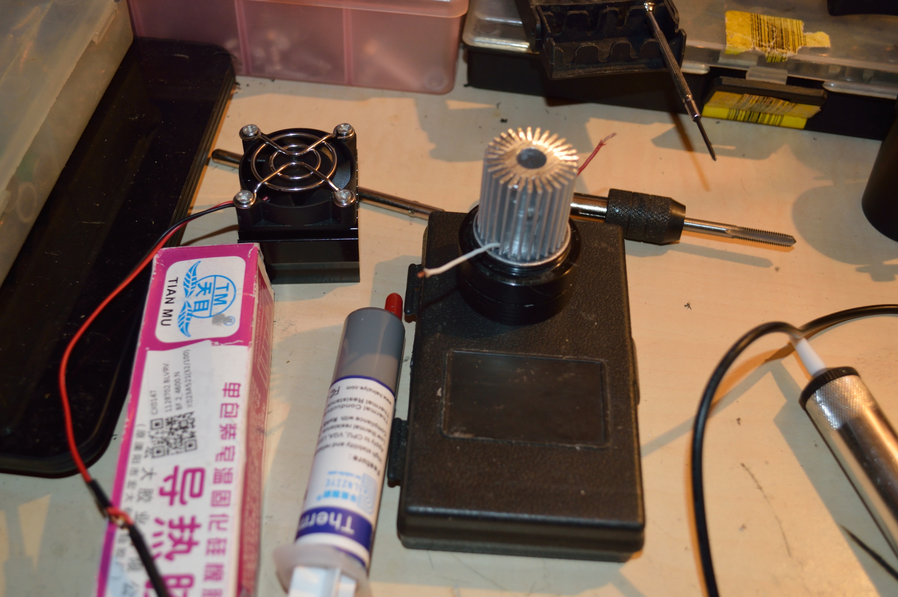

It's Aluminium so file it, put some heat sink compound between the two and away to go.
The only problem I see is clamping the LED star to the heat sink, unless you can drill the star and self tap it to the heat sink

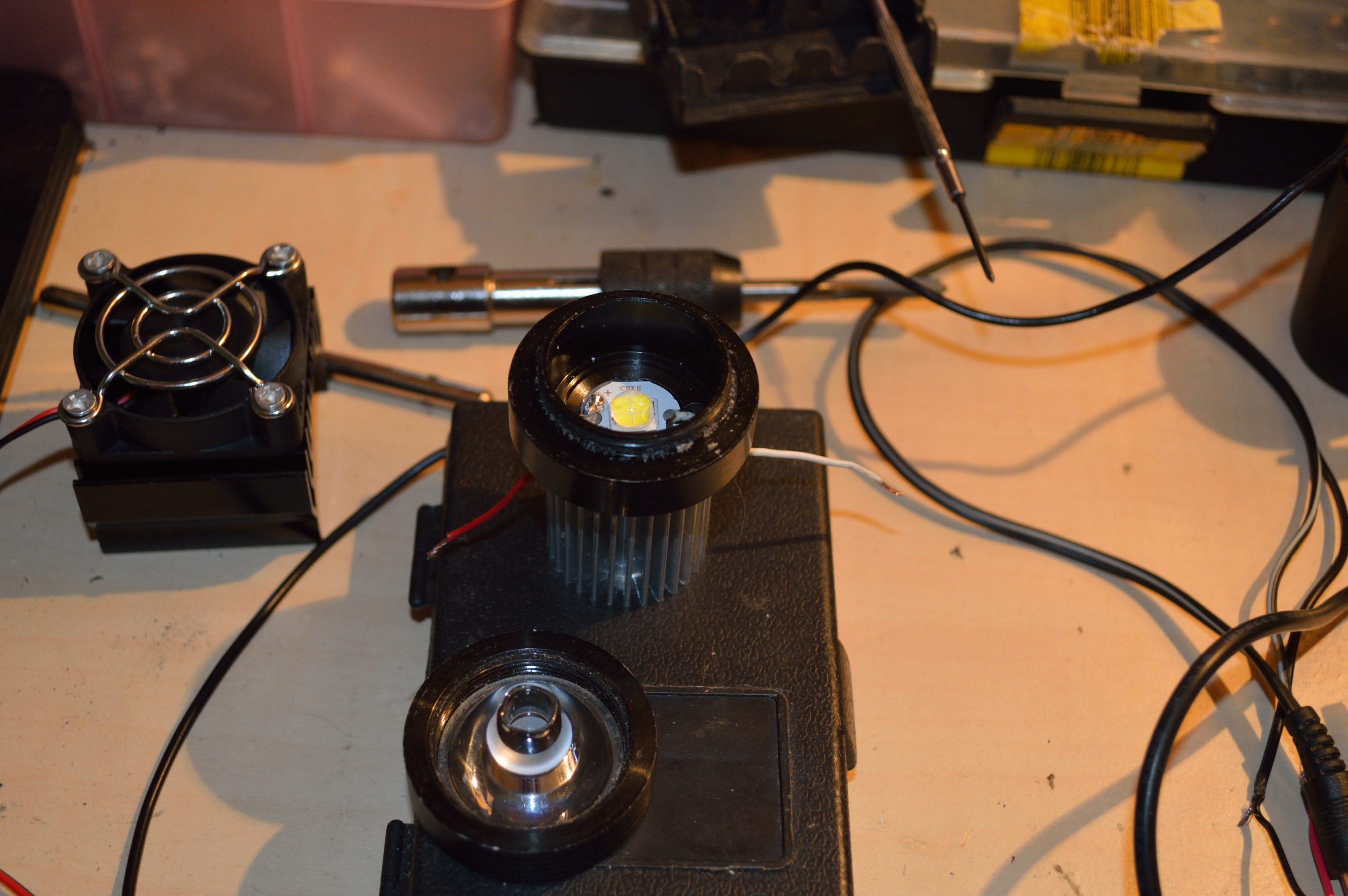

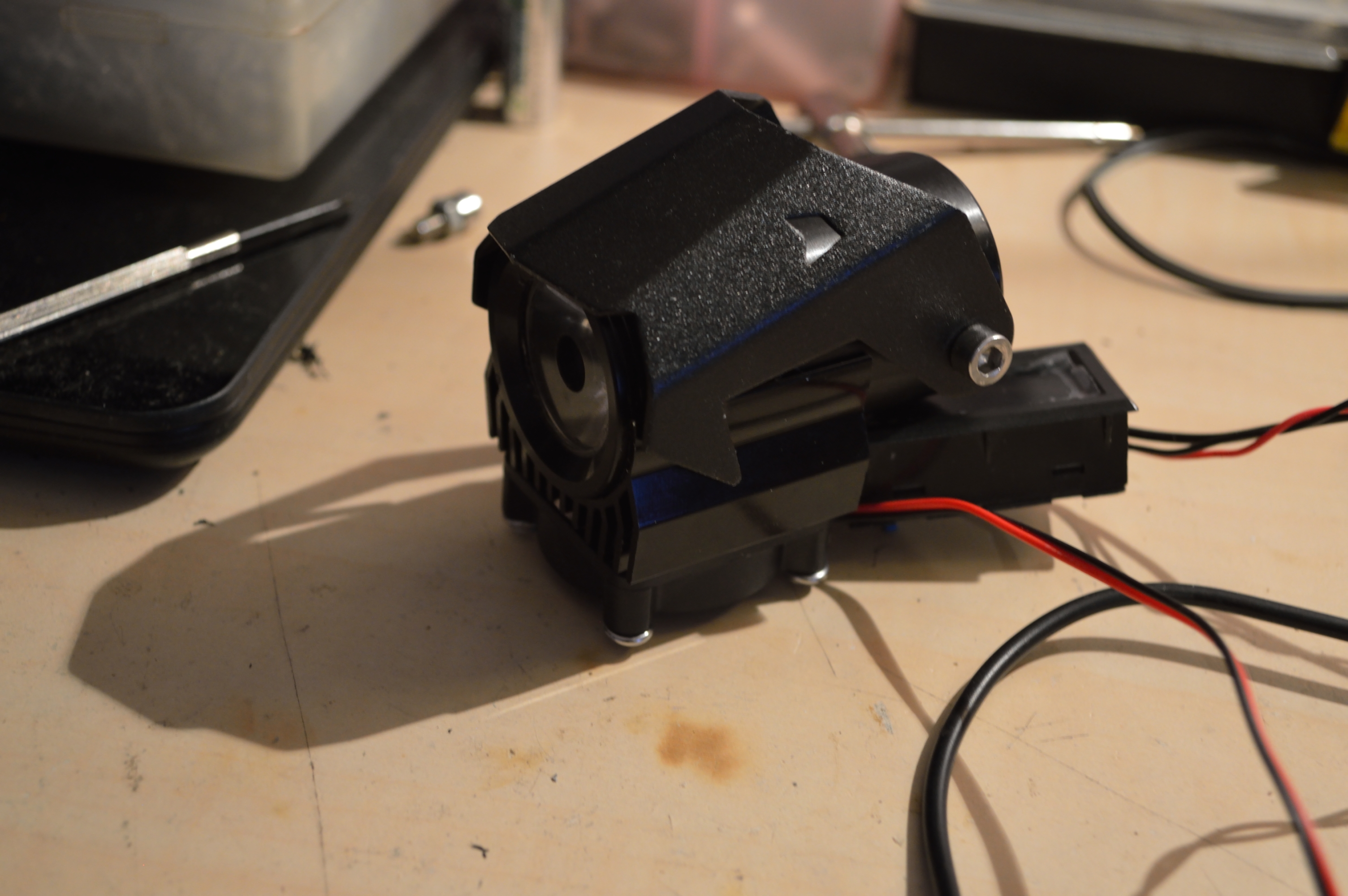

the 16mm led fits in to the black part then the lens on top of that so will just use some cpu heat sink paste and use the lens to hold it in place, i have some of that white heat sink glue to then attach the alu heat sink to the back of it so then all slides in the rear of the case and will drill some holes in it for the 4 bolts.

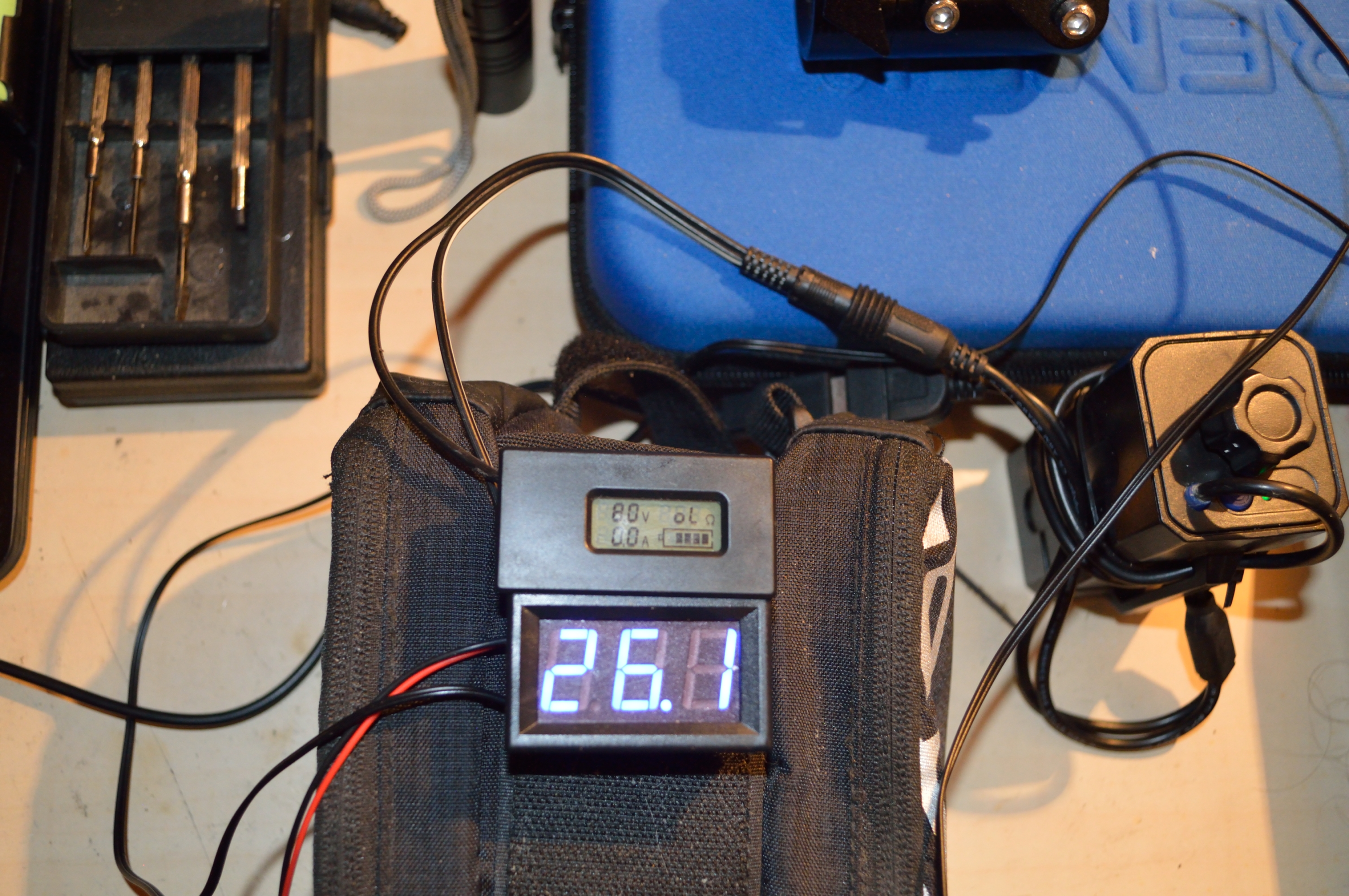

DSC_0658.thumb.JPG.4817343adb4e55fe4ea6fa05cb25a632.JPG DSC_0659.thumb.JPG.98eac27725b9a7b3261208ce548bfaaf.JPG

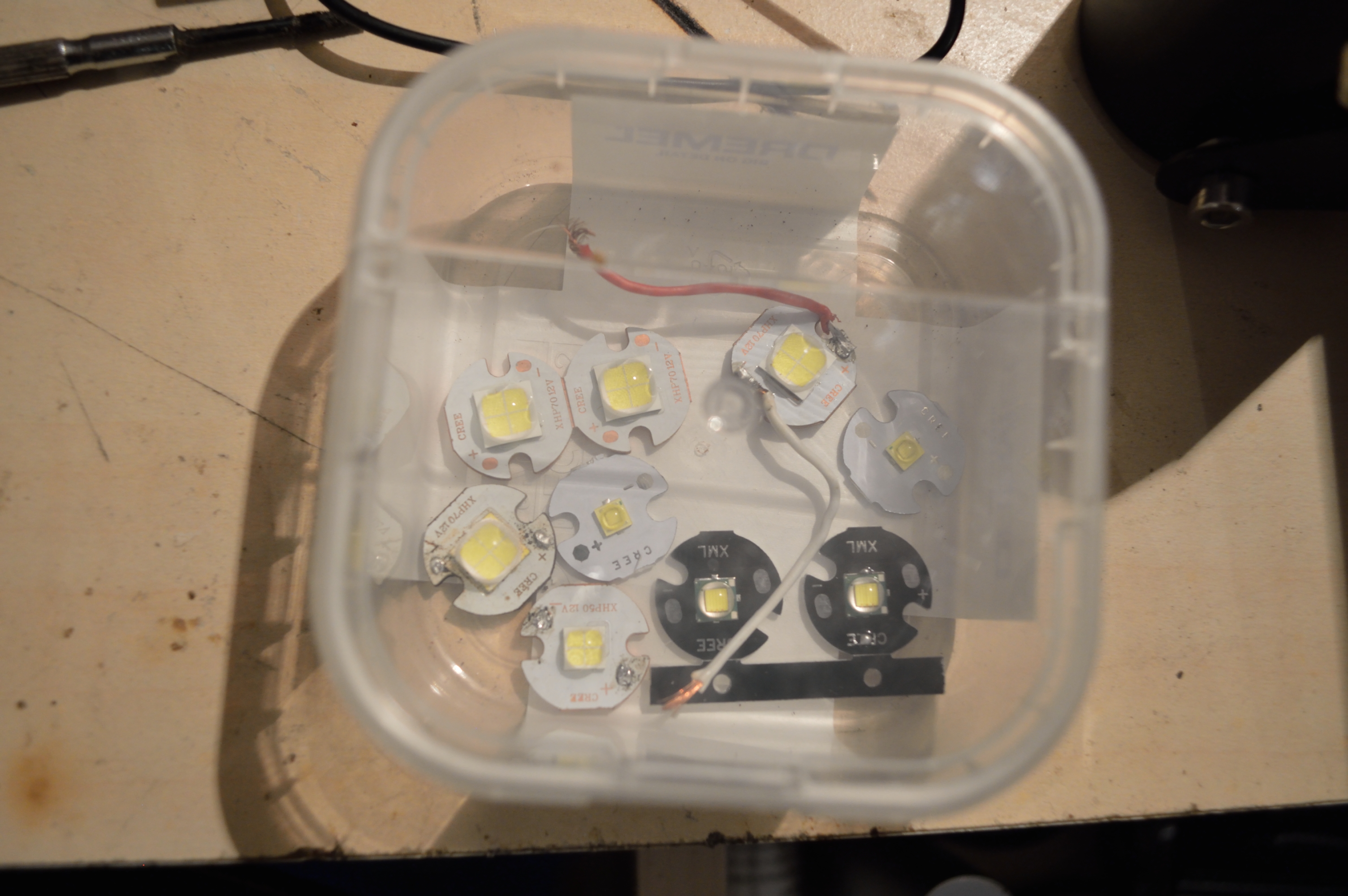

thats what happens if you put 1 cell in it the wrong way round lol.
just waiting for the heat sinks now.

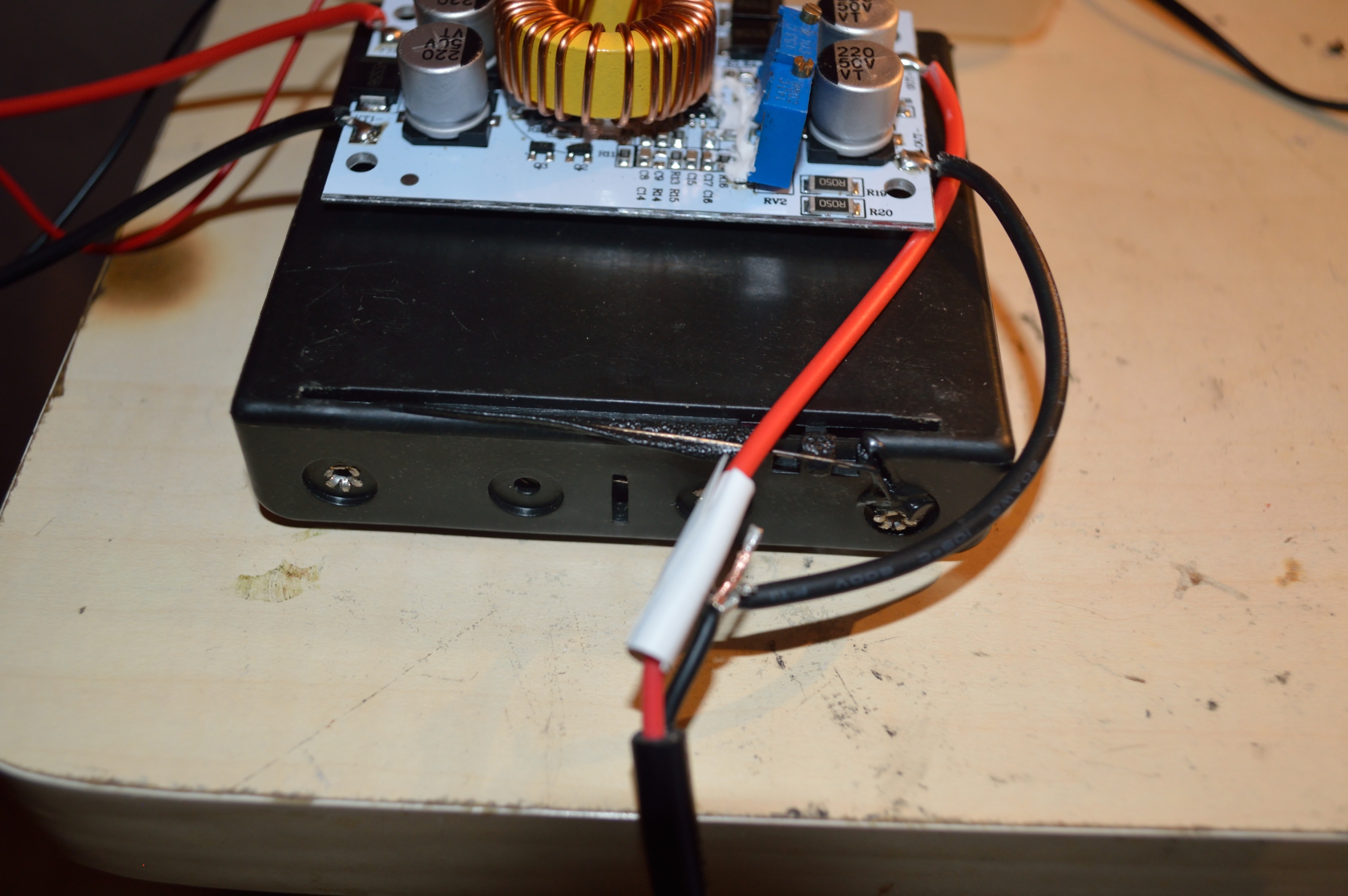

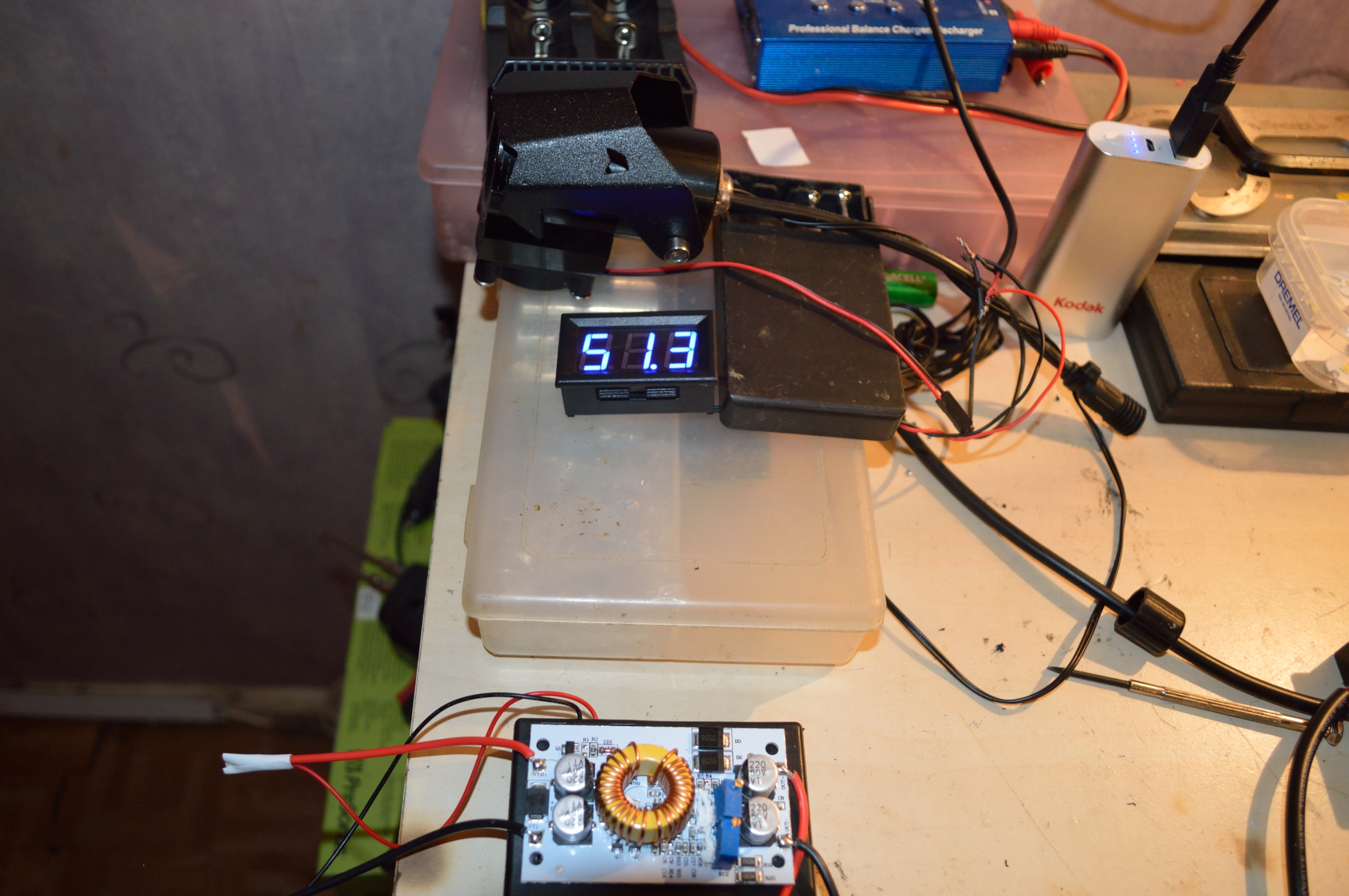

and a boost converter for the 4 cell pack.
http://i.ebayimg.com/images/g/id4AAOSwnHZYb2Vs/s-l1600.jpg

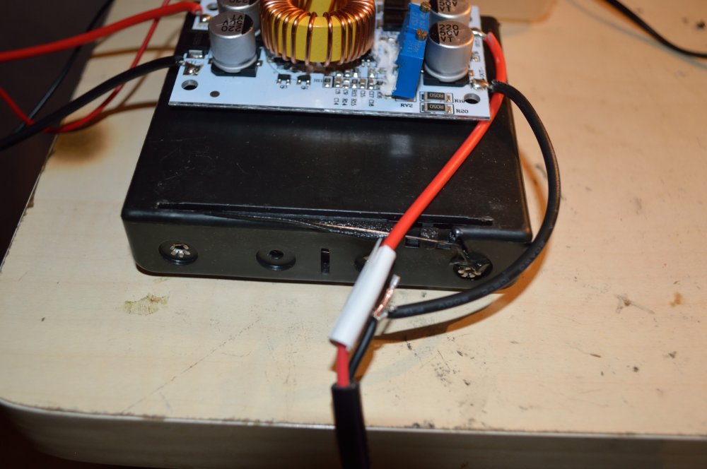

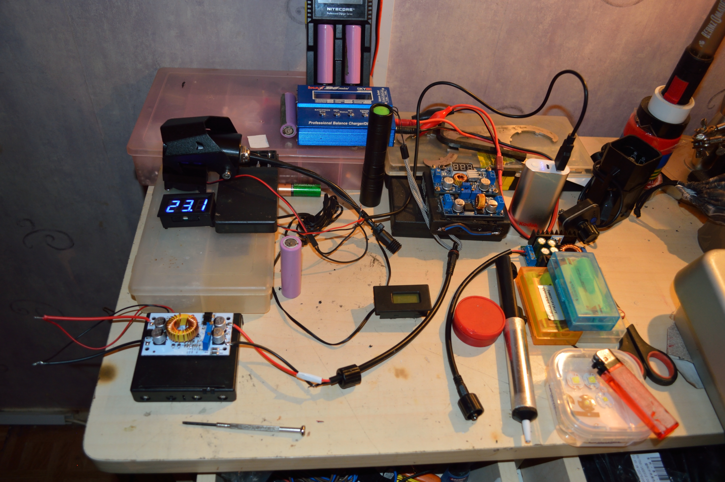

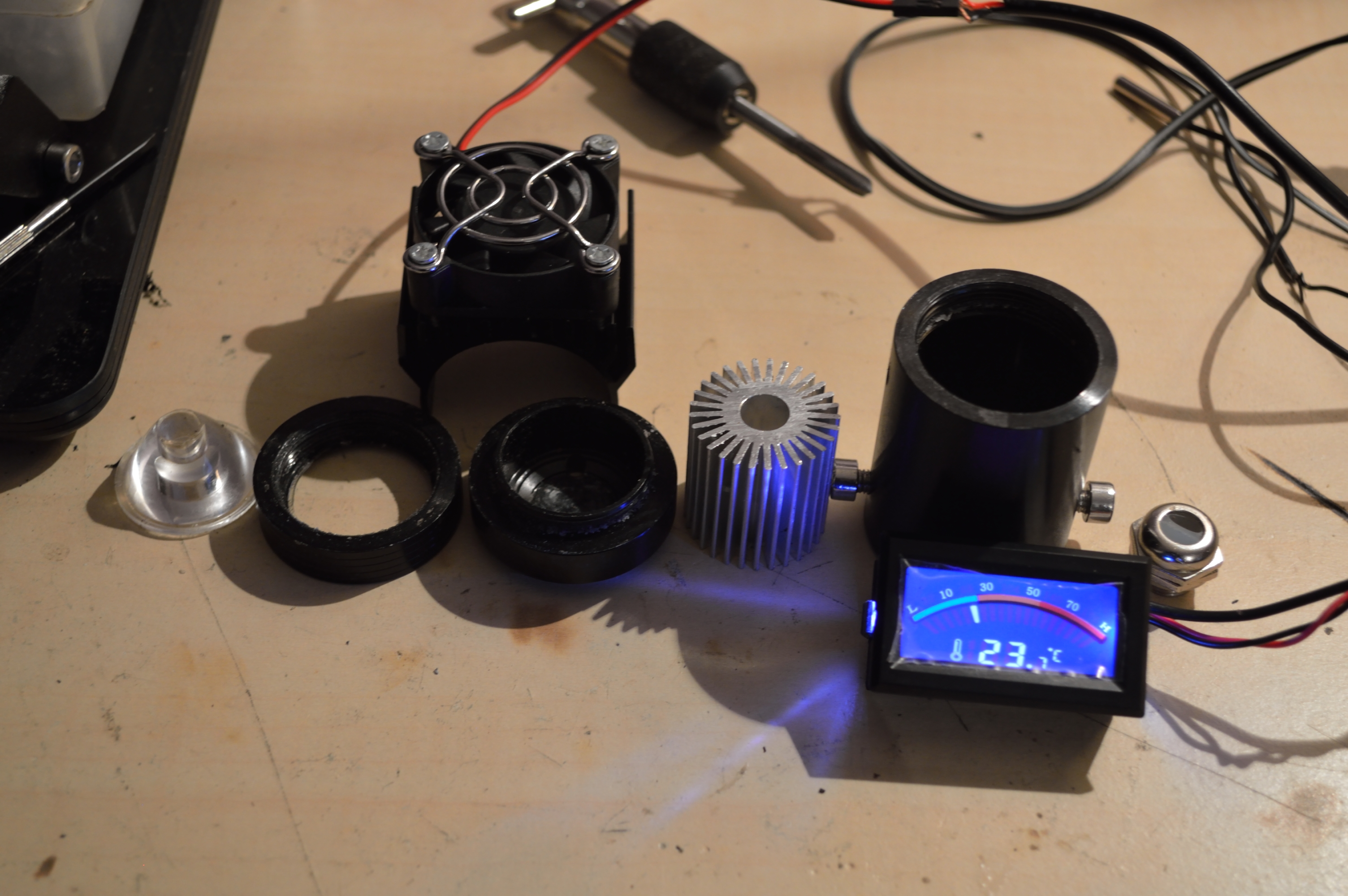

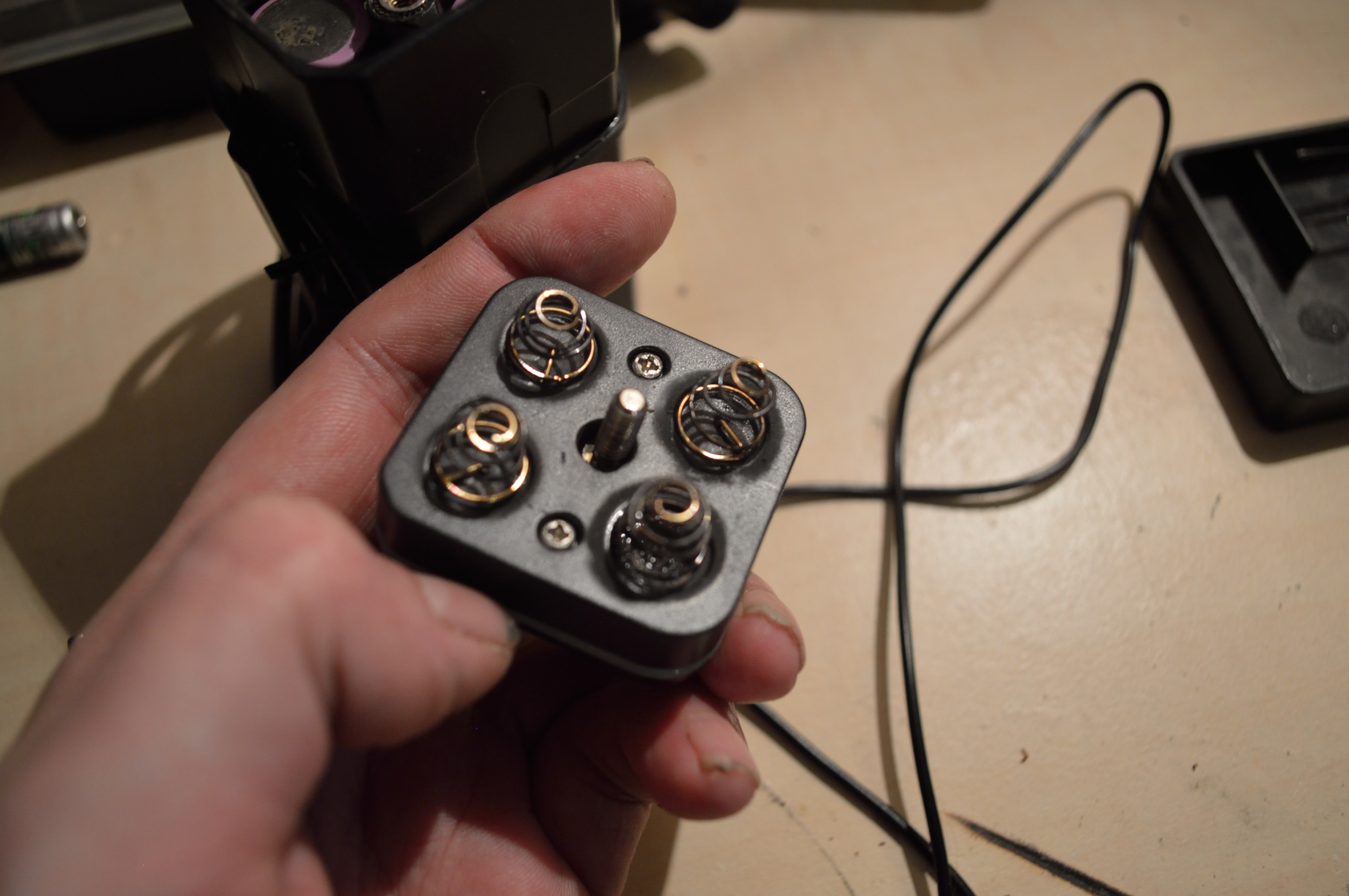

finally got my boost converter only to find that 4 cell box cuts out as soon as i up the currant it gets to about 13v at 700ma and clicks and cuts off so back to square 1 and back to the 18650 cell holder.

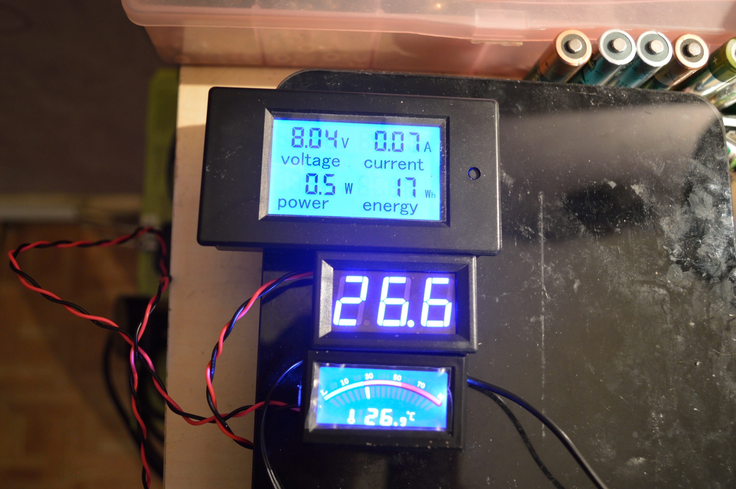

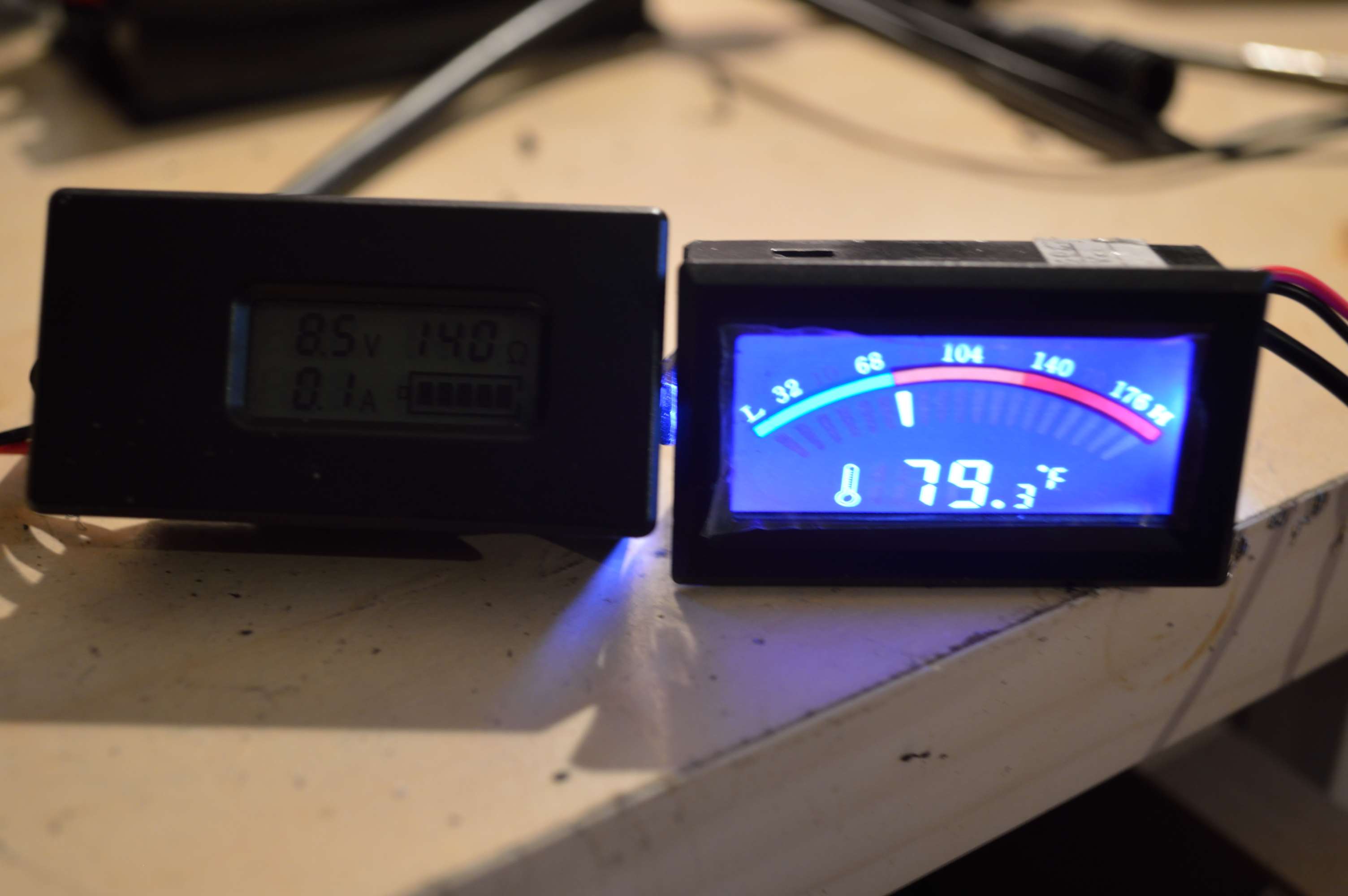

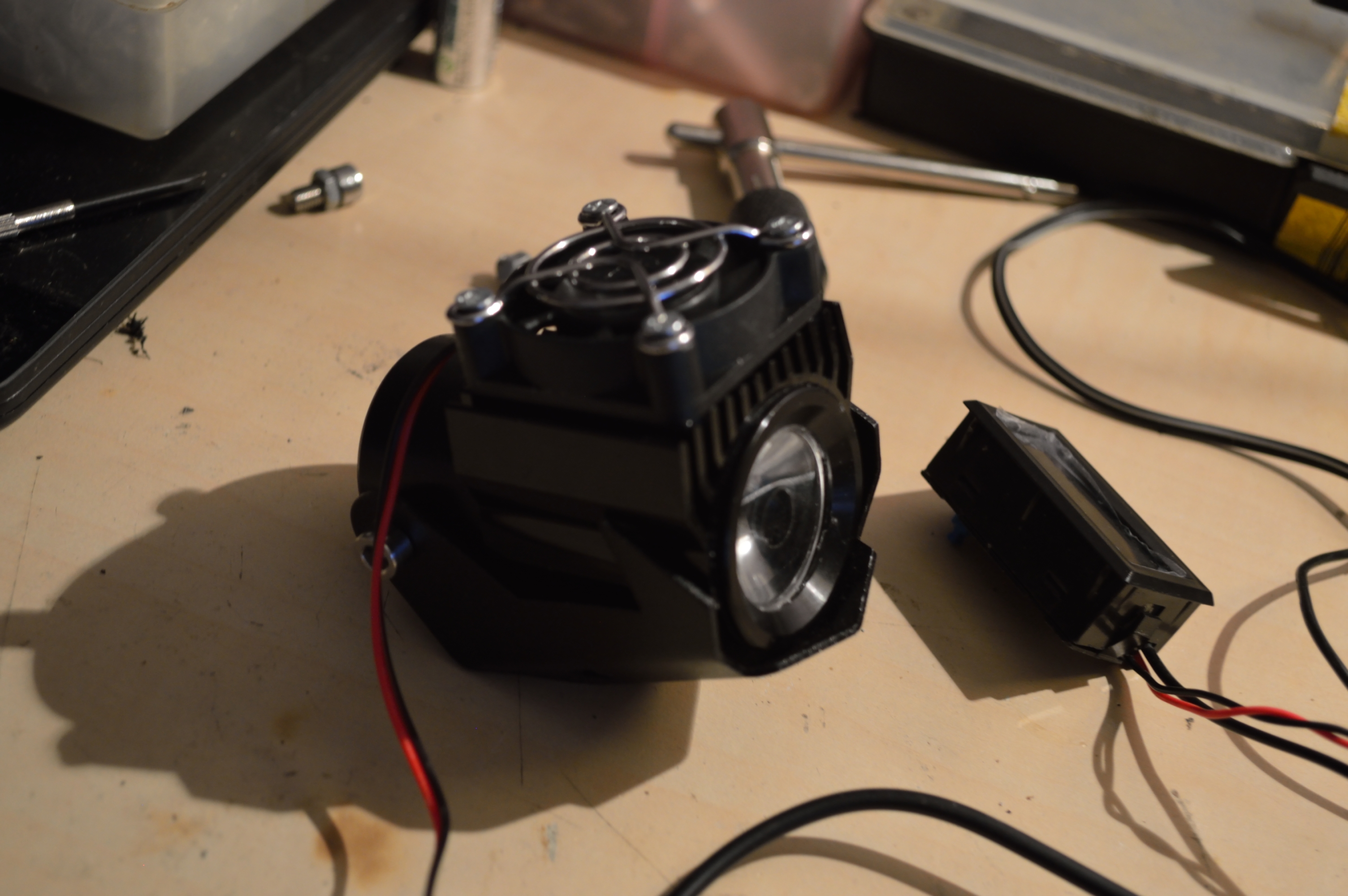

room temp of the case with the fan going cuts it buy 3c so is helping tho limited to a 6v fan.DSC_0691.thumb.JPG.d1c20af8c3ca51dc96a026537749a432.JPG

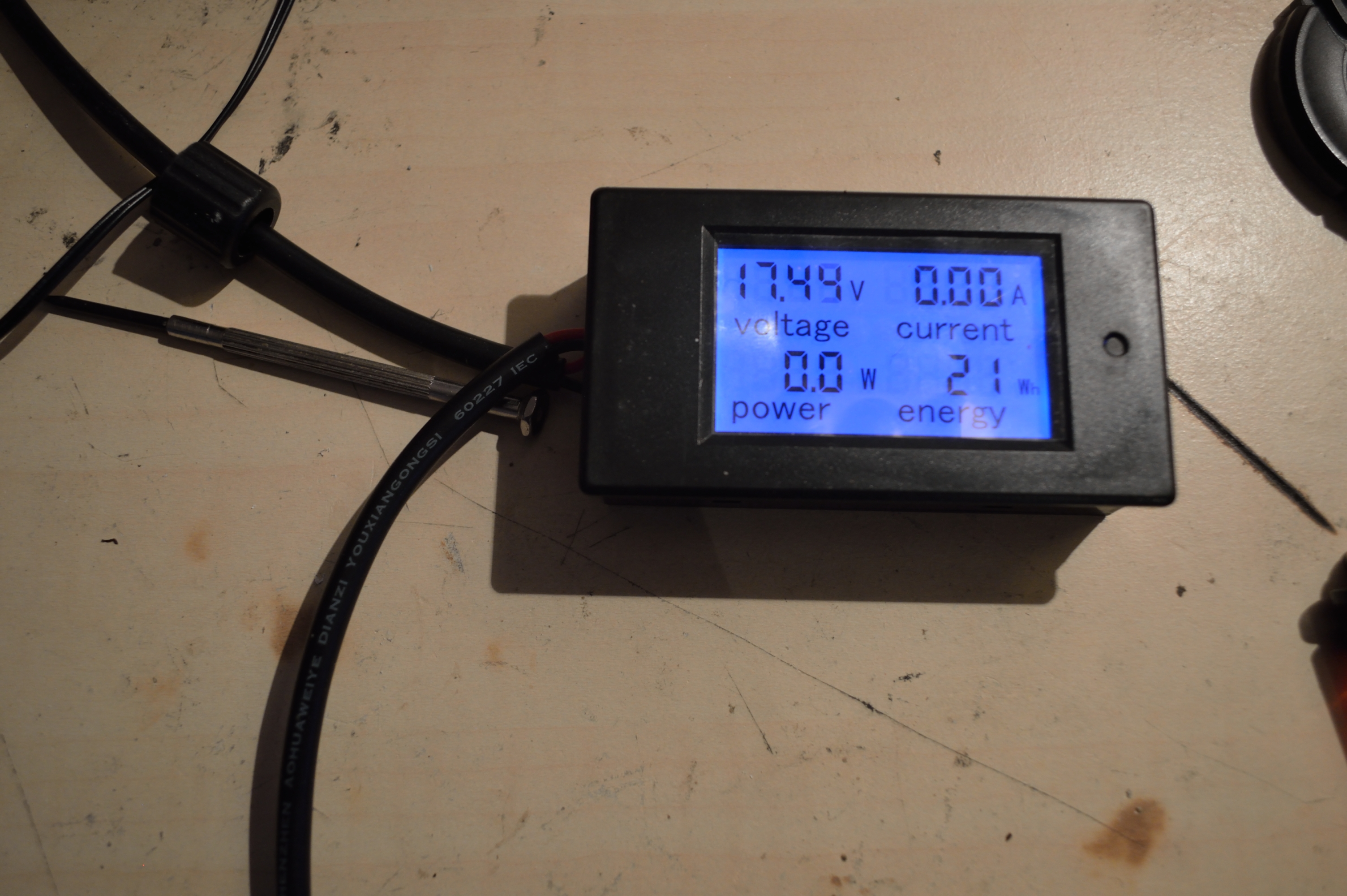

i got it to 3a 17v and a stable temp that is 36w from 1 led at 65c 32w is 4022lm and the 18650 holder started to melt pmsl.
