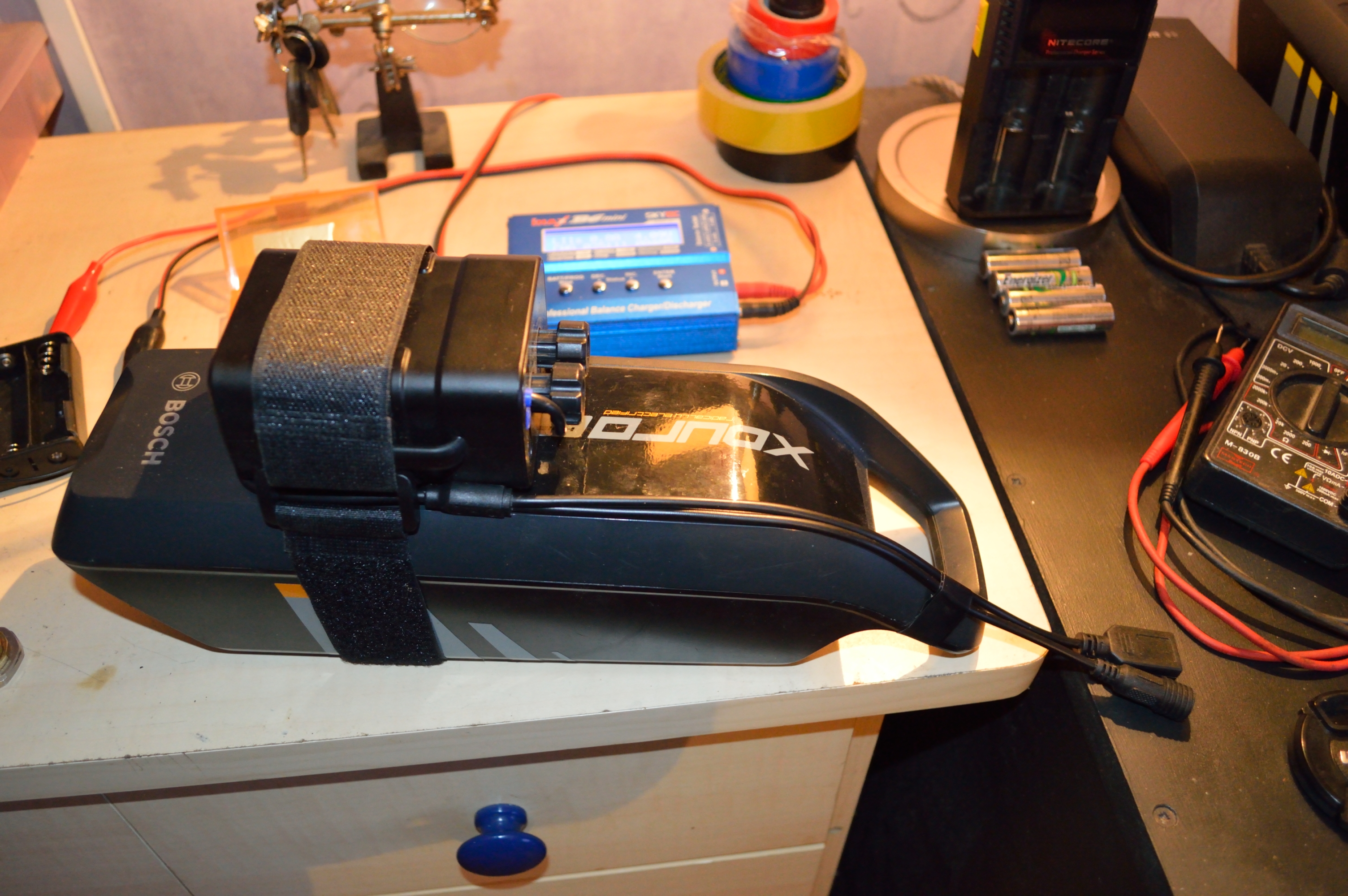

January 8, 20188 yr had to glue some small rubber feet on it as still moved a bit but solid as a rock now. and some 3m sticky label like plastic Velcro for the usb.
