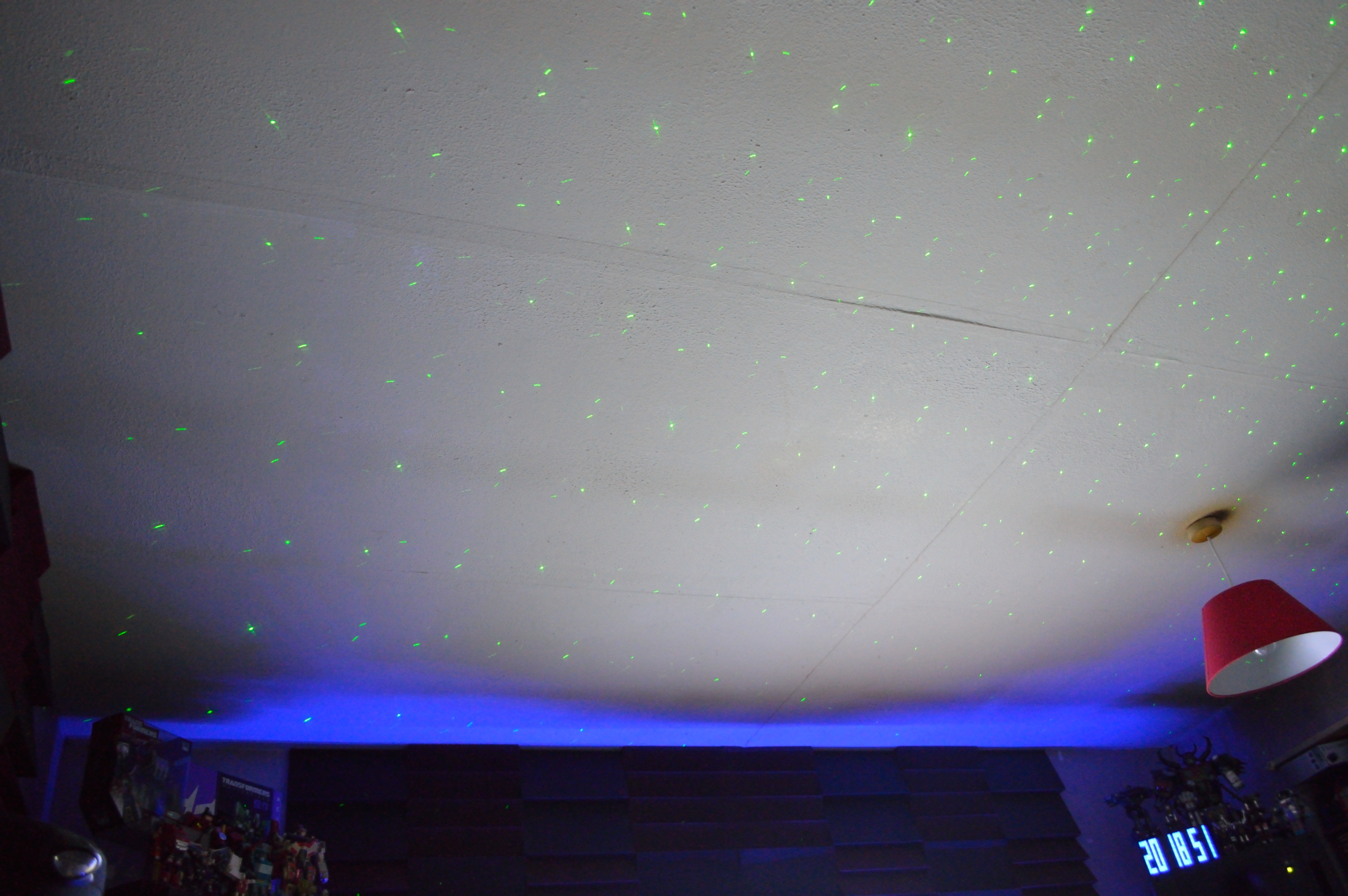

January 6, 20188 yr you could put them on ur bike or just go nuts with them even my mom has some on the back of her tv tho not addressable ones tho Edited January 6, 20188 yr by soundwave
