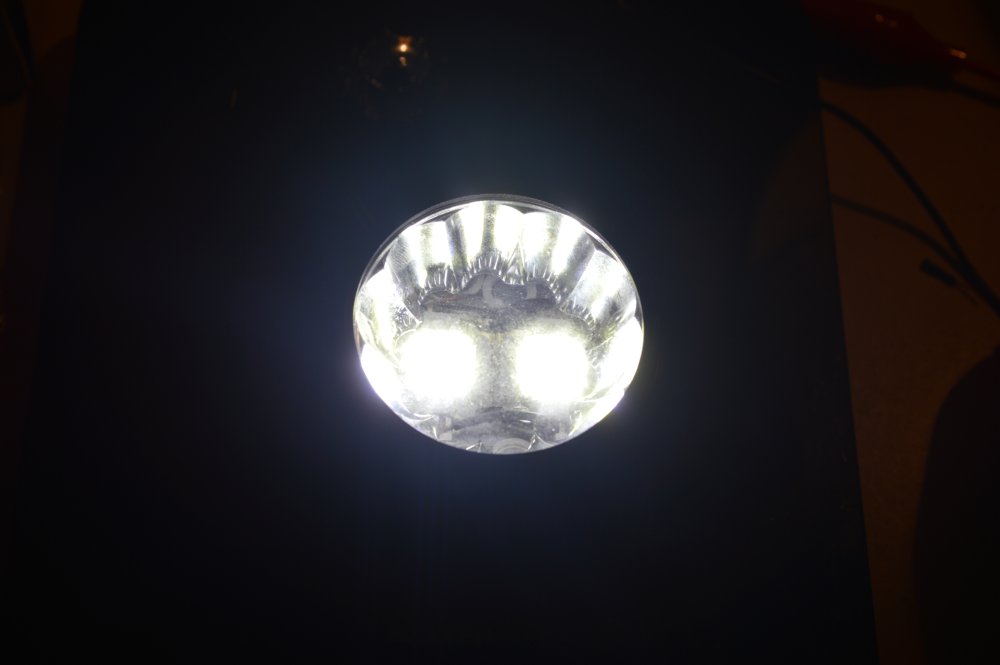

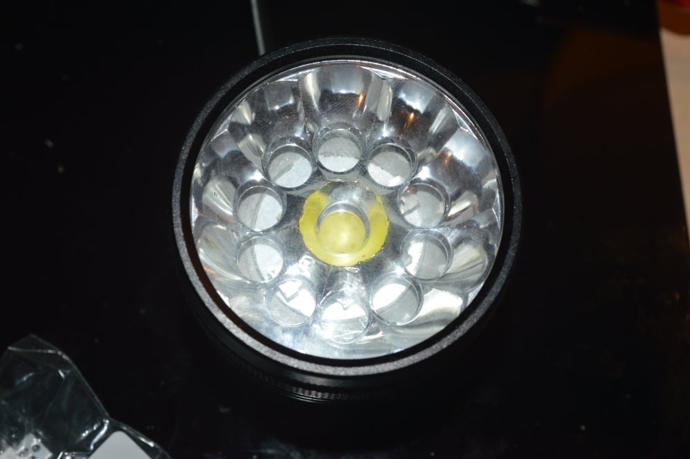

Could you cut the middle out of the old reflector so that it fits?
[ATTACH=full]16137[/ATTACH] [ATTACH=full]16138[/ATTACH]
You will not get what you want that way.
The LEDs you have are for general lighting use, a lens is the answer to focus the ray, like on the 100 watt LED video you posted.
Lovely big glass lens
You need a collimating lens not a reflector to make a led function like a spotlight.
