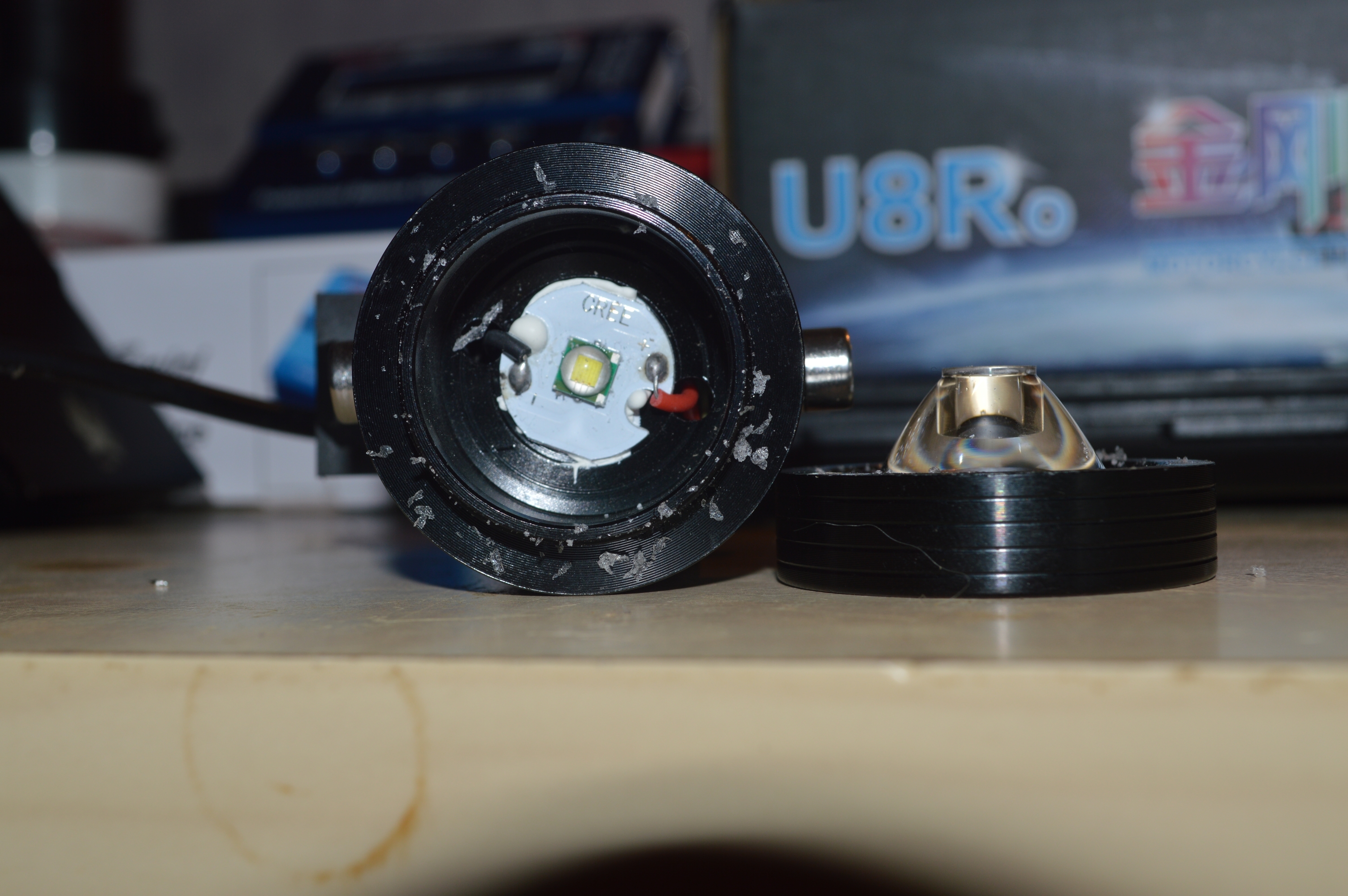

We'll I'm not a happy bunny with the new best headlight, got the bike out tonight ready for my ride put the battery pack on and no light not a thing so put another pack on and it's still the same, so it must be the light
I only got about 14 hours out of it, I hope that any of you guys that got one don't get the same problem.
I have sent a email to seller so watch this space to see if they will send me out a new one
DSC_0539.thumb.JPG.5a6a3cdb8bc5c7d75b89e52ede25a208.JPG bugger it i thought i got it the wrong way round after i paid for it lol.
the new light is more focused better lens but brightness wise there both the same.

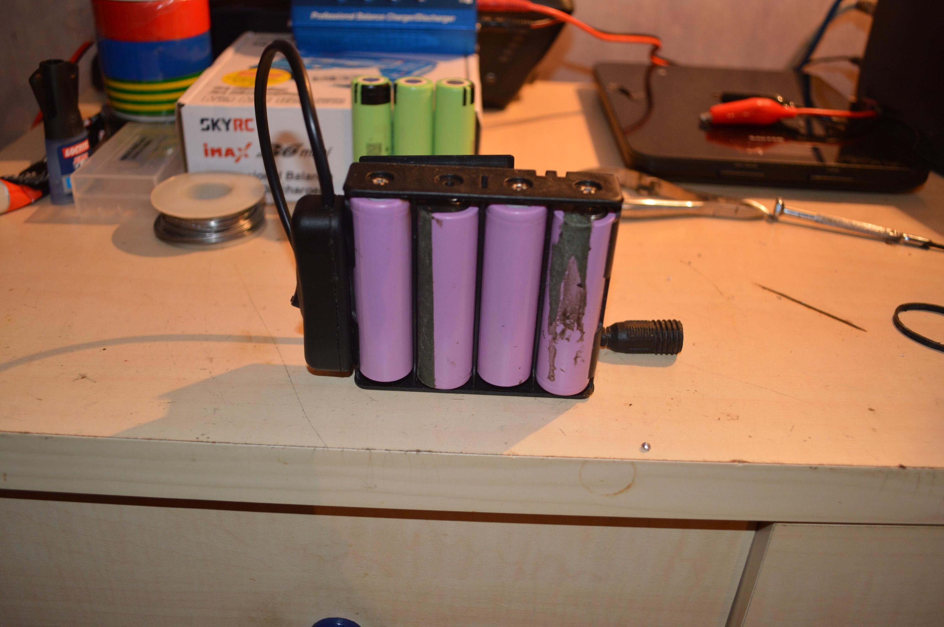

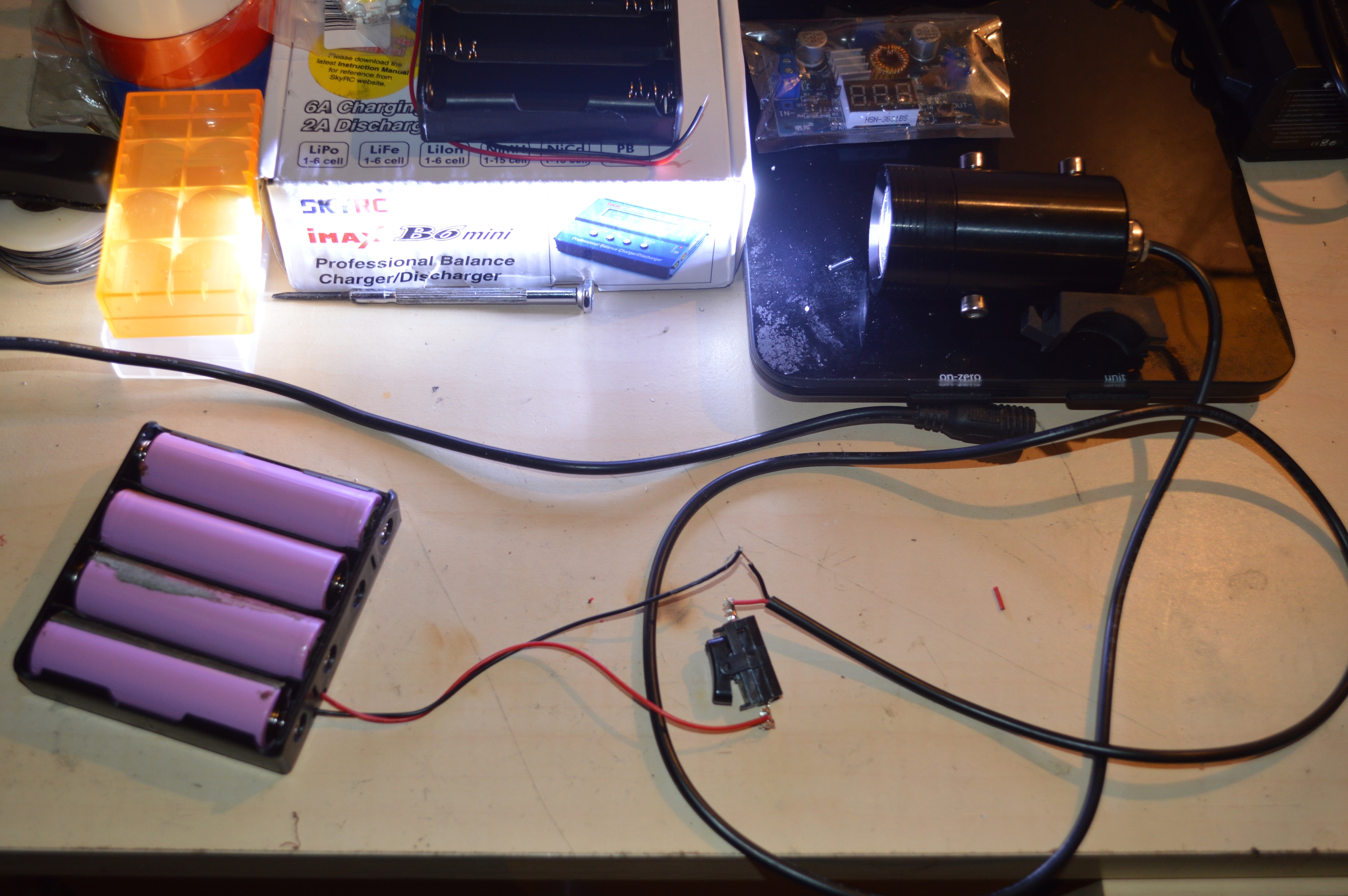

i got some 18650 cell holders coming so can use 4 cells and then use the step down converter for that. ;)

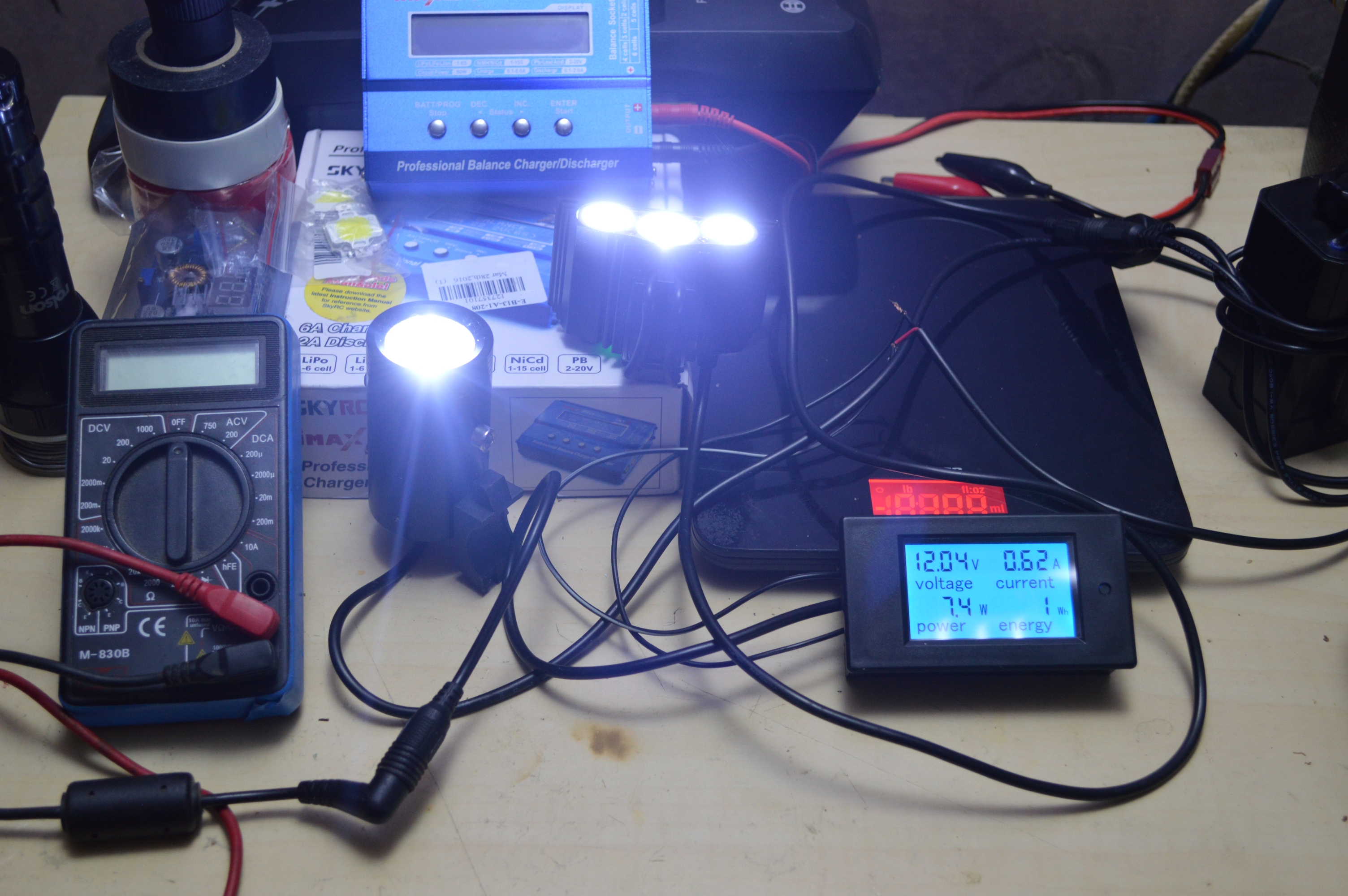

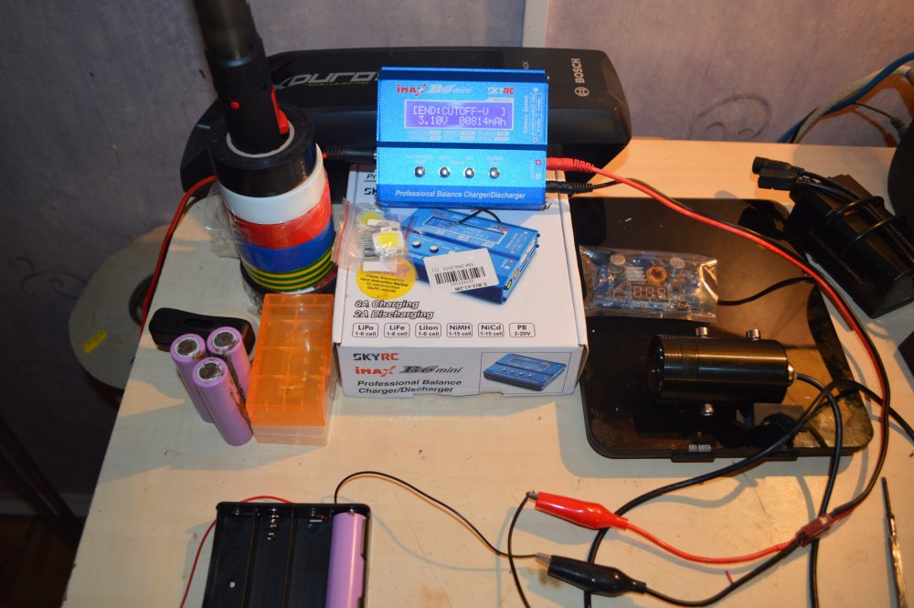

this is what the cree uses power wise
Edited by soundwave
well that looks like a bomb lol ;) 16.4v to 12v 4 cells on the other side.
Edited by soundwave

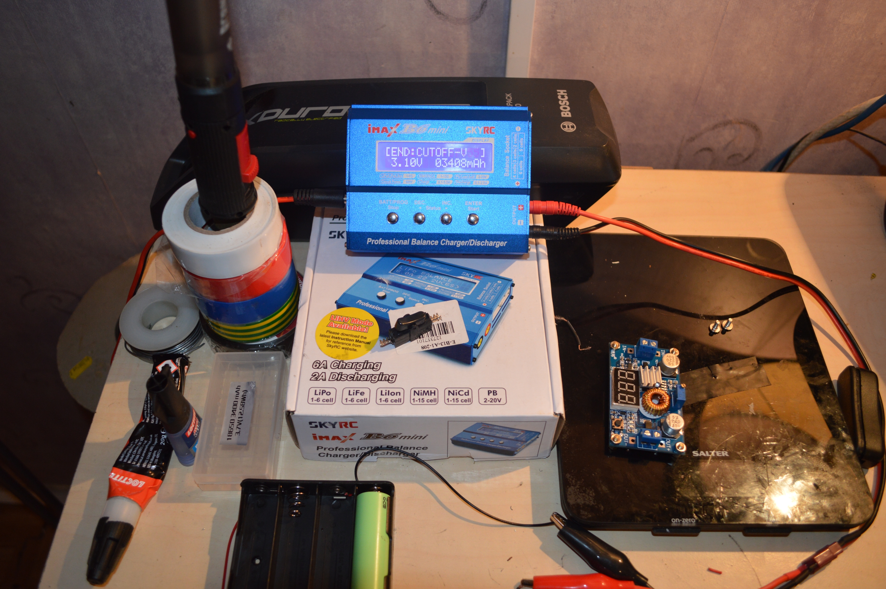

cheap cell 1 amp discharge to 3.1v got 814mha and lasted 49 mins 51sec.
Panasonic cell 1 amp discharge to 3.1v got 3408mah and lasted 3 hrs 57mins 55sec.
that is bang on what it should be and shows how crap the cells from china are and that proves it.;)

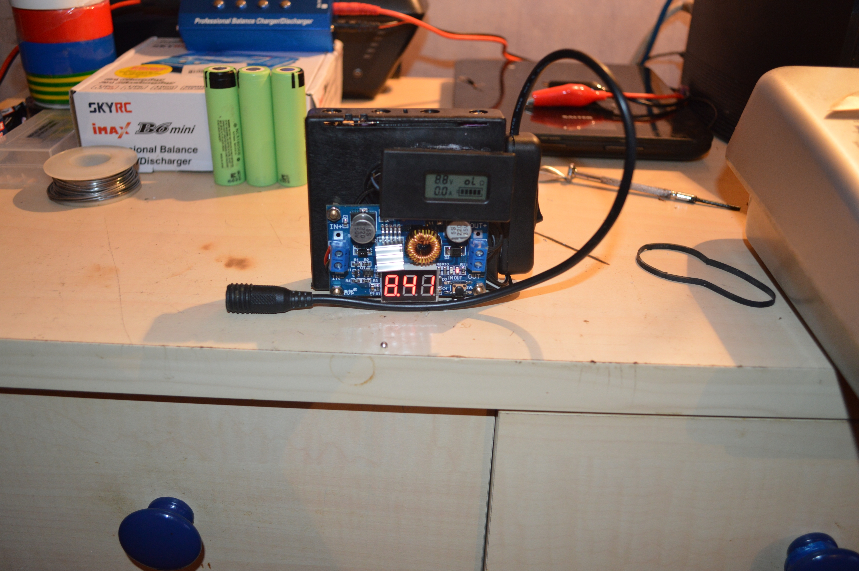

DSC_0559.thumb.JPG.c9d180218e37c762d3d30d0b3745441e.JPG DSC_0560.thumb.JPG.9e33eff5ec1003aba231a82adbca56ae.JPG
buck converter was £3
lcd with batt cut off was £4
18650 case £70p
switch £1
total £8.70
Edited by soundwave

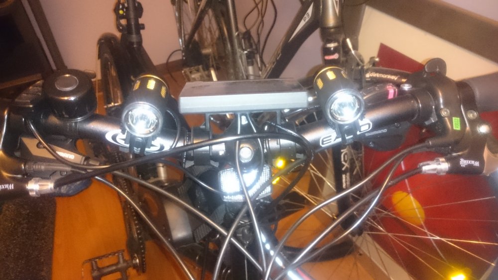

From looking at that I think d8veh's light is brighter and smaller in size. Plus it does not have the annoying strobe function.
my action cam is naff in low light but it goes further than my other light.
the lens is lots better tho at throwing the beam, both around the same power tho.
