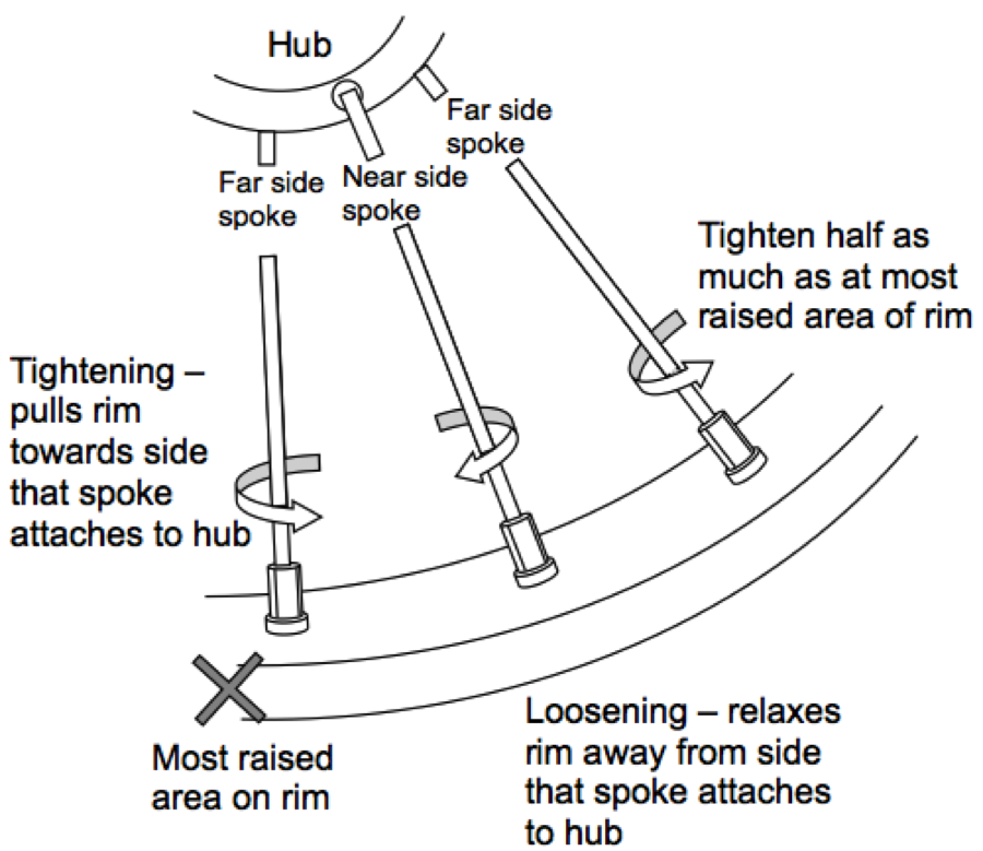

November 22, 20169 yr Author Another tip when trying spoke adjustment for the first time is to use a piece of chalk when finding the "high spots". It makes it easier to keep track on progress while the adjustments are being made. It's so easy to forget and turn the spoke nipples the wrong way, which can be disheartening if you have no reference from where you started ! yes I will mark place with chalk so is it true what I said above as you have not replied regarding that. bit so say looking at wheel from back of bike, when its upside down, and it seems closer to left brake block as spinning, I mean where its out of true. do I just tighten the 2 spokes on right side of hub, opposite to where its pulling to left to pull it over and also do i have to loosen the spokes on left where its close to brake blokes.
November 22, 20169 yr yes I will mark place with chalk so is it true what I said above as you have not replied regarding that. bit so say looking at wheel from back of bike, when its upside down, and it seems closer to left brake block as spinning, I mean where its out of true. do I just tighten the 2 spokes on right side of hub, opposite to where its pulling to left to pull it over and also do i have to loosen the spokes on left where its close to brake blokes. Sorry Billy, I didn't realise the question was aimed at me. I'll try and answer though, If you look at the way the spokes are laced to the wheel you'll see that each one alternately pulls the wheel to the left or the right, because at the hub they are fixed to either the left or right hand flange, even though they all pull on the centre line of the rim. So to move the wheel rim to the right, you need to tighten the nearest spoke that is fixed to the right hand hub flange, and also loosen the nearest one that is fixed to the left hand flange. So you need to loosen one side and tighten the other, usually by an equal amount, that will move the rim over towards the side that has been tightened. You'll soon see the effect, and whether you need more or at a different point. The secret is to do it in small amounts, say no more than half a turn of the spoke nipple. Be careful when you start to notice which way turning the spoke nipple tightens and which way loosens. It's easy to get confused at first, because the nipple screws on to the thread on the spoke, not into the rim. Don't adjust any of the spokes by a large amount, or you may over or under tension the wheel, or make it out of true "radially" instead. Edited November 22, 20169 yr by eHomer
November 22, 20169 yr Author Sorry Billy, I didn't realise the question was aimed at me. I'll try and answer though, If you look at the way the spokes are laced to the wheel you'll see that each one alternately pulls the wheel to the left or the right, because at the hub they are fixed to either the left or right hand flange, even though they all pull on the centre line of the rim. So to move the wheel rim to the right, you need to tighten the nearest spoke that is fixed to the right hand hub flange, and also loosen the nearest one that is fixed to the left hand flange. So you need to loosen one side and tighten the other, usually by an equal amount, that will move the rim over towards the side that has been tightened. You'll soon see the effect, and whether you need more or at a different point. The secret is to do it in small amounts, say no more than half a turn of the spoke nipple. Be careful when you start to notice which way turning the spoke nipple tightens and which way loosens. It's easy to get confused at first, because the nipple screws on to the thread on the spoke, not into the rim. Don't adjust any of the spokes by a large amount, or you may over or under tension the wheel, or make it out of true "radially" instead. Thats excellent many thanks i will do 2 spokes to loosen of left of flange and other 2 op side to tighten. then gradually do 1 spoke left to loosen 1 spoke on op side to tighten.
November 22, 20169 yr I googled images and found a diagram that shows it clearer than my explanation.
November 24, 20169 yr Author I googled images and found a diagram that shows it clearer than my explanation. [ATTACH=full]16458[/ATTACH] yeah thanks for that very handy diagram, But so far I have not even tried as not been on bike as its been too dam cold and wet, so not even removed old broken spokes or even ordered new ones but will do soon.
