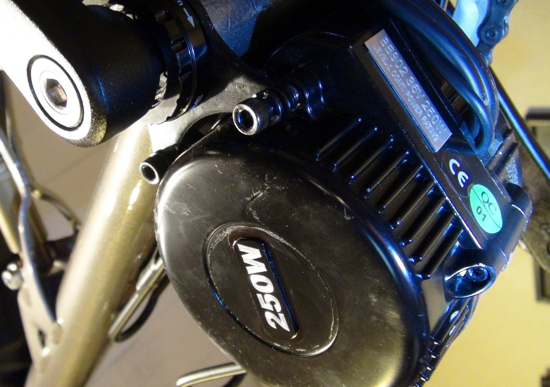

January 4, 20179 yr I'll just remove any obvious evidence (stickers etc) of it beeing over 250w. and it will be limited to 25km/h. It's engraved into the casing underneath - not easy to hide!
January 5, 20179 yr You're lucky I'm not a Policeman! I must say that I like the 250w decal on the side, which is a bit more convincing than the plate.
January 6, 20179 yr Author *cough* [ATTACH=full]17139[/ATTACH] Thats just what I need, can you get a set for me? OT, her old bikes battery (36V) shorted out today, all 50 18650cells right in the shitbox, just because the charge checker got a bit moist and shorted out. I have some 12V MC batteries, they are rated 9Ah each, but how are such batteries compared to lithium ones? Will it be a complete waste of time and zipties to fit 3 of them in series to get her around? Edited January 6, 20179 yr by Renax

January 6, 20179 yr Thats just what I need, can you get a set for me? The plate on the side of the motor is fine. It's only covering up either 'Bafang' or '8FUN'. Correct me if there are units out there with '750w' on the side. The information on the bottom of the unit is etched, well it is on mine anyway. Any plate stuck over the top can be easily removed. I would Dremmel the information off, then coat with some black paint first. Disclaimer: Do this entirely at your own risk!
January 6, 20179 yr I would Dremmel the information off, then coat with some black paint first. Yep!! then Araldite on..

January 6, 20179 yr Author Any plate stuck over the top can be easily removed. Any policeman trying to disassemble my bike will hear from my lawyer... But yea, I'll use something better than double sided tape to fix it on there... [mention=8201]1boris[/mention]: Hei, nå har jeg bestilt 750w versjonen, har ikke god nok råd til å betale mer for den kjipe versjonen... Men det er noe rart med betegnelsene, om den er 250w på 25A, så er den enten 10V, eller så er den like lite lovlig som min etter jeg har satt 250w klistremerke på den...
