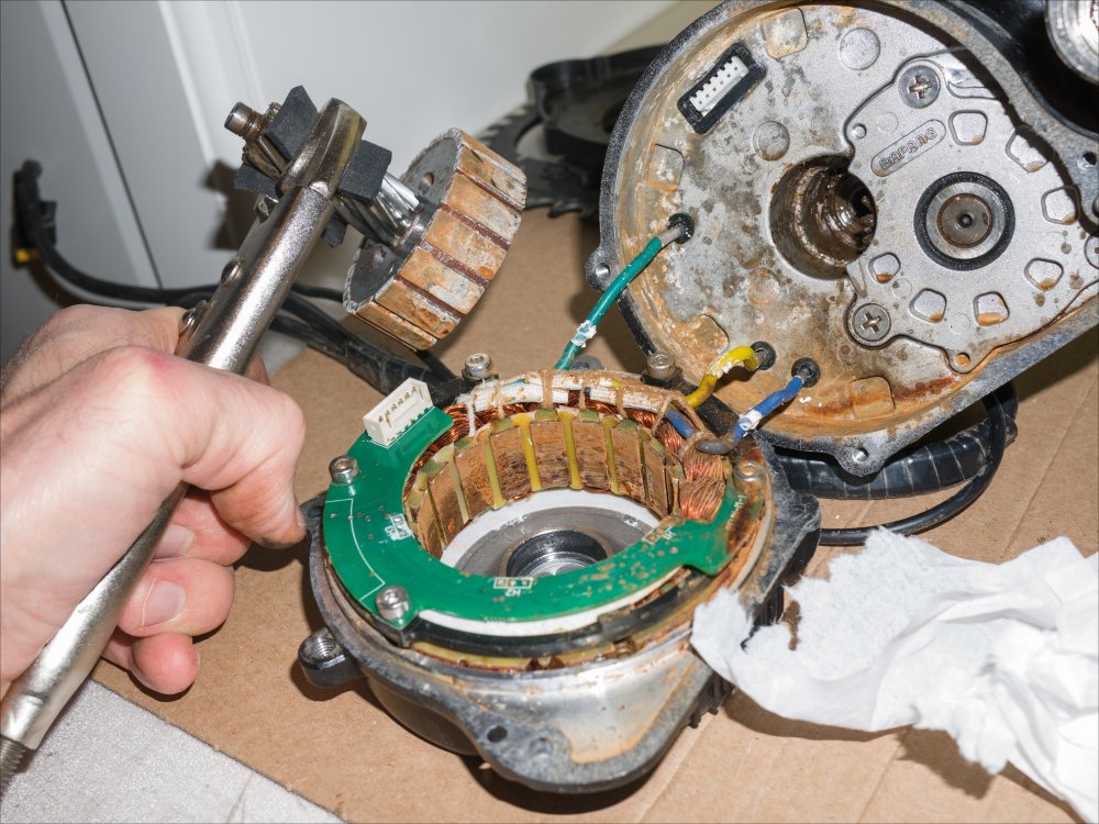

Have now opened up, all gears is fine! Very strange this. But it was much water intrusion in the motor area. Maybe it was a short somewhere. Hall sensors or something, that prevented control to work as normal. Or there is some dirt in some gear. Actually the secondary reduction gear didn't move on first try but then it loosened up. Feels like some grain of sand there or something.
Would be interesting to remove crank shaft and big gear and see how it works with power on and throttle. Don't have that tool but will try with shaft there first.
Yeah, totally agree with anotherkiwi. Clean up and pack that bugger with some good quality grease such as AeroShell Grease 22.
Thanks for answers. Yes, I will, bought grease. Just waiting for the tool to arrive so I can remove secondary reduction gear.
I had put alot of grease in there in the beginning. But now it's mixed with rust and water :) doesn't seal so well there. But the motor and controller parts should be easier to seal. I bought this "make-your-own-gasket" thing so you can just apply that to the parts and that should seal it.

does anyone have any idea how to stop water getting in through the bottom bracket?
the water and dirt will turn grease into sludge and the sludge gets inside the gearbox then to the ballbearings etc.
I am looking for some rubber gasket better than the one supplied by Bafang for the left hand side, also something for the right hand side.
I don't know if anyone has heard of GOSPADE. Their solution looks interesting but they use the same rubber gasket on the left side.
I guess as you filled it with grease initially you didnt reseal the motor properly.
But I greased the big gear area, secondary reduction gear. Have never opened the motor/controller before. First time this.
Maybe it is like Woosh said, water comes through BB?
