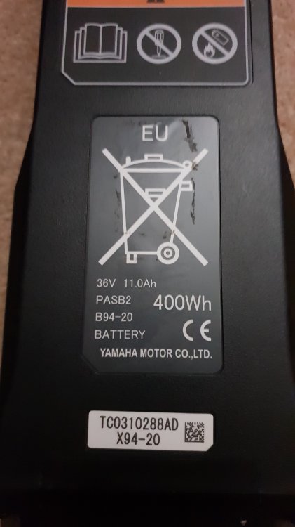

November 16, 20178 yr Hi All, 1 year, 150 recharges, and just over 3000 miles later Im noticing that now its cold again my battery is struggling to make my morning commute (21 miles, a bit of uphill, and usually into the SW wind). This is with a fair bit of annoying battery management, basically riding slower and on a lower assist setting, which just isnt as much fun. Most mornings I end up with between 4 and 7% left, and that last bit under 10% isnt much fun either with the power output hugely limited. My 2016 sduro has the 400wh battery and I believe a 500wh replacement will fit and would probably solve the problem i.e. probably support being on high assist the whole way which would be ace and fun. They arent cheap though at £799. I'm wondering what the options are 1) After market replacement battery such as one from allBatteries (468wh for £329). Seems like a bit of an upgrade and cheap too. 2) Having the original recelled / potentially upgraded at the same time. does anyone do this? 3) Wiring in additional batteries to up the total capacity (I see some people have done this), or carry a spare second battery on a rack and chnge it over when necessary. Dont really want to do this. 4) Sell my current one to someone who doesnt need absolute full capacity and put that towards a new 500wh one. My original plan was to try and see this winter out, and perhaps the summer with the current one then just buy a 500wh one before next winter but I'm not sure the capacity will last that long. Even a drop of 5% is a bit of a problem for me espeically on cold days with reasonable headwinds like this morning. Any ideas appreciated
November 17, 20178 yr You can do any of your suggestions but first it may be worth checking the battery capacity, this manual will tell you how see page 19. https://www.manualslib.com/manual/975488/Yamaha-X94-Series.html#manual If you are getting that low then you are giving the battery a real pasting, the last 10% is horrible but there is also a smaller power reduction at 20%. A 500Wh battery is a straight swap I have hired one before for mine witjout problems. Option1. Yes that battery looks good, I dont know what cells are in it and how it would fare over time, I think you would still be very close to hitting the 20% point. Option 2. I believe Jimmy at Insat International can re cell Yamaha batteries. Option 3. The additional battery is the rout I have taken, initially by hiring a battery and then by fitting an extender battery in parallel with the original. I got a battery built in germany that has 30 cells in it and nearly doubles the capacity. You do have to make sure the voltages are identical when making the connection and always fit the Yamaha battery and turn the bike on before connecting the second battery so maybe not ideal for commuting. Option 4. Maybe you could sell the battery to someone else in the same boat and buy a genuine 500Wh battery that should see you through with a bit more certainty than the aftermaket one. Don't really know what you would get for a second hand battery as people are nervous (rightly so) of buying second hand batteries. I think if I was in your position I would contact Jimmy at Insat International ( +44 (0)208 361 1790) first and see what he can offer, if that avenue is no good buy the aftermarket one and see how it goes maybe carrying the original as a spare until you have confidence. What you will find though is as you have more capacity you will use it harder and be back to square one;)

November 20, 20178 yr Author Thanks for the suggestion Chris. I shall try jimmy and go from there. Btw the battery capacity hasn't reduced much. Even when the bike was new I had to manage the battery to make it to work (21 miles, 300 feet up hill, plus headwind). With it always being on the range limit even a drop of 5% capacity makes quite a difference to the ride and required management. That is what I'm talking about trying to fix here. It's not a warranty claim as such. The reason I am able to juice the battery in just 21 miles is because it works very hard the whole time. A couple of months ago my daughter rode it with me on the road bike. We did 26 miles, over 1000 feet of total climb, avg 18mph and she still had just over 40% left.
November 26, 20178 yr Hi, a bit late to this thread. These batteries do not like regular deep discharges. My own commute is 16 miles off road to work and 10 miles on the road back home. I have a Yamaha sduro 2015 with 400wh battery like you, The way I manage my ride (ie eco, standard and off) I use about 40% of my batteries capacity on each leg of the journey. I can charge my battery back up at work. I store my battery indoors and only charge the battery back to full close to the time I am setting off for work. Using the Yamaha manual that Chris_n mentions I recently found that my battery had been charged more than 700 times (the maximum measurement of the test so it could be a few more than 700 charge cycles or a lot more), but that the capacity was still in the maximum range of 75% to 100%. I have reached 7576 miles as of my return from work last night. There is no issue about using higher power levels and hammering along unrestricted as this is indeed fun. However with a commute like yours I would take a spar battery and at a convenient spot swap over so that you use the same amount of capacity of each battery for the distance you travel. So for your commute swap to the second battery when the first is down to about 50%. Charge them both up to full at work and repeat on the home trip. This will be much kinder on both batteries and used in this way they will last ages. My own preference for carrying stuff is a rack and Ortlieb panniers. The best way to treat these batteries is to store them indoors at about 50% ish percent, certainly not 100% and charge them up to full as close to departure time as possible. The Yamaha PU motor is great but more power hungry than the Bosch.

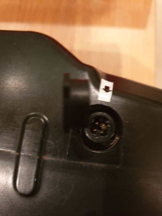

February 2, 20188 yr Does anyone know if the yamaha haibike charger plug and battery port is a standard electrical connection that can be purchased separately? Cheers
February 2, 20188 yr Does anyone know if the yamaha haibike charger plug and battery port is a standard electrical connection that can be purchased separately? Cheers Hi did you manage to find out an answer to this? My Yamaha charger plug is broken and I would rather replace the plug than charger. Cherrs
February 3, 20188 yr Hi did you manage to find out an answer to this? My Yamaha charger plug is broken and I would rather replace the plug than charger. Cherrs No. I've had only your reply.
February 3, 20188 yr Does anyone know if the yamaha haibike charger plug and battery port is a standard electrical connection that can be purchased separately? Cheers I think you're out of luck. I've not tried searching in earnest myself, but a quick search some months ago came across some very keen Germans who were asking the same question and the conclusion they came to was Yamaha commissioned a connector manufacturer to make a custom/modified part, which you can't buy off the shelf, and it also seems difficult if not impossible to even get the part off Yamaha. Not good. Especially as its not a particularly robust plug in the first place :-( I'm sure the thread still exists out there (complete with pictures and manufacturer details), if you want to search. Google translate will be your friend though :-)
