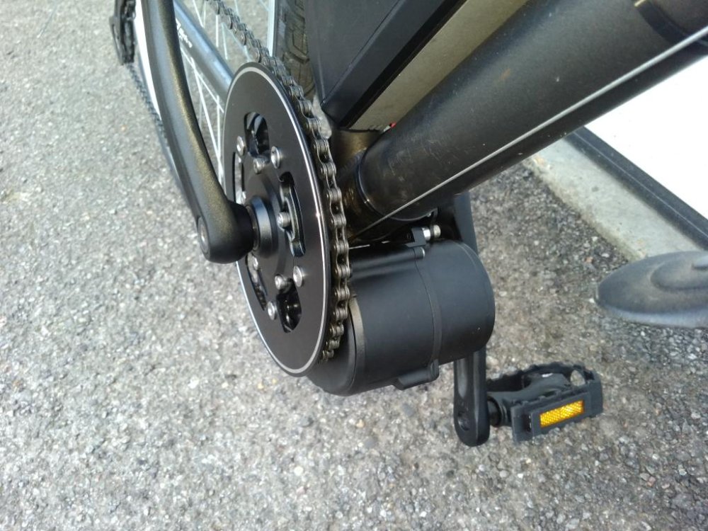

my customers rarely need help with fitting crank drive kits and yet, in our workshop, it takes about the same amount of time and effort to fit a hub kit or a CD kit.
Front hub kits are definitely easiest to fit.
Points to watch:
If you have 160mm rotor, some hub motors are too large and will foul against the caliper requiring you to change to 180mm rotor.
Hub motors cannot be fitted to frames with bolt through quick releases.
Crank drive kits only fit standard 68mm or 73mm bottom bracket shells and won't fit most carbon fibre frames.
If you have cables running under the bottom bracket, the Tongsheng TSDZ2 will require moving the cables out.
If you have combined gearshifter and brake levers or STI levers, think of fitting the Tongsheng TSDZ2. It's a nice torque sensing kit, requiring no brake sensors.
If you need advice for any particular donor bike, let me know.
All the best,
Tony

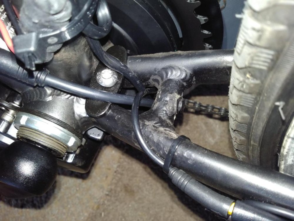

Not always the case but with all my bikes past and present which I have fitted with hubs be it front or rear, the ali dropouts have needed filing deeper and up to 1mm wider to accommodate the Anti rotation washers and to allow the washers tabs to full sit in the drop out. Std qr axles are 9mm, hubs axles are 12mm for most though some do have 14mm axles. 2 or 3mm may be needed to be removed to enable the axle to sit deeper.
we have to do this sometimes but we also have to file off sometimes a bit of excess weld inside the bottom bracket where the seat tube and the down tube are joined. The dropout is easier to access. In both cases, it's a 5 minute job in a workshop. What takes time is something that we have to do the first time. That happens when you have an exotic bike. When this happens, we have to be two, one does the job, the other has to watch out for potential troubles.
