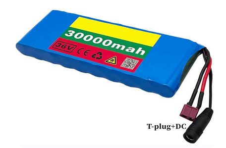

Yep, thats the type.
There is a simular one that has 30000mAhr printed in big letters on the battery. I guess its a printing error though, and the m ought to be a u, 30000uAhr looks a more likely capacity.
[ATTACH type=full" alt="51075]51075[/ATTACH]
Does that even have a BMS? Looks like plain shrink wrapped cells.
In my very early days of messing about with ebikes, I made a 10S 1P pack from cells I had lying around while I was waiting for the pack I'd ordered to arrive. I dutifully put a BMS on it and connected it up the the bike. It worked perfectly for less than 100 m, then the BMS cut in as the voltage sagged below 30V. I was not very happy and I removed the BMS and connected it directly. I did about another 100m before smoke started coming off of some of the cells. I quickly cut the power and stood well back. It cooled down, but the shrink warp on several of the cells had melted and peeled off. If hadn't spotted the issue, it could have been nasty.
So that's what will happen with a badly constructed 10S 1P pack with cells that are poorly matched and not designed for 15 A current draw. If there is a BMS and it does it's job, you won't get far. No BMS or a faulty BMS and you are likely to end up with a bike fire.
For a light weight bike with 1s how far do you want to ride ?
12 - 15 miles if you are lucky using a quality 21700 cell.
Good call, the Samsung 21700 40T is 4Ahr and has a very high discharge current capability. Might be a way to go, 10S1P for light weight and local, 10S2P for long distance mode.
My guess is what they have done is use 3000mAh cells, then there are 10 of them, so they came to the conclusion it must be 30000mAh :)

Someone could buy 10, put them in parallel, paying £140 for a '30Ahr' battery or is it 300Ahr ?
(I recommend you dont try this).
Amazing.
Someone would buy 10, put them in parallel, paying £140 for a '44Ahr' battery (dont try this).
The listings are different for the 4.4Ah and the 3Ah models, hence the difference in price, but yes, someone might try and put a lot of these in parallel, <£140 (as they do a bulk discount) would still be cheap for a 30Ah pack. Probably would need 10 Schottky diodes though to ensure some level of safety!
If you have a mini spot welder then one can make up a cell pack using quality cells like the 40t or p42a/p45b's . All rated for 25/30a and genuine high current cells, they still though need a 1s protection board for safety.
Problem is with buying 10 cells is the price at least a fiver a cell.
I have one of those cheap ultrafire cells , it cam with a torch I bought. The cell wrapper is an amazing one and indicates 9800mah which some unknowing gullible person would believe. The cell is amazing I charge it and the torch gives out amazing light and is super bright but after about 10- 15 mins use, it is as much use a chocolate fire guard.
I tested it from a lowly 3.15v and got about 810mah to a full charge, like all cheap over rated cells the chinese simply add a 0 to the mah rating to big them up. 980mah I likley the most it can ever see from 2.5v.
As with these AliExp bargains , if it looks to good a deal then it is and one shold pass GO without stopping.
