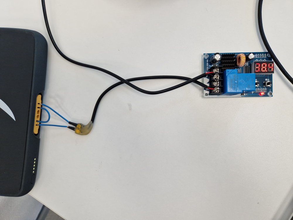

October 2, 20232 yr Author In answer to one of AnthonyC’s questions: - Taking a fully charged pack measuring 41.6v on the outer flat pins when you press the test switch on the pack, if the pack in not under charge (no charger connected) I get 0v across the outer flat pins and 35.3v across the two charger pins (O and D). With the battery on charge I still see 0v on the outer flat pins.
October 2, 20232 yr Author Measuring at the charging pins, there is no change to the voltage whether the pack is turned off, or turned on using the test button. A reading of 36v this time for both pack on and pack off.
October 2, 20232 yr Hm, inconclusive but I guess it's a regular two port BMS and doesn't rely on a proprietary charger. IIUC there might be a hack to indicate battery condition. If at random times you stop charging the battery reading should drop a LED about one time in four...? When the battery resistance triples this would become three out of four etc. The only use I can think of for this is when the ride is weak to help rule out other faults like PAS or controller.
