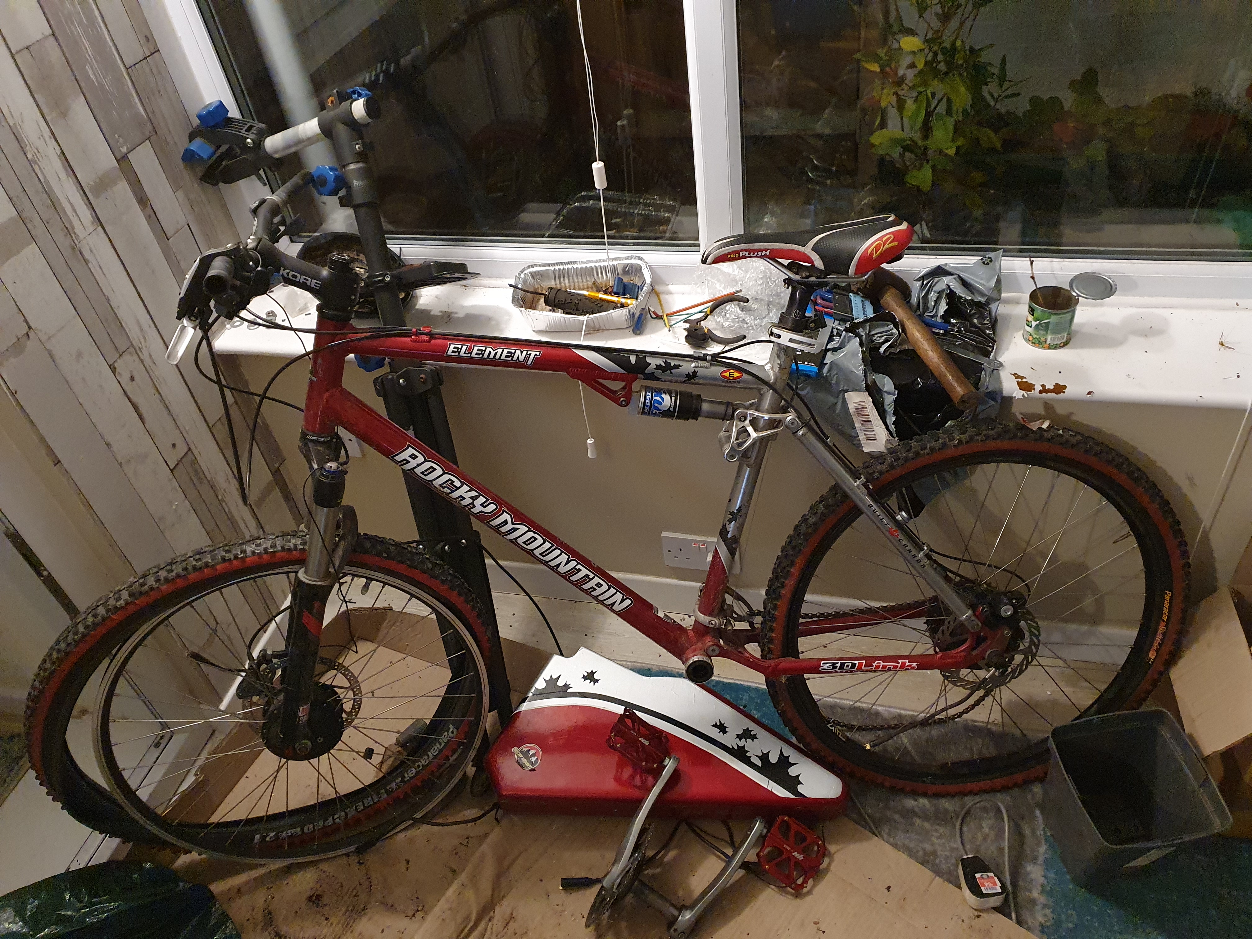

I've started a new project. AFAIK, what I'm doing hasn't been done before - not like I plan to do it, anyway. It'll start off fairly normal, then it'll get expanded, and finally, a bit of a twist in the tail. For a bit of entertainment, you can start guessing now. I'm not going to give any more clues nor will I confirm if anybody guesses correctly until it's complete, though for anyone following all my posts, there's a chance you could figure it out. I will show you photos as I make progress.
My 2WD Rocky Mountain will be re-purposed. There's a chance that it'll remain 2WD, though that depends on unknowns as it stands.

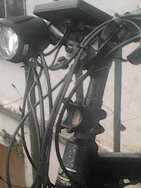

Is that why your front forks are turned 180 degrees?
I had a fight with all the cables when removing the battery box. That's how it ended up. The stem isn't clamped because it was stored in my shed with 6 other bikes. I store them with pedals removed and handlebars in line with the frame to save space.

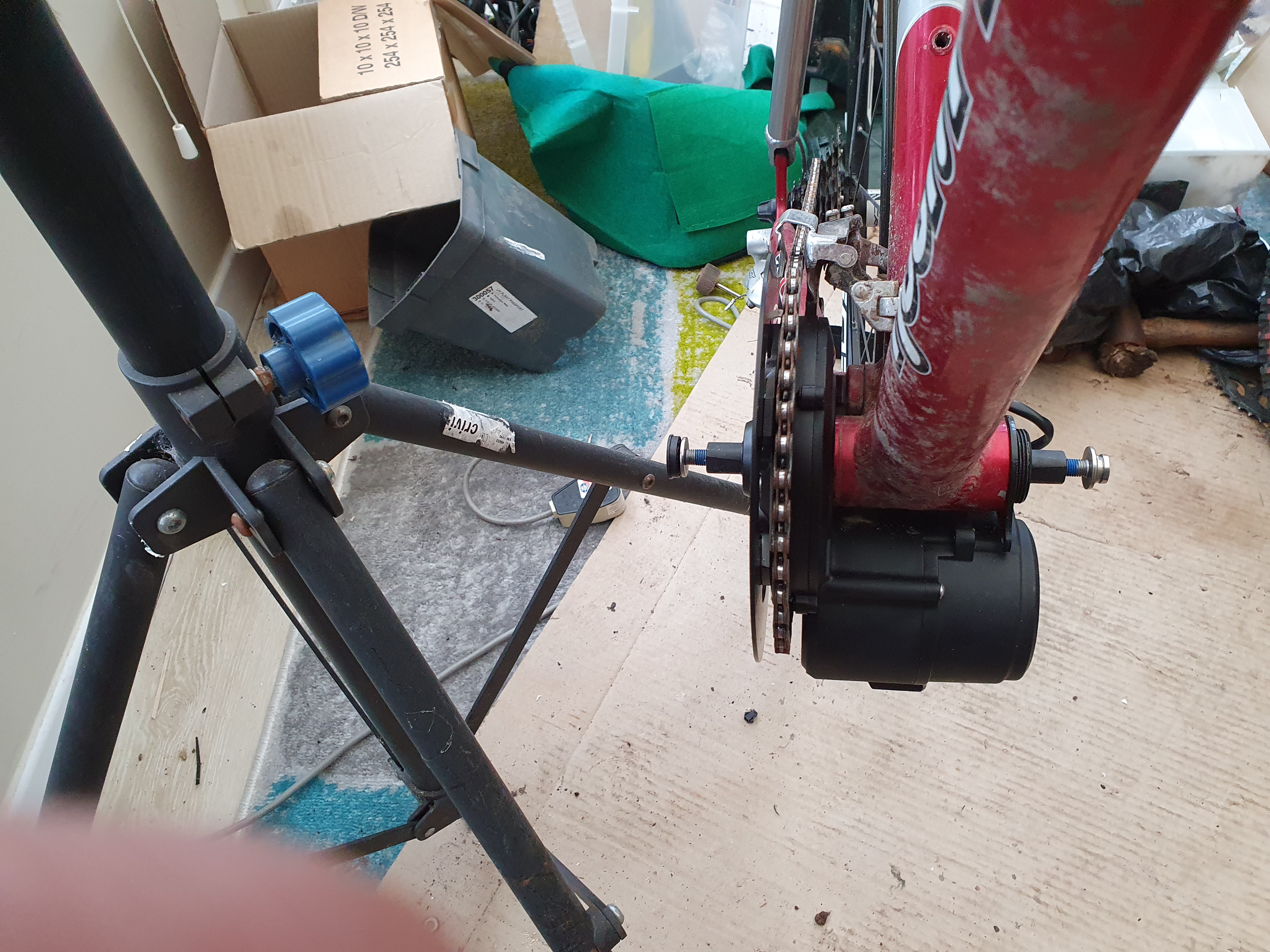

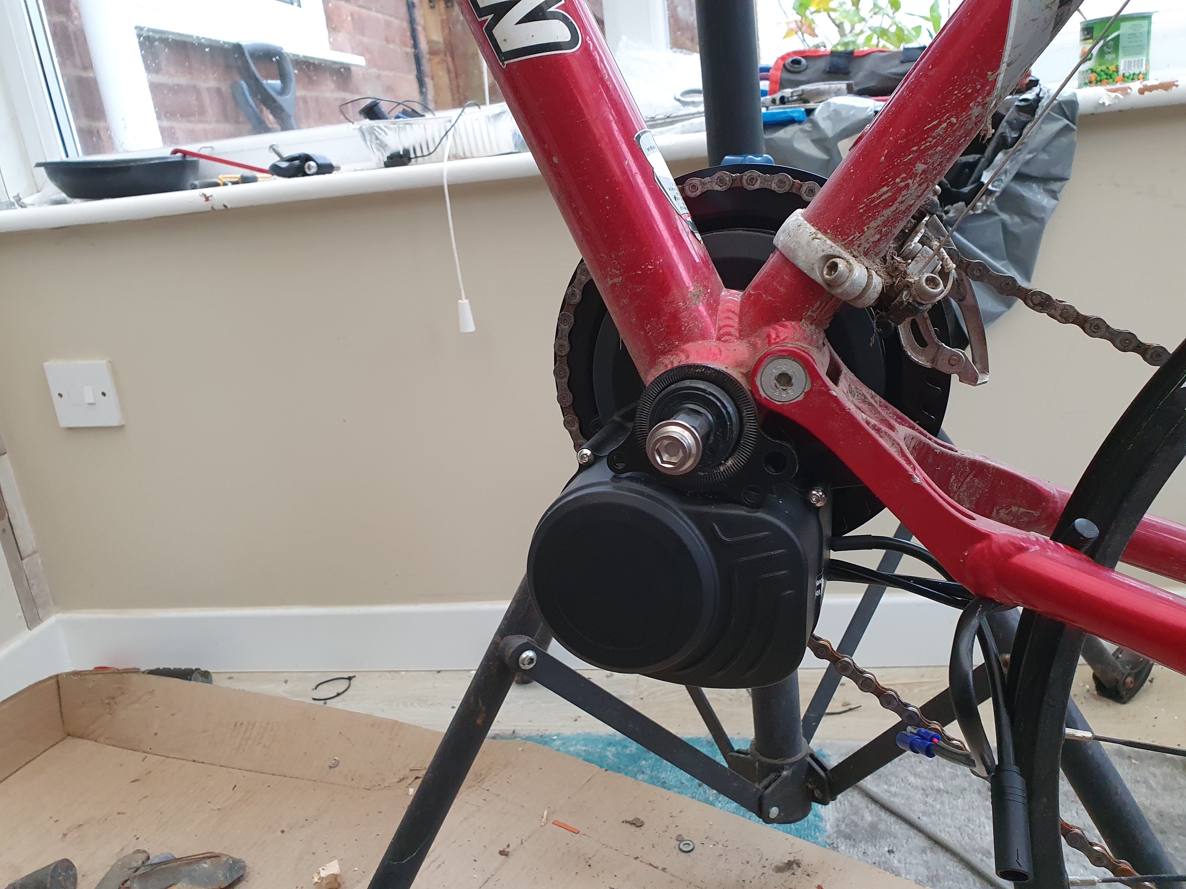

I just put the motor in to check the chainline. It looks pretty good in the middle gear.
I've now got to figure a way to stop the motor rotating around the BB. Since I moved, I've no longer got welding equipment, pieces of steel and all the other stuff I used to use for fabrication. Maybe I can make some sort of fillet between the frame and motor.
Edited by saneagle
It is a new version motor. Additional anti rotation support shouldn't be necessary.
Shouldn't be necessary - you're right there, but it is, unfortunately, because it's a FS bike and the corner of the lug on the motor hits the frame if it rotates around far enough, so I can't use the frame directly to resist the torque.
Ask somebody to 3d print you a chainring type design that you put on each side and bolt together. The discs are compressed by the motor, you could maybe use metal instead. One bolt goes through the top of the down tube and seat stay, one goes under the down tube Just an idea don't know if it will work.
Thanks fo the ideas, guys, but I'll probably use GRP, which is what I've used as a fillet on other projects in the past. Mix up some resin with a load of cut strands. Add some micro-balloons to make it a bit lighter. Put it in a freezer bag and squish it in place until set. When it's set, take it out and grind the outside faces to look nice. I thought of printing something, but it''l take me hours to get the designed shape right and it won't be as strong.

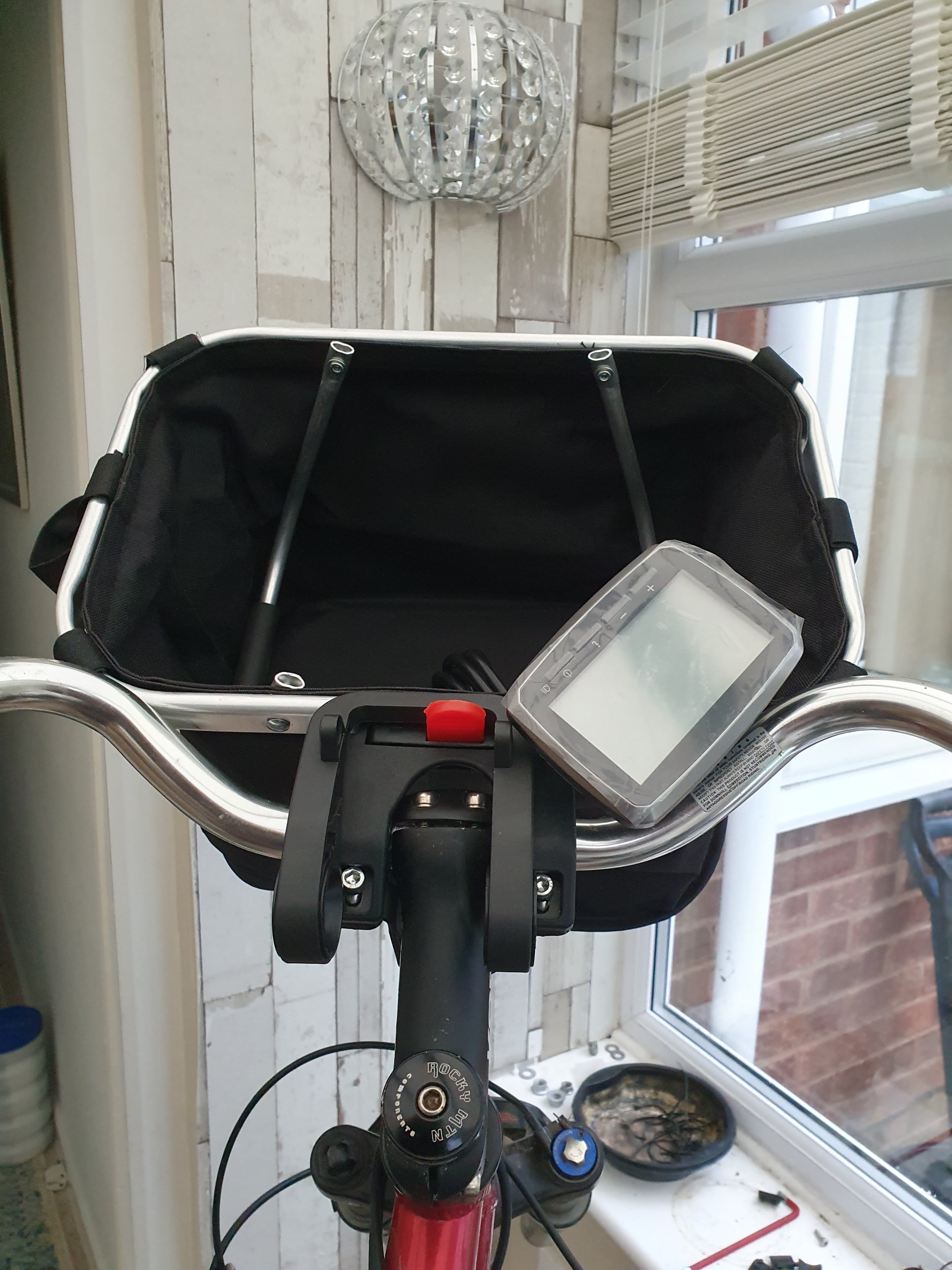

I need to find a shorter stem too, otherwise the weight in the basket will act like a pedelum and I won't be able to ride in a straight line.
Its possible to fit an additional quill type stem (often found on budget bikes) by taking off cap and punching down the spider nut. You can then fit two sets of handlebars, the upper as usual but a lower cut down set of bars on a shorter stem to support the basket as shown incomplete below.IMG0017A.jpg.e4e8e6cdd05cdbcce289c5ef68dbb56e.jpg
Great idea, but I have another solution for now.
