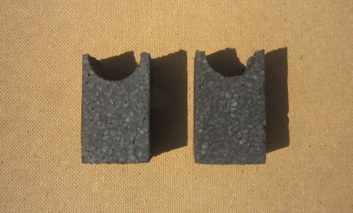

I have yet to find the need to spread a rear drop out to get a motor wheel in or out, though I find no need to remove a wheel to repair a puncture ( though for some it may be easier but more work involved).
I use normal tubes on a non motor wheel and gaadi's on motor wheels.
Thanks, I've learnt something today as I've not seen gaadi's. A really good idea and very simple.

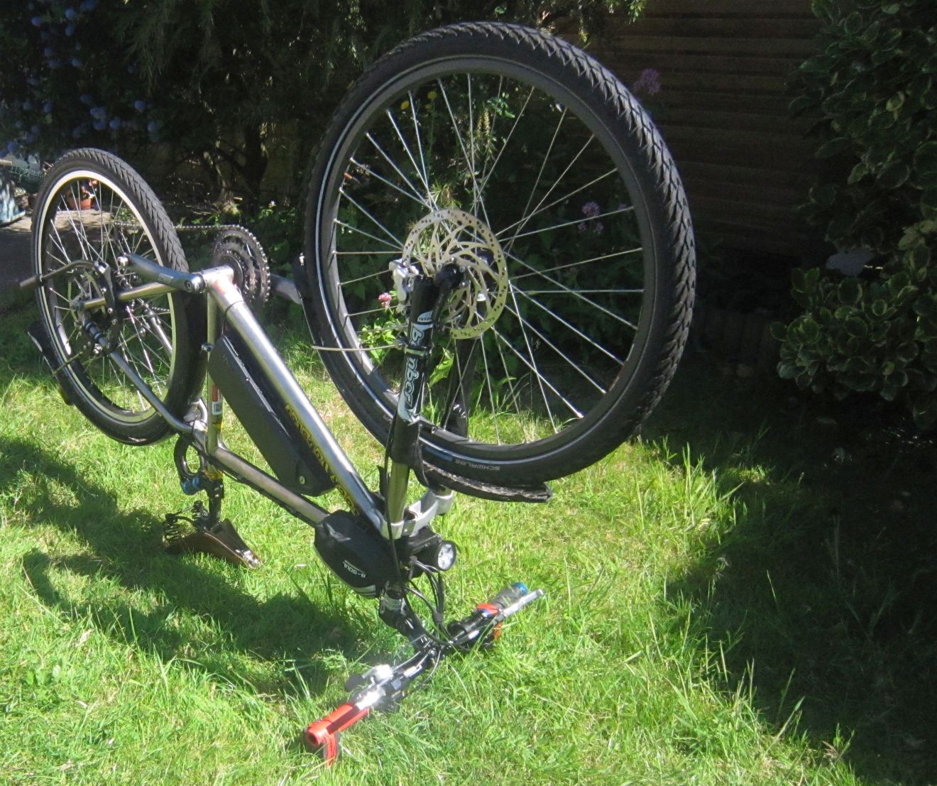

At a weight penalty of 8g I carry stands with me, its easy enough to turn the bike upside down and be stable, even on grass. Displays etc are out of the way.

btw its a lot easier just to twist items like lcd dispalys round the bars a tad out of danger of damage when the bike is upturned

This is what I have. The saddle is parallel with the steerer normally. It's a bit of a handful to grip and turn over.
If you have bar-ends, there's no need for handlebar stands - just slacken and rotate the bar-ends and they will support the bars while the bike is inverted.

Gaadi's aren't perfect but do make repairing the tube out of the rim so much easier without scrabbling about on the ground.
Gaadi's are over long by about 4" , so I simply by pass the ends in the tyre.
They still puncture and somtimes if on the harder end can be tricky getting a patch on.
Add a small bit of air to fit them .

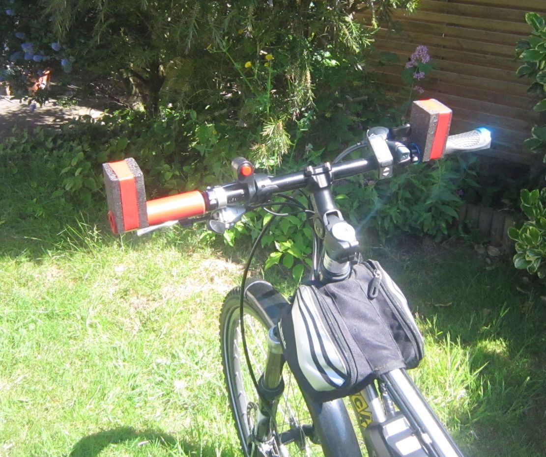

Whilst in my youth I would have no problem kneeling down and wielding the sewing needle and glue to repair punctures, these days as I have aged I find sitting on the floor or kneeling, problomatical.
So I came up with a real easy and light method of putting my bike for repair at a comfortable height.
[ATTACH type=full" alt="55568]55568[/ATTACH]
The technique is to stand behind to the side. Grab the handlebars, hold the back brake on and pull back so that the front wheel lifts up until the bike is vertical on its back wheel. Keep the brake on all the time until it's gone over to about 45 deg, then grab the front wheel and lower it down.
You have a very low seat. It might be better if you loosen the clamp and lift it up before you start, so that it'll balance better upside-down. Don't forget to keep a hex key in your toolkit for that if you need it.
Given the right method, its easy enough to put the brakes on and spin the bike backwards to rest on the handlebars.
