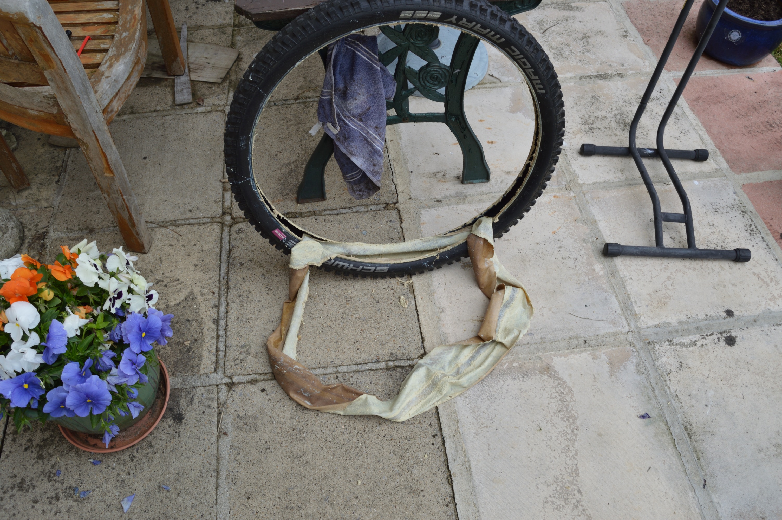

I got yet another puncture today about half a mile from home. Back wheel again. Just went down while riding. I am mad as hell. Feel like I'm being picked on! I mean seriously.
Ordered marathon plus tyre to try. Got some slime bands ( not that slime gunk) to add as well. I can't go on like this so see how it goes when I fit that lot.
3 puncture In 3 weeks. All 3 riding on tarmac

  • Well that is really unlucky! What brand tyres are you using and how much usage have they had?
  • If I get that many punctures in that short space of time, I start to think about changing the tyre on the premise that the centre band of the tyre has worn and got thinner thus offering less puncture resistance.
  • In the punctures that you have had, are they in different areas on the tube, always on the outward facing side (rather than the side of) the inner tube, and have you found out what caused the punctures?
Did you check the tyre for thorns nails etc? Some people just replace inner tube without checking and then they get puncture after puncture after puncture.
With MP tyres, you don't need anything else, so don't use slime, slime guards or anything like that with them.
