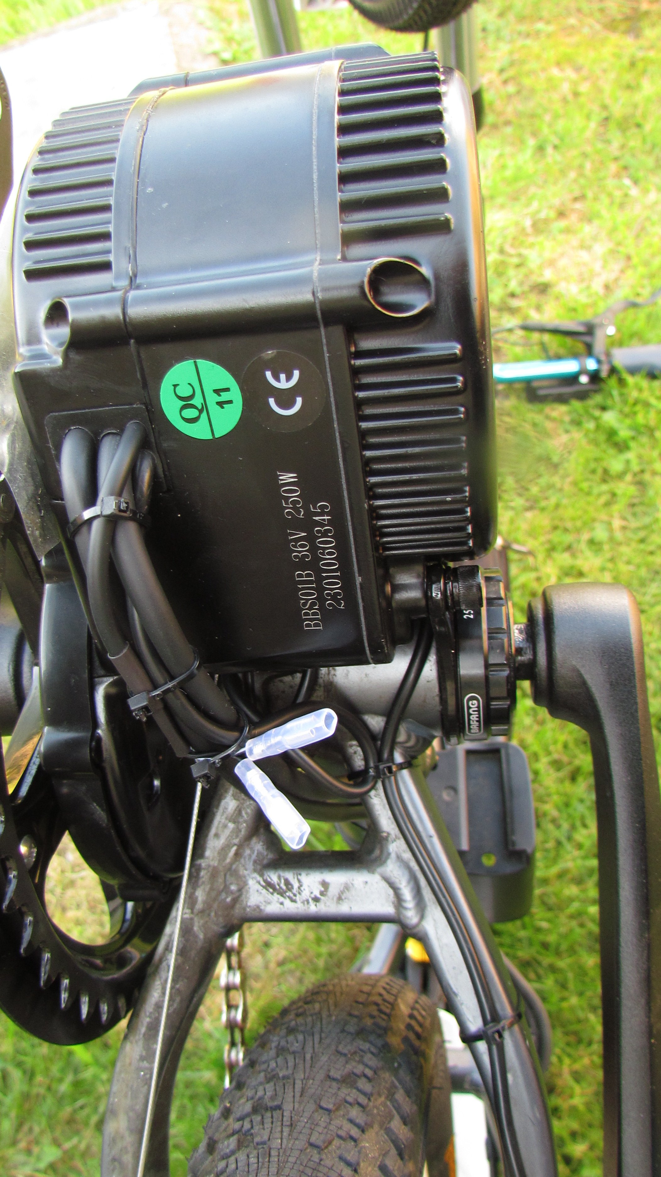

I run a 36v bs01b, I fitted a 42t front cog to cope with the steep hills on bridleways around me, there have been no issues with any hills on roads, even pulling my trailer. The kit came with a 46t cog IMMSMR. I tweaked things like the Keep Current and current control settings for a better ride, using the windows program initially, but lately the Android Speeed App on phone. If course this means you can also change ah and top speed settings when you reach the boundary of your country estate.
Sometimes running at 18ah / 350w rather than 15ah / 250w can be a help with a heavy load. It would be hard to check too, unlike top speed which can be tested at the roadside by lifting back wheel and running the motor or by following the speeding bike.

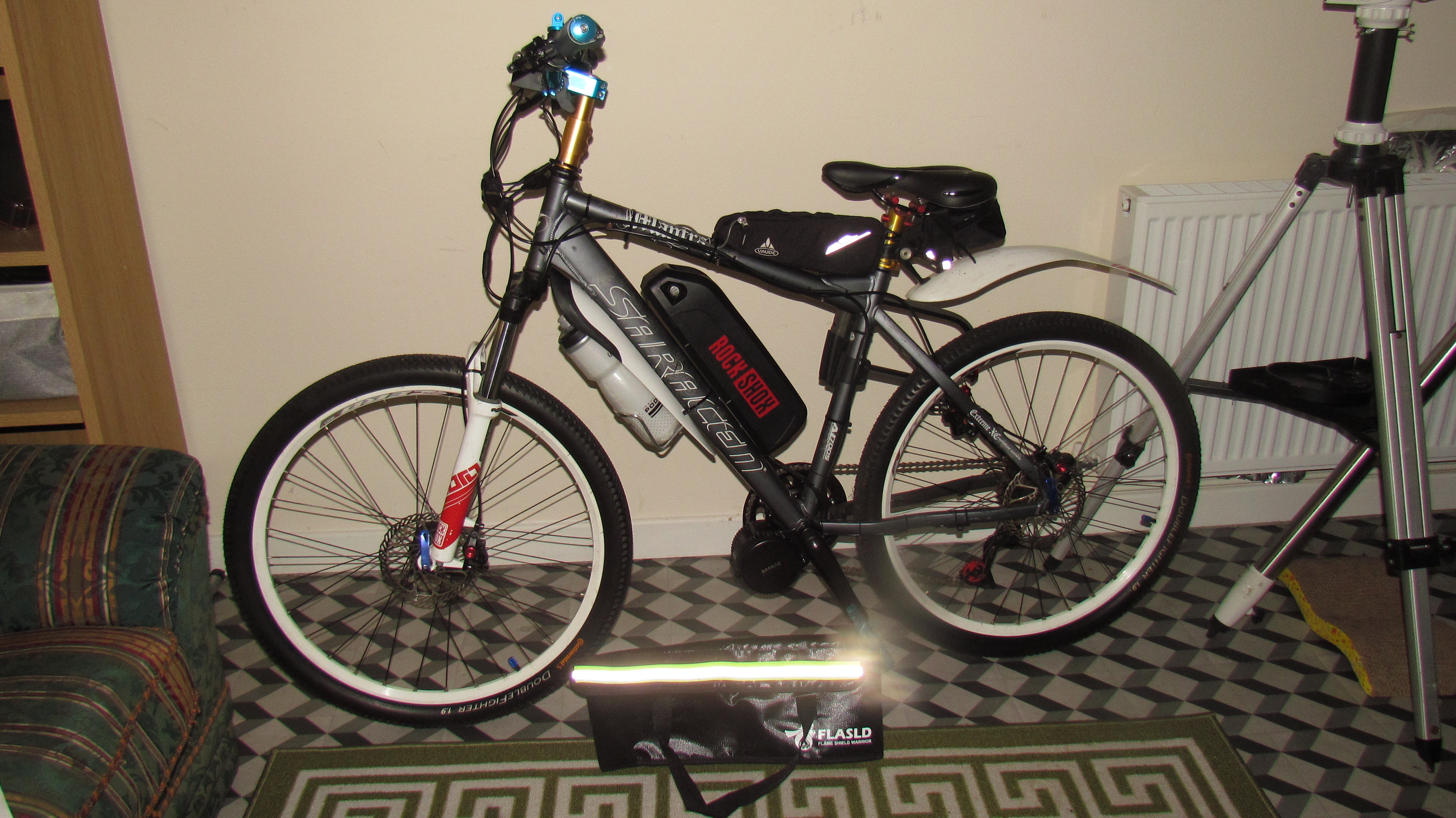

My TWO conversions from reputable seller
Cogs Y Gogs google them
Dsc_2342.thumb.jpg.63f2d409b25c94c9cb405bc9ee40985a.jpgIMG_1616.thumb.JPG.69a6d41c8c2852d42d11e138544d1102.JPGIMG_1626.thumb.JPG.1238e84fcab50561f0a28aa231de1d80.JPG
