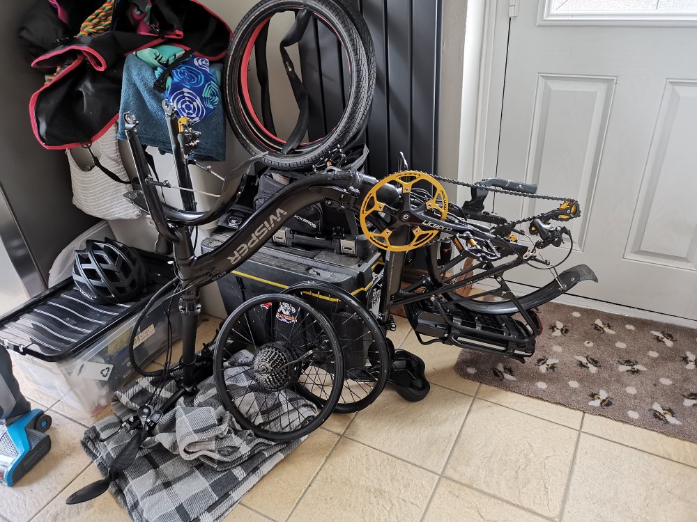

July 26, 20241 yr Author For a cross pattern one needs a very shallow nipple entry angle about 5 degrees is ok. For small wheels with a hub motor or hub gears then one is looking at a 1x lacing . The 1x, 2x , 3x is how many times a spoke crosses the next spoke it is paired with. That makes sense. Thank you. The current state of my ride

July 27, 20241 yr The motor wheel is 1x , one can go 1x or simply go radial. The non motor wheel appears to be 2x.,
