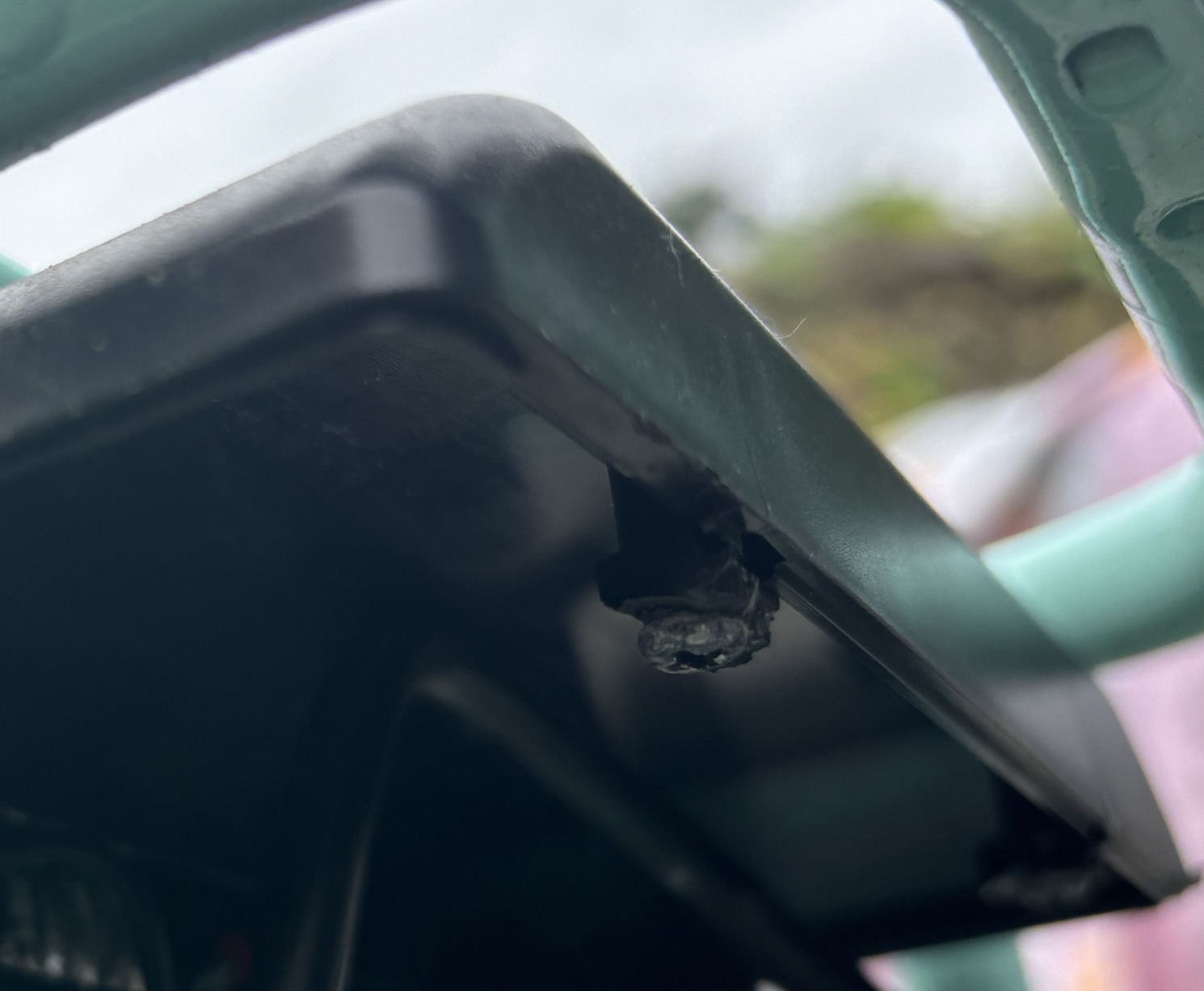

August 15, 20241 yr The state of the battery case makes me wonder if the battery is loosing connection when bumped about, this may be evident if the battery connections show any spark or arcing damage?? and would result in post bump cut outs, similar issues in the past have been resolved with shims and wedges to secure a slid battery in a single position.

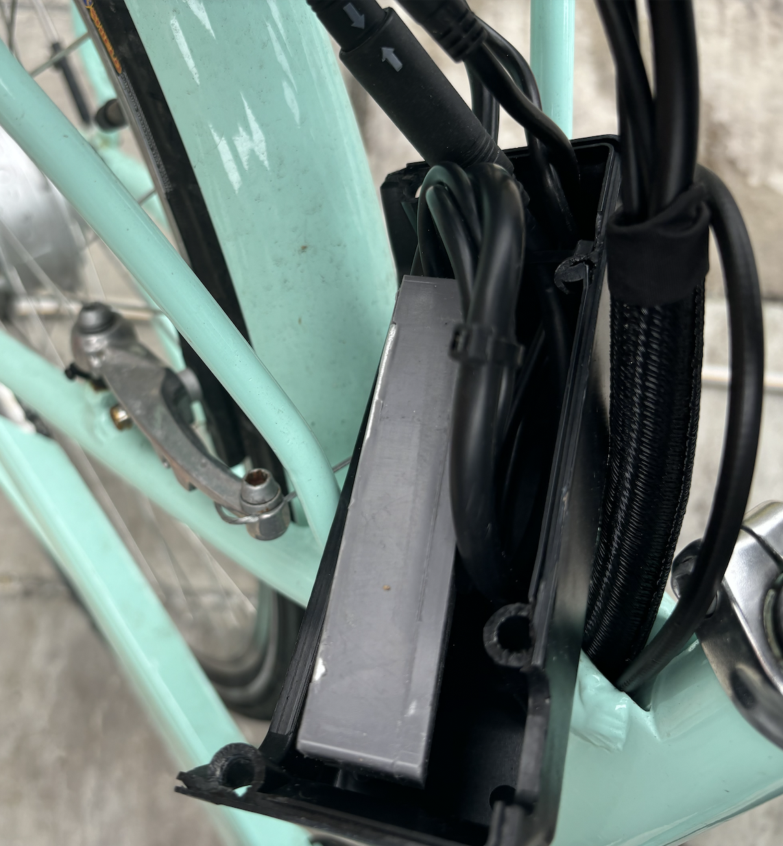

August 16, 20241 yr Had a look at your controller pic attachment, it shows the motor phase/Hall connection. Though the two parts align to the arrows they look to be 1.5mm - 2mm shy of being fully pushed home, this small amount can make a difference in the phase /Hall wire connection.
August 16, 20241 yr With all those screws broken through, the battery can move, which is causing connection issues. You need to hold everything more securely to the rack - straps, large cable-ties or something similar. Also, you need to slow down over speed bumps, especially the short plastic ones, or ride around them. The ones at our Asda would wreck any battery. Nobody can help you physically, nor advise you where to go unless you say where you are!
August 21, 20241 yr Author I am puzzled about why the battery casing failure happened like this. Has someone abused the casing, or has it been dropped? It does not look at all like normal wear and tear to me. The Pendleton Summersby battery is quite well supported in its rack, so there should not be heavy forces around those casing screws, even bumping over sleeping policemen in the road. Obviously you want to go slowly over them for the sake of the wheels, forks, frame and everything else. It isn't old enough for the plastic to have degenerated. Honestly, it is so puzzling, especially as all the screws have done it - not just one or two? What do you mean by abuse of the casing? I don’t think the casing can be dropped? Maybe it has been caused by the few times I have put the bike on it’s seat and handles to fix chain issues? But honestly, a bike should be able to handle that? It has had panniers on but nothing heavyweight.
August 21, 20241 yr Author With all those screws broken through, the battery can move, which is causing connection issues. You need to hold everything more securely to the rack - straps, large cable-ties or something similar. Also, you need to slow down over speed bumps, especially the short plastic ones, or ride around them. The ones at our Asda would wreck any battery. Nobody can help you physically, nor advise you where to go unless you say where you are! I was considering electrical tapping everything together as a short term fix, but I could actually zip tie through the holes the casing has as a result of the rotten screw holes, maybe?
August 21, 20241 yr Author With all those screws broken through, the battery can move, which is causing connection issues. You need to hold everything more securely to the rack - straps, large cable-ties or something similar. Also, you need to slow down over speed bumps, especially the short plastic ones, or ride around them. The ones at our Asda would wreck any battery. Nobody can help you physically, nor advise you where to go unless you say where you are! Yes, I have never pedalled over speed bumps when I’ve had to cycle over them, as I usually cycle with a takeaway coffee style cup I am not about the high speed ride, I am a ‘slow and in style’ rider
August 21, 20241 yr Author Had a look at your controller pic attachment, it shows the motor phase/Hall connection. Though the two parts align to the arrows they look to be 1.5mm - 2mm shy of being fully pushed home, this small amount can make a difference in the phase /Hall wire connection. Oh amazing thank you! I’m considering electrical taping up the whole lot and seeing if that holds.

August 21, 20241 yr Author The state of the battery case makes me wonder if the battery is loosing connection when bumped about, this may be evident if the battery connections show any spark or arcing damage?? and would result in post bump cut outs, similar issues in the past have been resolved with shims and wedges to secure a slid battery in a single position. Honestly, this makes sense. What doesn’t make sense is how the case could get like that, bad bunch of plastic in the Pendleton factory?

August 21, 20241 yr What is an LBS? Local Bike Shop. After first testing the plastic to see if it's melted by superglue - if the plastic doesn't melt I'd be inclined to try superglue + fine grain bicarbonate of soda. It sets as a hard plastic, and although I've repaired household objects with it, I haven't tried tapping a thread... but perhaps that's possible? It can be sanded, drilled etc. into shape. Superglue + graphite (sandpaper pencil lead) looks even stronger, I haven't needed to use that yet. Have acetone handy, to dissolve it off your fingers. The combination is the strongest glue I've ever used. Sets very fast. Edited August 21, 20241 yr by guerney
