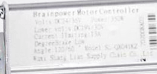

The controller says 350W.
Anyway, thanks for the reply, but there's no way I'm buying a new hub motor - I've thrown too much cash at this already!
Does the controller specify a maximum current ?
Controllers stating wattage is pure nonsense as it has no meaning , the importance is max current it can deliver.

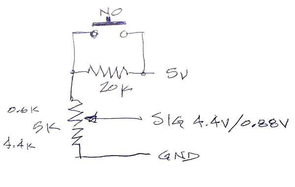

Using PAS, the rear dropout torque sensor voltage range is not right for the throttle input on the Brainpower. If I could demonstrate to my own satisfaction that the bike will function well, I'll invest some time in voltage translation, as I believe torque sensors feel more natural.
The PAS is working fine, though, as far as I can tell.

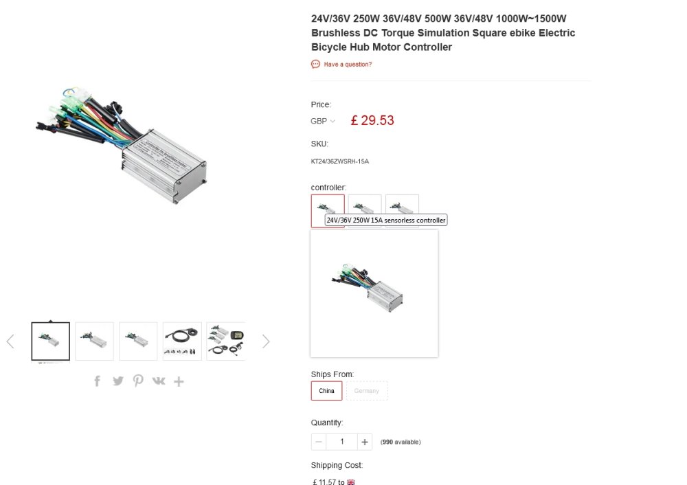

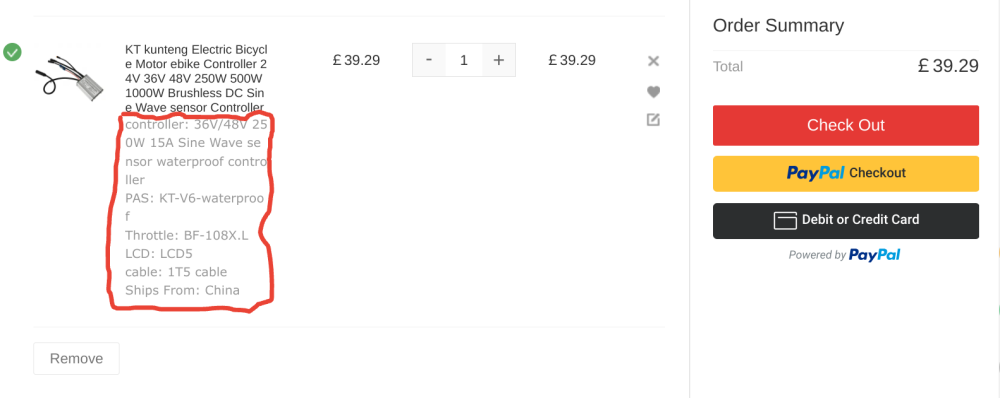

0.5km with average gradient of 4.2% so not really steep. Suggests your controller is way under powered. A KT 17A controller would get you up that at 15 mph withoutany actual effort from you.
