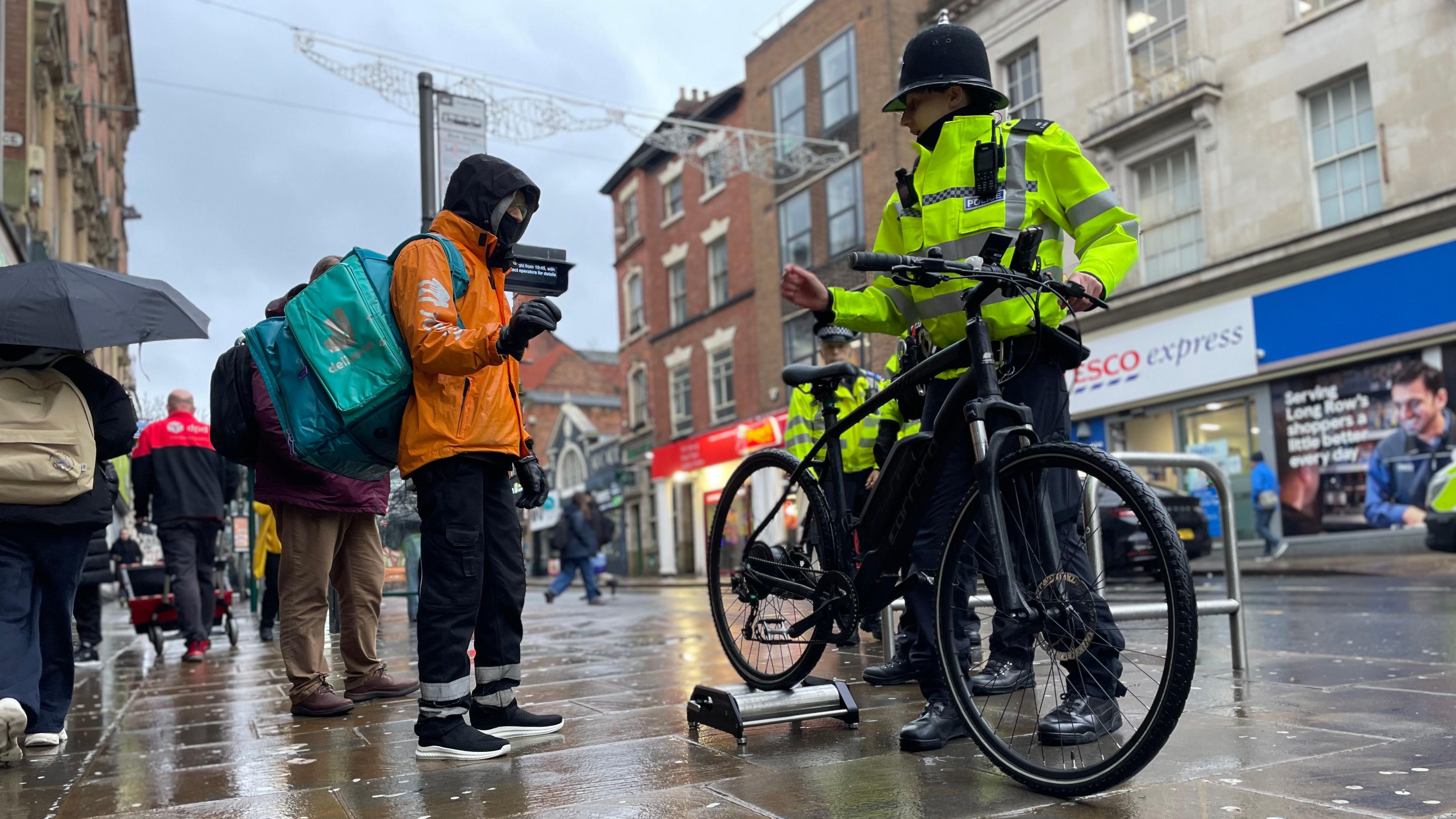

Sooooo...... orificers have some sort of new gizmo to test speed. Irritating, because presently in order to pass the no-load the rear wheel off the ground pedal assist speed test, I have to turn two wheel spoke speed sensor magnets around (three in total, at odd spoke angles), to make my 20" wheeled folding bike's BBS01B conversion's display never show faster than 23kph no matter what, which effectively de-resrticts and illegalises my currently legal bike in the process... but to pass this new rozzer gizmo test, I have to leave everything as is. Which test should I prepare my bike for? Prep to pass the more common first test takes about 20 seconds, to dismount and turn two spoke magnets around to face the speed sensor.
Portable tester helps crackdown on illegal e-bikes
https://www.bbc.co.uk/news/articles/cd7z8p1vnz1o.amp
Edited by guerney
Sooooo...... rozzers have some sort of new gizmo to test speed. Irritating, because presently in order to pass the no-load the rear wheel off the ground pedal assist speed test, I have to turn two wheel spoke speed sensor magnets around (three in total, at odd spoke angles), to make my 20" wheeled folding bike's BBS01B conversion's display never show faster than 23kph no matter what, which effectively de-resrticts and illegalises my currently legal bike in the process... but to pass this new rozzer gizmo test, I have to leave everything as is. Which test should I prepare my bike for? Prep to pass the more common first test takes about 20 seconds, to dismount and turn two spoke magnets around to face the speed sensor.
If they do the wheel in the air test, tell them it's not a reliable test. Put your finger on the rim to create some resistance and ask them to repeat the test.
If that roller device has some resistance, and it must have some, it should probably make a reasonable measurement. All it has to do is to overcome the initial inertia of the wheel spinning up which might momentarily take it above 25kph if there was no resistance, through the energy applied during acceleration. Once that is over the question is simple - Is the motor still operating above 25 KPH?
At first I wondered about where the police were reading the speed, which is not clear from the photo pasted, but google found this picture on the Notts Police facebook page.
There is absolutely no defence in a case like that shown in the picture above. 38KPH is well outside any sensible argument, as long as the rolling road device has been properly calibrated. Since it looks like a well made Swiss device, I'd say the guy shown in the video below, with a full speed throttle, and a great big dinner plate motor which drives the wheel to over 60KPH, is banged to rights.
https://www.facebook.com/video.php?v=857692997021951
The Neighbourhood policing sergeant was well up to speed himself, but the young lad policeman going through a checklist was talking rubbish when he said one of the check items was, 'Does the battery supply more than 250 watts?'. Rubbish. Still there are abundant cases where police have no clue about these matters.
No mention of the +10% tolerance allowed, which brings it to 17.2 mph limit for illegality. Apart from that, they were spinning up the motors with independent throttles, so there was no need to check the speed.

I thought the fact that the Wenger machine is marked with a 30KPH label suggested they were not being unreasonable about the cut off speed.
I looked up the manufacturer's publicity on the device. I wouldn't be unhappy to have either of my e-bikes tested on that. It is a proper bit of kit.
Check out the website.
https://www.wenger-geschwindigkeitspruefrolle.ch/en/
From the manufacturer'e website:
Intended use
The E-Speed Control device is not a speed measuring device and is only used to detect suspected violations.
Suspicion means: The vehicle has been manipulated or does not comply with the law.
If manipulation or non-compliance is suspected, the maximum possible speed of the vehicle can be determined on a speed test track (e.g., road traffic authority) or with a standard speed measuring device (e.g., radar), depending on the prescribed procedure.
The E-Speed Control device only measures the maximum wheel speed of the vehicle, which may or may not correspond to the maximum possible speed of the vehicle, as air and rolling resistance cannot be taken into account with this measurement method.
Air and rolling resistance, and thus the braking effect of the vehicle, depend on various factors and can vary greatly depending on the driver (tall, short, light, heavy), vehicle type (electric, gasoline), transmission type (1-speed, variator, multi-speed transmission), max. engine power, max. drive torque, headwind, etc.
Therefore, only the maximum possible theoretical vehicle speed can be measured indirectly via the wheel speed.
The E-Speed Control device is calibrated by the Swiss calibration authority METAS and has a test certificate.

I still don't understand the objections to the free air speed test: the motor has to stop assisting at 25 kph regardless of air and road resistance, so any persistent overspeed allowing for initial underdamped response to throttle is non-compliant.

You're making it more complicated than it is. We've explained this hundreds of times. The motor must be RATED at 250w or less. There is no law that limits charging power, size of battery, power taken from the battery or power produced by the motor.

Calibration is not enough. To be a suitable measuring device, they would have to do repeatability and reproduceability test on the meausuring device that showed +/- 4 standard deviations of variation are less than 0.25km/hr. This would only be an argument if the device showed that you were just above the 27.5 km/hr maximum.
Was that directed at me or [mention=34503]matthewslack[/mention]?
I doubt accurate calculation of speed of a driven wheel rotating in the air was part of Bafang's design brief. What matters is speed in use on the road. Behold in wonder at how fast my bike cuts off at 25kph in use ON THE ROAD (1min 12 seconds onwards) uphill. Works just as fast on flat road.
