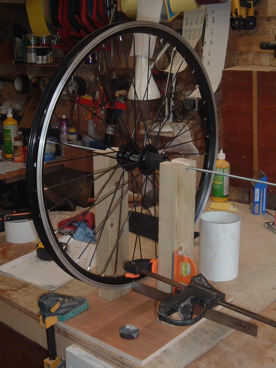

In the mean time here's a photo of my scratch built wheel truing stand in case it helps anyone else. Used it to build the replacement wheel for the recumbent.DSCF3422.thumb.JPG.7e81fcbbd7ca3f4b502a307388f54b25.JPG

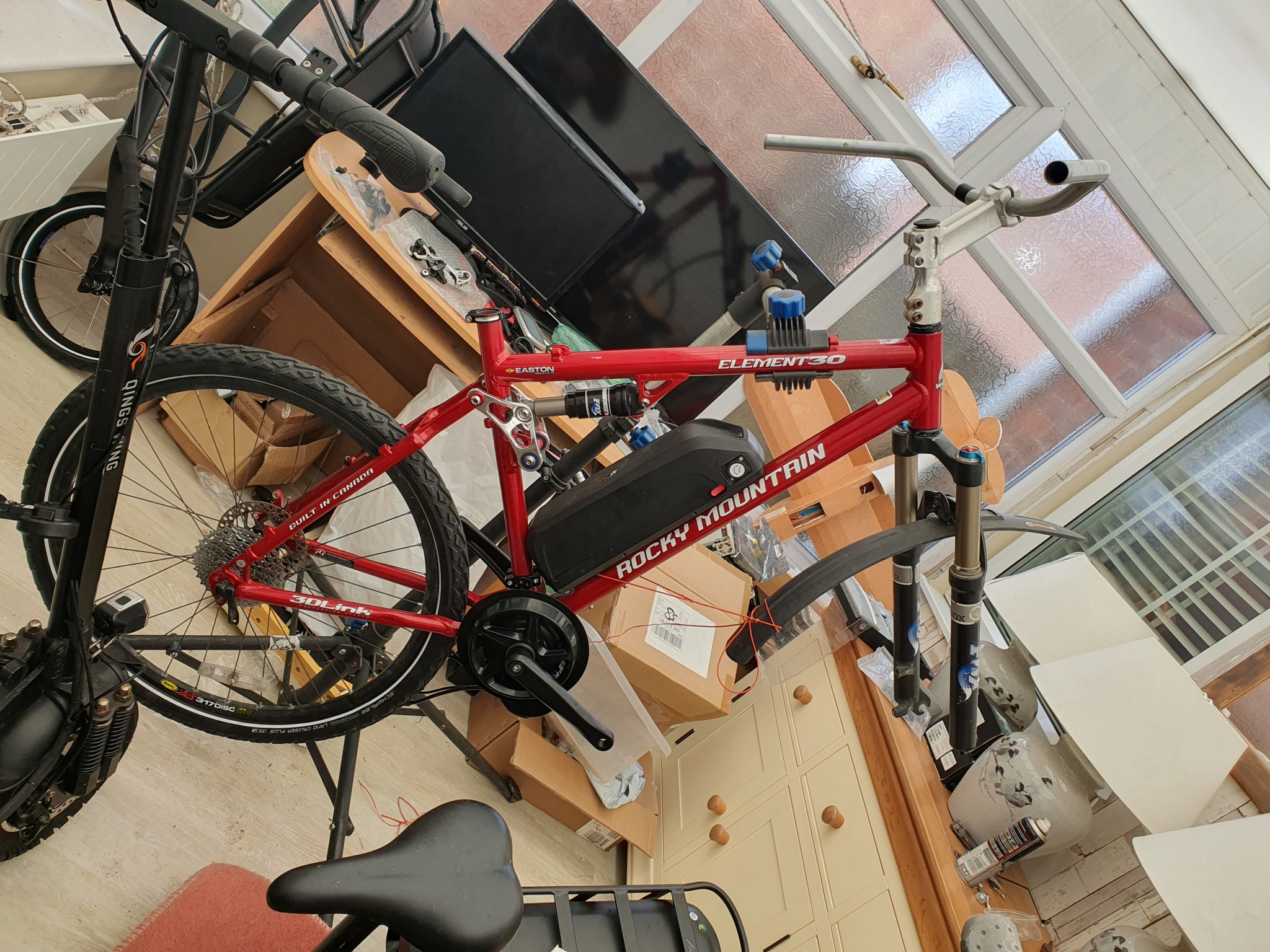

Here you go. It's worth buying just for the forks and still worth the drive down there to get it, though it looks like a pretty good bike for conversion. I have three of these now; one with a Q128, shortly to be changed to a 48v MXUS, just to see what It's like; one has a 48v TSDZ2; and the third has a 48v TSDZ8.

Having just been shopping, I've had second and third thoughts. Despite the Rocky Mountain being a much revered bike, I realise I need a hard tail so I can use my panniers and my 36v rack battery which still has a lot of use in it.

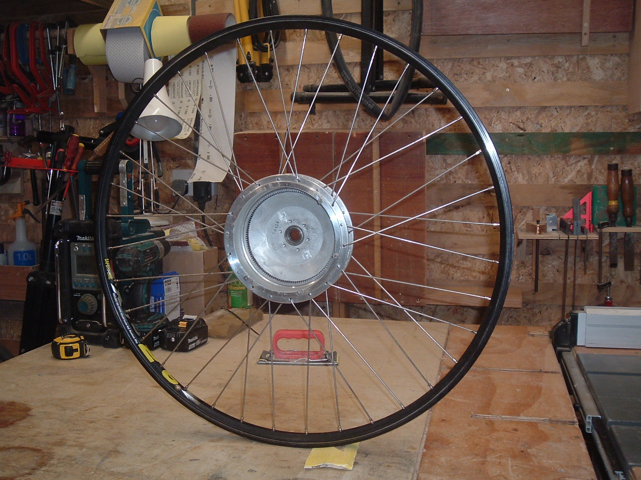

Well tight wad has won out, so I've decided to go with what I've got.
First was scavenging the rim from a defunct Ezee motor case:

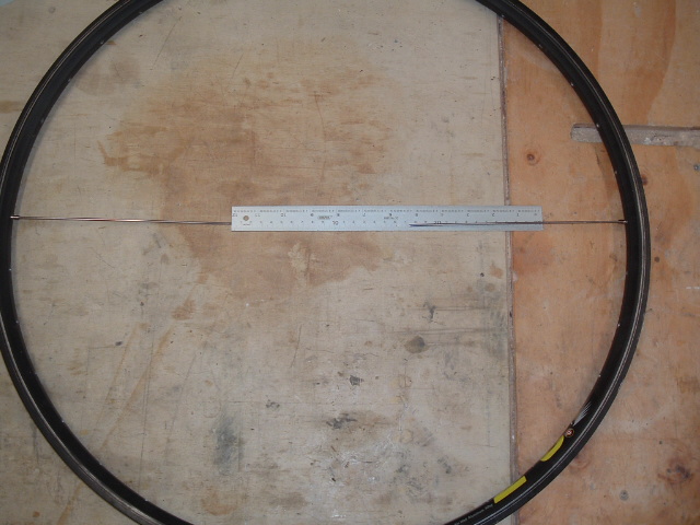

Having removed the spokes I've used the Ryan method of finding the ERD. I tightened nipples onto two old spokes so they would not move. Cut off the j bend and cut and file the spokes to the same length. In this case215mm. Insert the spokes into opposite holes and measure between the two ends, 172mm. Then add the lot together to get ERD, 215+215+172= 602.
[ATTACH=full]63359[/ATTACH]
[ATTACH=full]63360[/ATTACH]

That's a lot of work to get a simple measurement. I just measure the diameter in two directions and add 5mm.
"Having removed the spokes I've used the Ryan method of finding the ERD. "
I like that method. I have some straight spokes that I bought by mistake. Would be a good use for them.
On my last wheel, I used the ERD on the seller's website. Normally, I don't mind if they are a bit long, because I use double wall rims and can add washers too. These .
spokes were so long, they poked past the upper wall.
Well there ya go. Experience wins out. Sometimes you've just gotta do it the hard way to see the easy way !
