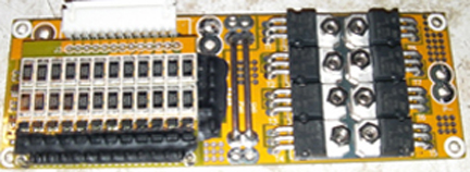

I later purchased a spare bms for £29.00 inclusive of post although I have no reason to believe I'll ever need it.

The BMS is not inside the battery covering but is connected to wires that come out from the battery, if you are running a 250Watt motor then binding them to the battery with gaffer tape or similar should be fine but in my case when running the Aurora on throttle only up and down hills has a fair draw on power and the BMS can start to get warm so mine has been left just tucked down the side of the battery in the pannier where it can breath.

There is just a small amount of warmth in the BMS near the end of charging( nothing serious) but the battery stays cold throughout)
