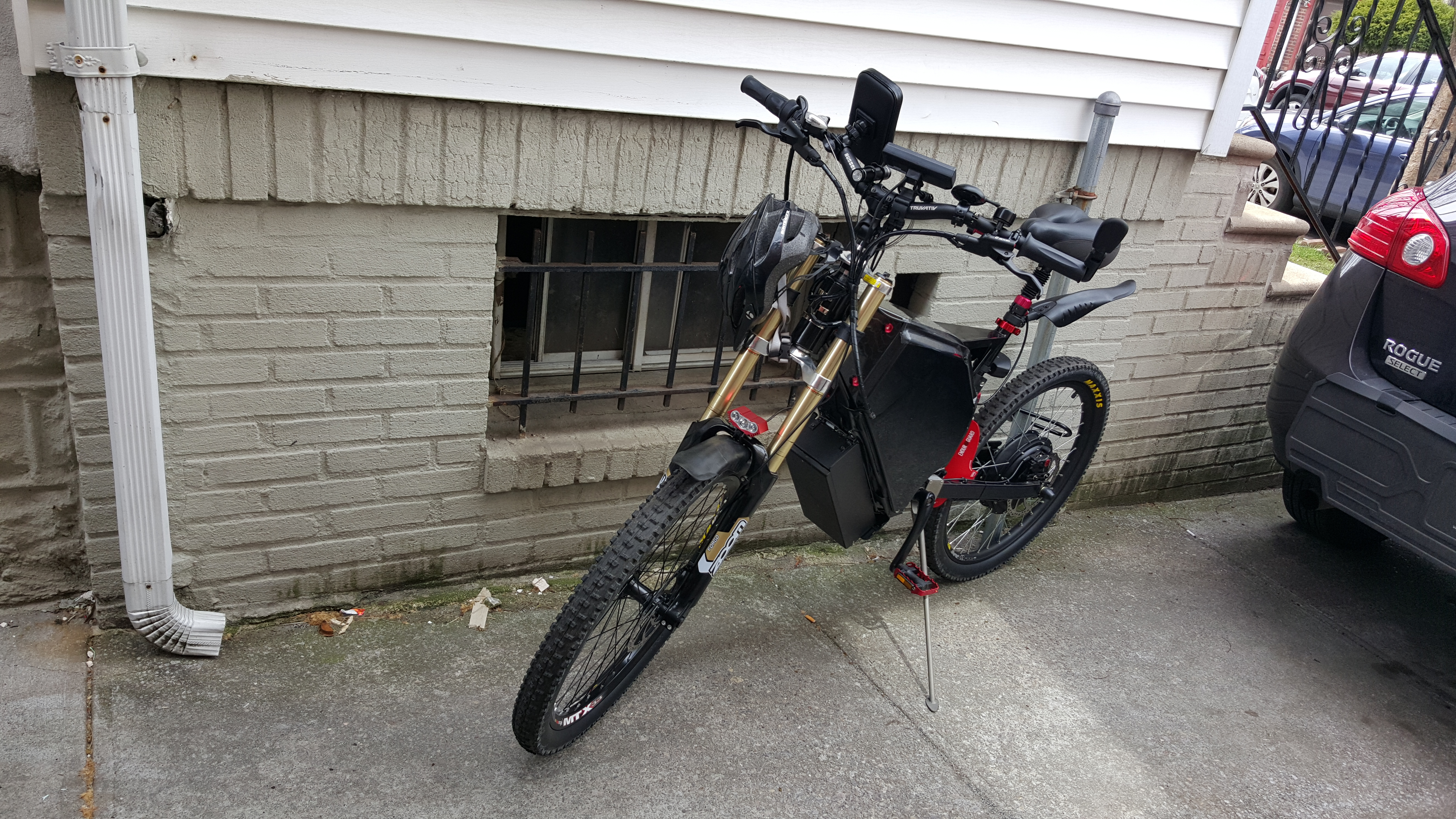

I live in Brooklyn NY for the last few years, and over here (NY State law,) all Ebikes are ILLEGAL!! doesn't mean I don't have a bunch OR have stopped riding around. Instead I try to ride safely, stay off the pavement (sidewalks they call it here ;) and I nearly typed that accidentally lol.) I stay under 25mph (NYC speed limit): on ALL my bikes when on the roads (OK when I see cops ;p) There is Ebike insurance over here that one can get, but having it here is irrelevant to confiscation for illegality. In states with more liberal laws there is still a state v federal ebike law standoff because of the power definitions, but folks in Cali can have a 1000w nom motor and still not need any licence or insurance! sometimes I wonder why I'm still here in NY, coz if you're gonna leave blighty anyway, may as well have gone somewhere warm ;)

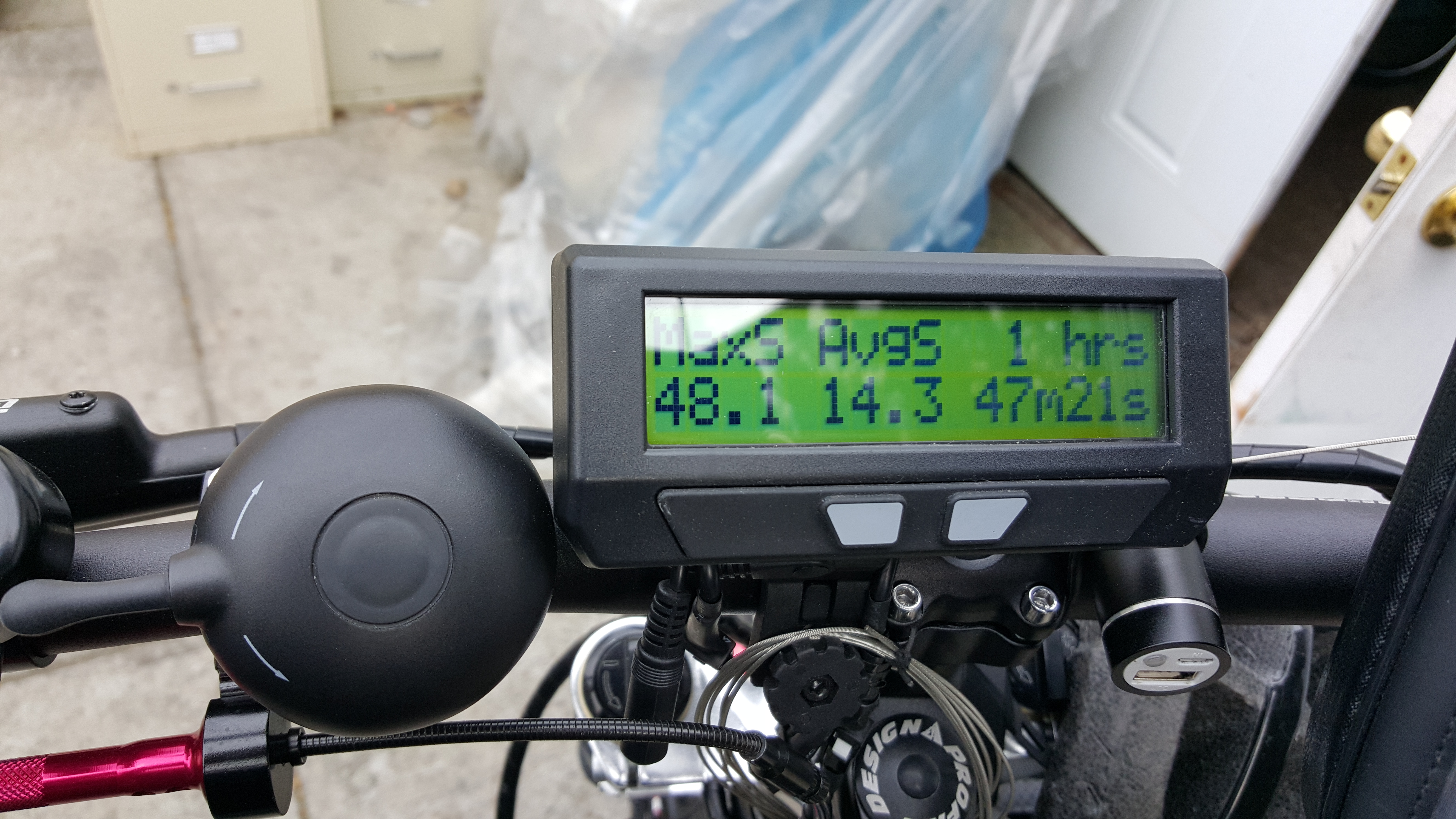

I built myself a multi Kw bike (cost about $4000 in parts) YES it has peddles! a rear 7sp derailleur too lol as well as an 8 magnet pedelec sensor (Yes, it has a half twist and seperate 3sp too lol) but I'm not deluding myself that it's even a Speed pedelec, because it isn't! If I'm honest it's a light e motorcycle built with bike parts for weight. Federal law in the US allows a grey area for inventors to operate and that's what I'm using. So far, so good, in it's testing but I've not exceeded 25mph despite pulling over 4000w on acceleration getting there :) Cars can't keep up lol unlike my turn key bikes which can do 25mph too, but accelerate about as fast as peddling.

lol my battery IS 19 kilo! (lifepo4 is heavy) but the motor is only a 1500w nominal (4500+ peak) leafmotor, and I used All bike parts, so @under 45kilo it's not a motorbike either. Also, at under 40wh/mile (no peddling,) according to my CAv3 my 24s 30ah battery has 2.3 kwh in the pack, and will go waaay more than only 10km!!

No, I'd say it's the pathetic 'torque' I hated most about low power ebikes/pedelecs, and wanted to fix first, since at traffic lights I felt too slow 'off the mark,' and at a crazy impatient drivers mercy :(
So I endeavoured to build my own from scratch, rather than rely on an Ebike manufacturer speccing it 4 me.
However since it was Me that decided the specs, I "may," have gone a lil overboard with the power on it.
My plan was to peel and restick the 250w 36v bafang hubmotor stickers, on to the 1500w nominal, leafmotors case, just above my 7sp derailleur, in case an official visually looked to check...) I installed a 3sp switch on my CAV3, to control power levels 'on the fly,' but even @28a continuous on the lowest setting @80v is approx 2kw, it goes over 40 mph! Never mind settings 2 or 3!! (I Went 61 mph max during testing stage, over 90mph with no load ;) so even with stickers saying different, I don't think that would fool the cops in any way.
Perhaps if I was Dutch instead of English I wouldn't have been tempted to build it! As it is, (@least 4 now) I'm very grateful that I am. Imo, in certain traffic situations, being too slow is much more dangerous than being able to keep up with the traffic, even if that happens to be over 15.5mph.
