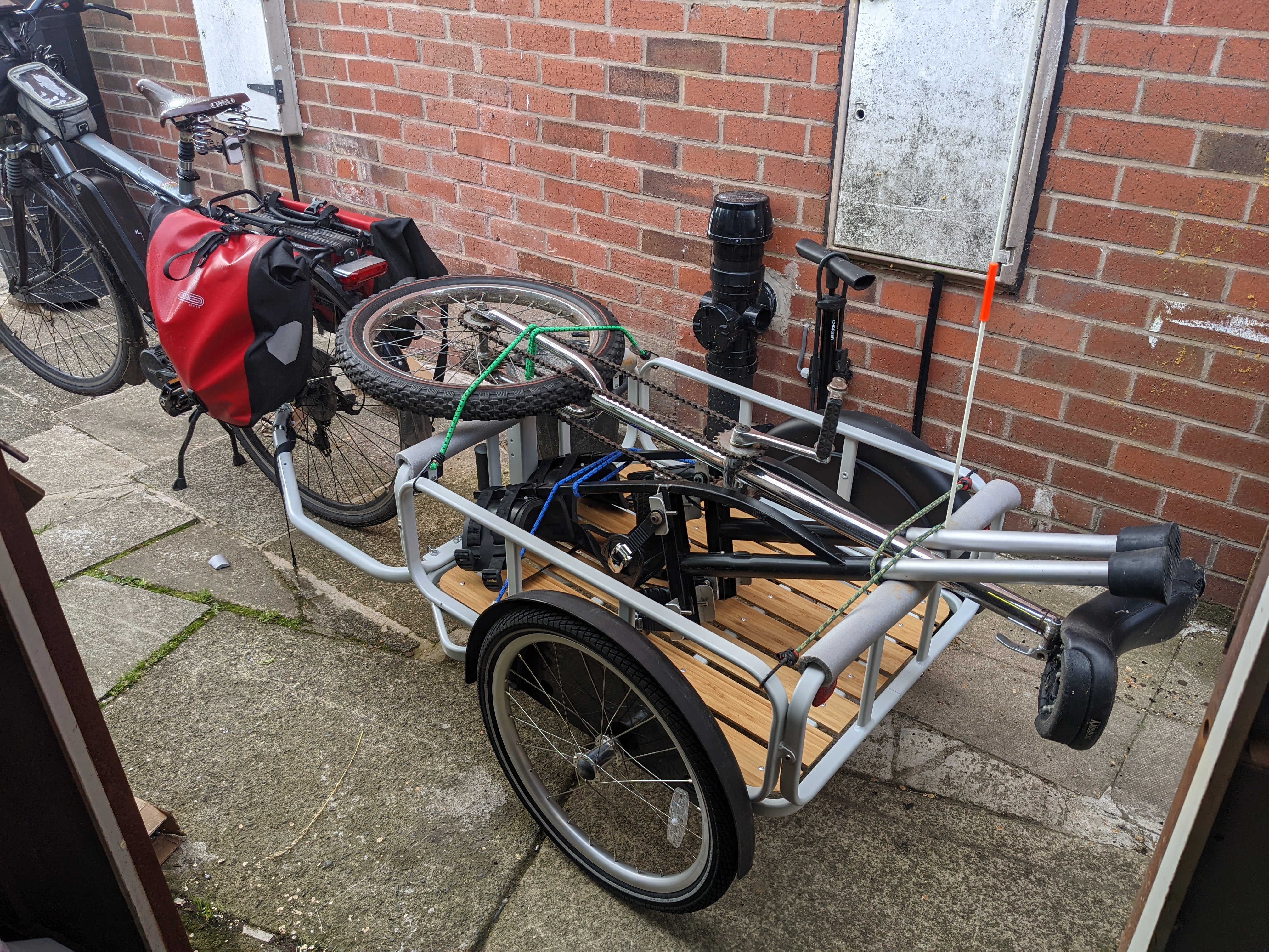

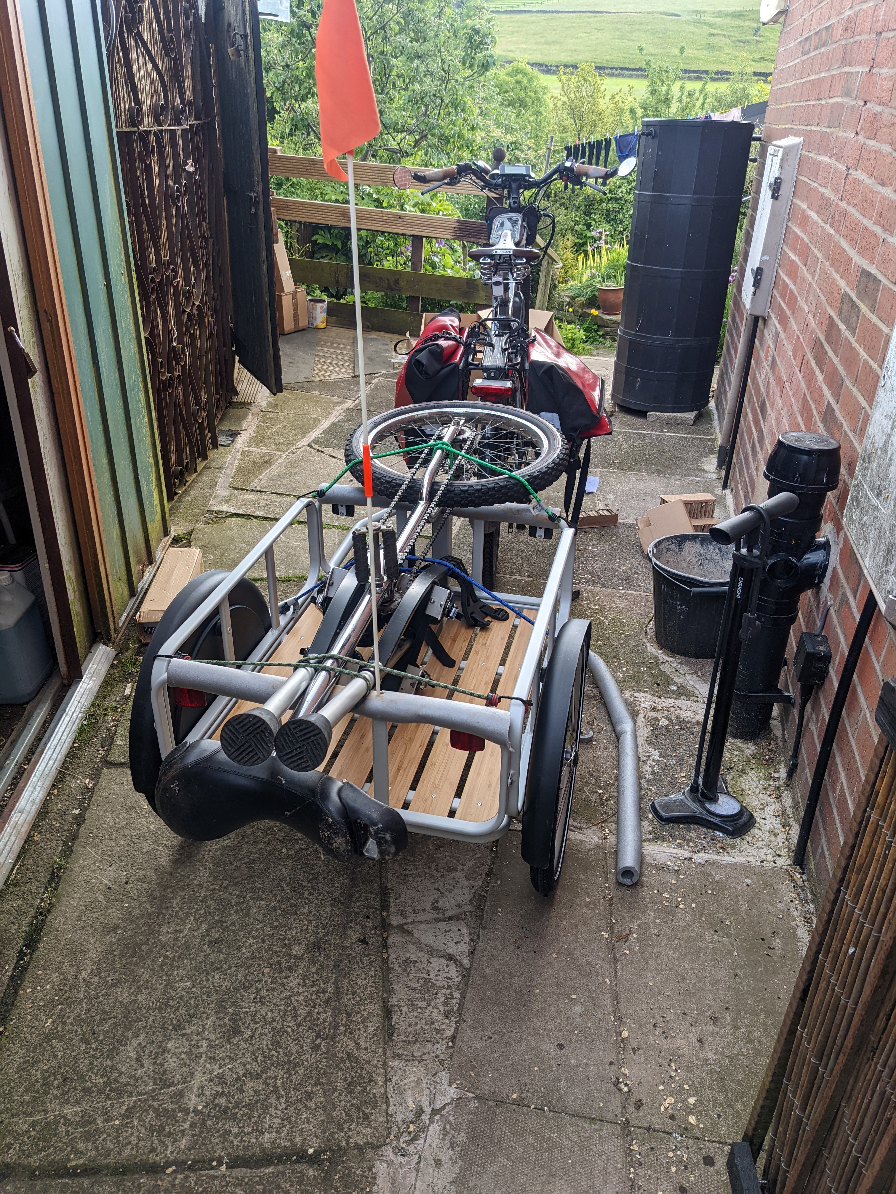

Then a bit of an oddball turned up in the similar items eBay notification. An Ikea Sledda, powder coated Ali, Ali wheels, Bamboo slats, originally made to complement the IKEA Sledda belt drive sbike, now discontinued.
Got it for £110, arrived brand new in box, just assembled, it's a cracker. Towbar converts to a handle to wheel it around.
It's loaded with a 5ft unicycle and 1m stilts for tonight's trip, now without the car!
It looks a well designed trailer at a very good price. I especially like that it has mudguards built in - prevents mud splashes over cargo, and it has a good number of supporting struts for the bamboo slats. At 11kg it's pretty light considering - says here it's a steel alloy, which explains why it's 4.4kg lighter than my similar-ish but not nearly as nice looking Homcom steel framed trailer, despite the Sladda having larger wheels. The bike it was supposed to have been originally sold with, was recalled because of a safety issue related to a third party belt drive, but the trailers are a good design.

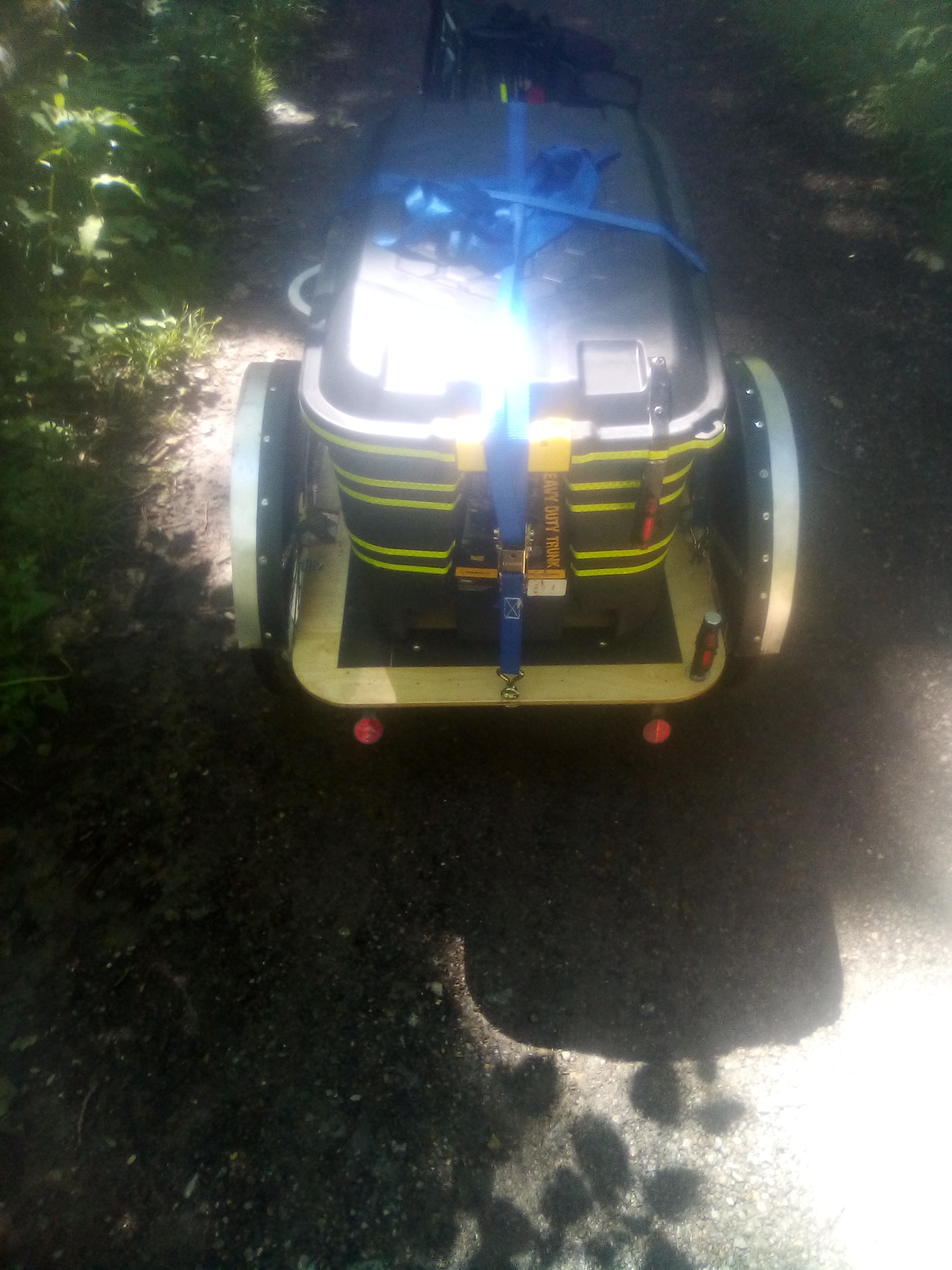

I spent £3.25 on a roll of 10mm reflective diamond tape to improve the visibility of my box for the trailer.

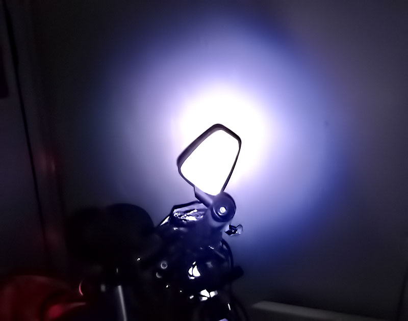

That stuff is brilliant, especially in car headlights - I've stuck patches of it on all the black parts of my otherwise silver bike (handlebar stem, on the reverse sides of both Zefal Dooback 2 handlebar-end mirrors, parts of the rear pannier rack). Well worth being as visible as possible, especially since it doesnt cost very much. Had to try a couple of types till I found a truly waterproof reflective tape - one so called "Waterproof" reflective tape variety even had a paper layer, useless..

I don't know how WP the roll I got is but is is plenty sticky for sure. On the lid I taped it the whole way around so it can be seen from all angles and just added the few extra horizontal strips on the rear. For dull days I have the two rear flashing lights as well as the front and rear reflectors to be legal compliant.

The tapes did vary in terms of stickiness too, but I eventually found some which sticks fast and is reflective enough. Here is the reverse side of one of my Zefals, which drivers see... but only if they're heading towards me.

The rear lights are cheap ebay usb ones, I charge them and they last for weeks on end.
The baseboard light holder I made from bits out of my spares bin.

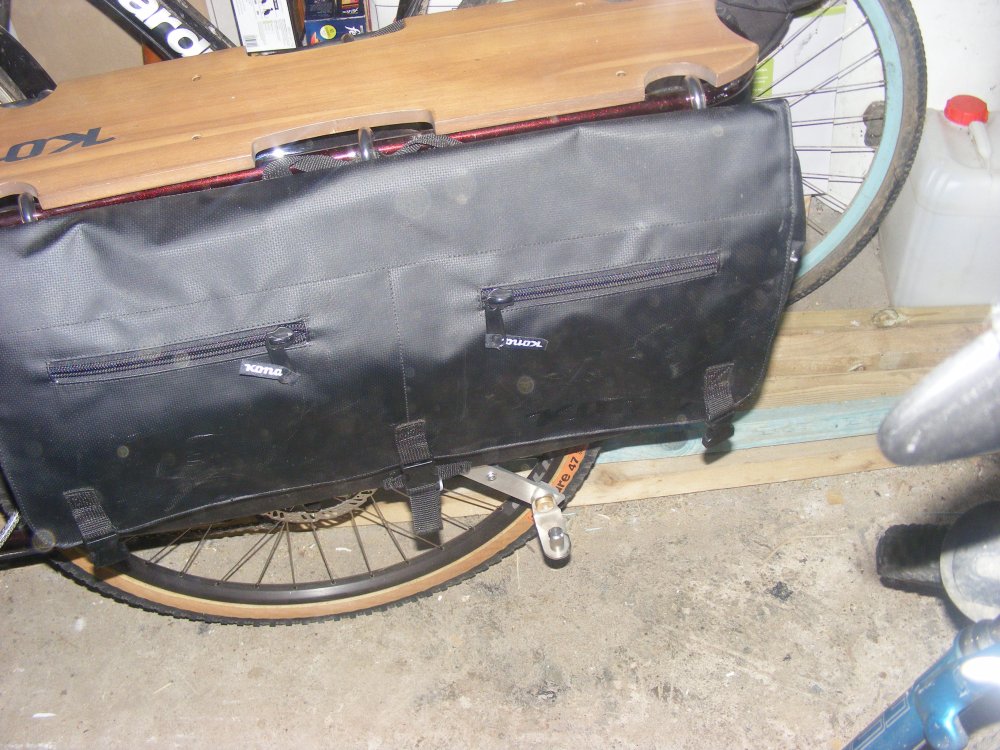

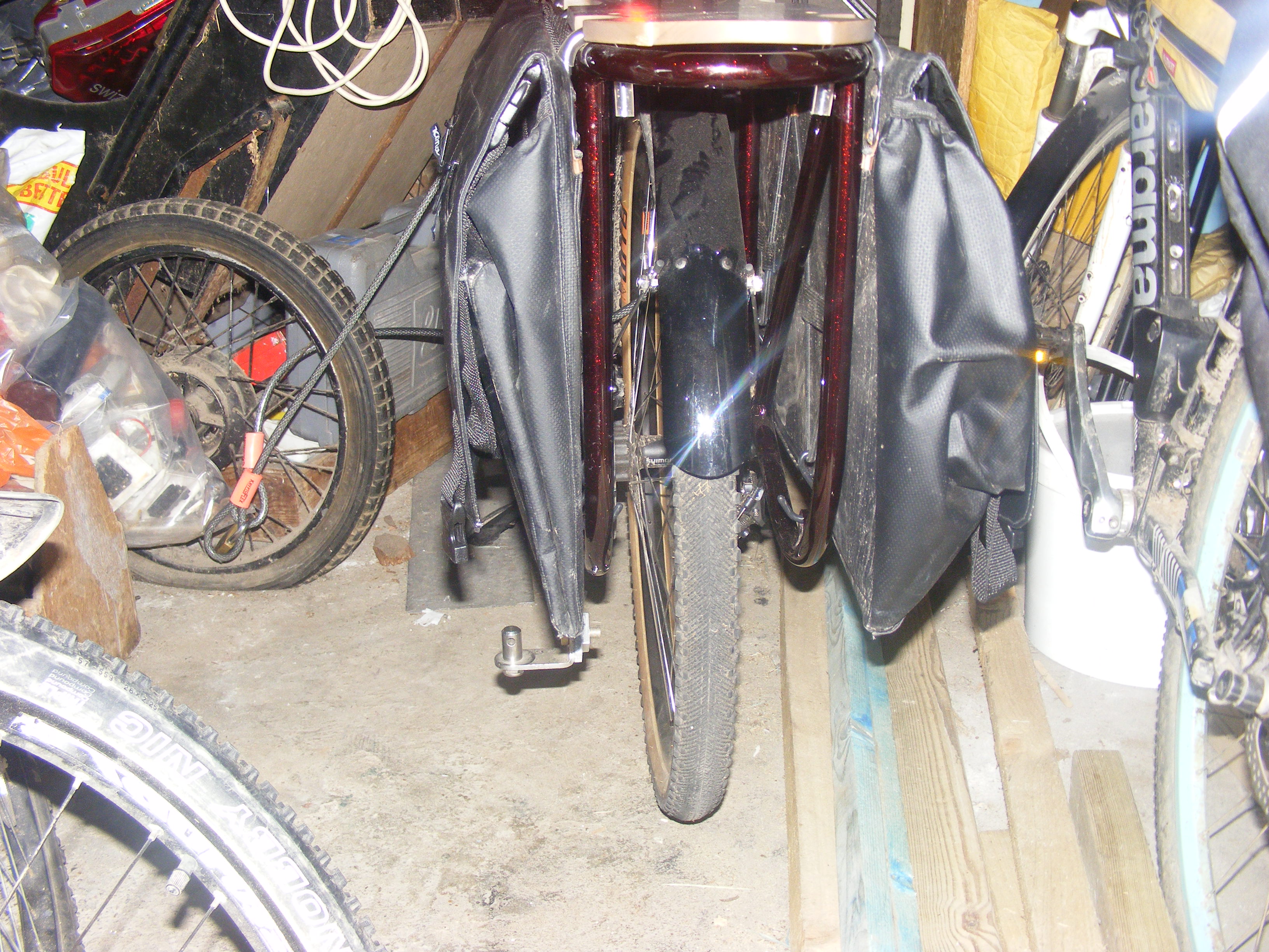

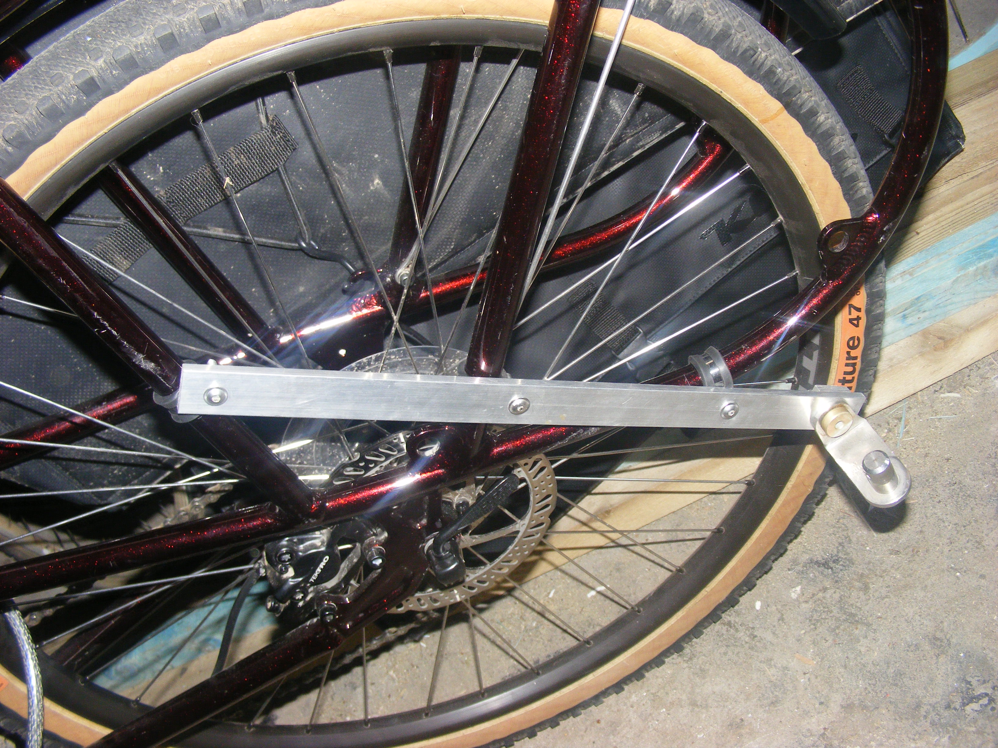

The other day I realised with my modded trailer and the extra frame work of the long tail ute, I would have an issue connecting the tow arm as well as straining the QR with all the towing weight.
So I put my heath robinson thinking cap on to come up with a solution I think will work by adding a new towing hitch.
400mm of 25mm x 6mm aluminium & 3 x 18mm P clips and 3 x nuts and bolts to sturdily tie the ali bar to the bike frame in three places, the combined tie points should be strong enough to spread the pull load on the bike frame rather then just using the axle alone.
My heath attachment of the bar puts the tow hitch much further back and easier to hook up the trailer. The three P clips giving a good secure anchor to three points on the rear frame.
With the panniers fitted most of it is hidden.
The rear looking view shows little, also by adding the bar for the hitch attachment I was able to lower the hitch beneath the axle so it is at a height to suit the trailers 20" wheel better. This allow a more level sitting trailer rather then one slightly pitch up at the front.
Edited by Nealh
