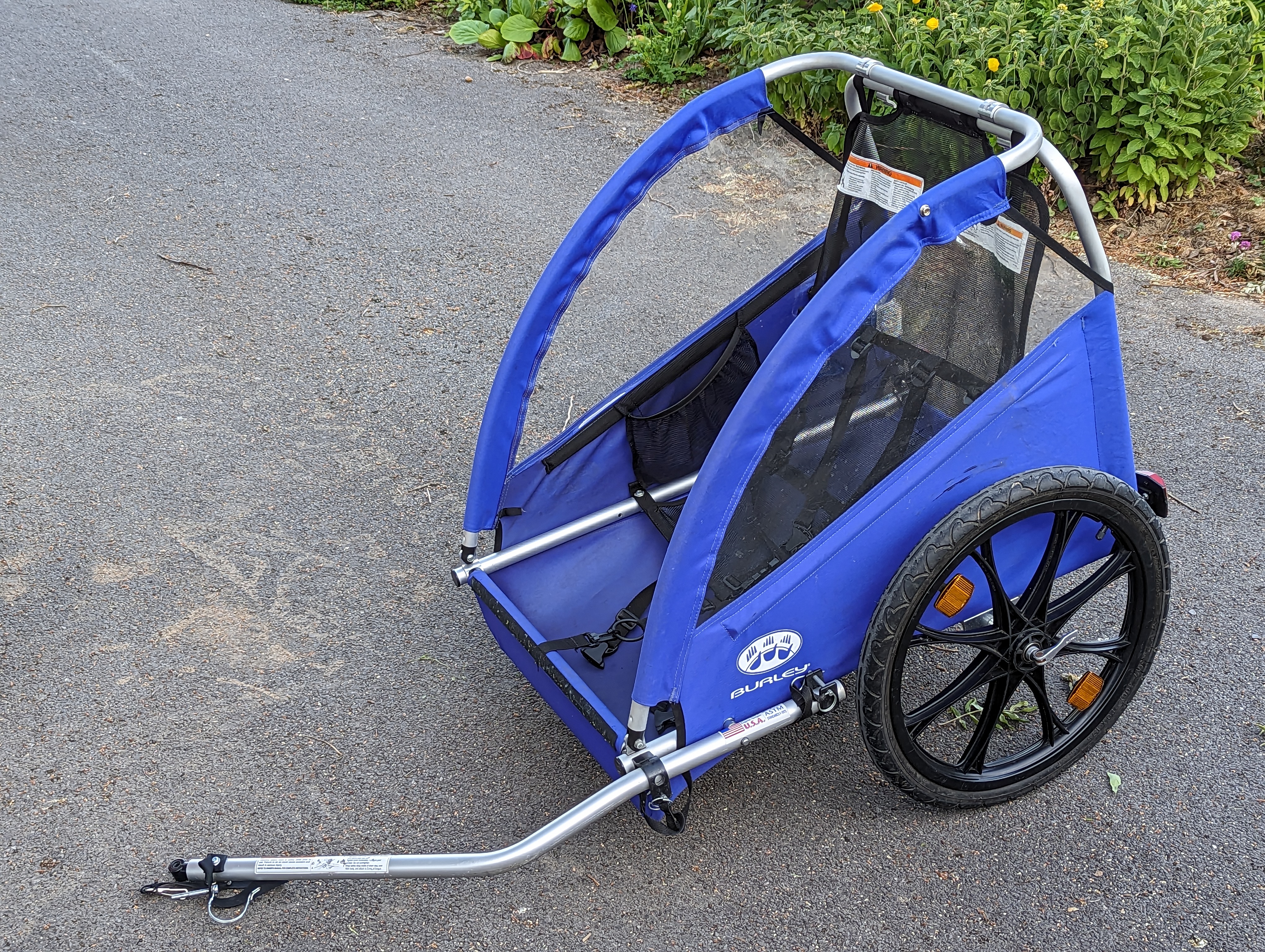

June 1, 20232 yr I have just purchased a used Burley kids trailer for use as a cargo trailer, mainly to lug caving kit around. I was going to remove the canvas and top cage and add a rigid base. It's only rated for 45kg load but that's ample for my needs. But then I got to thinking the kids trailer canvas, the flag, the baby on board sticker might mean I am given more room on the road? Of course people might be wondering what I am doing cycling young kids about at midnight as I make my way home from the obligatory post caving pub visit? I can hopefully modify the trailer with just additions so I can always put it back as a kids trailer if I decide to move it on at some point - without losing and money. Of course a carry freedom would have been more suitable but not worth it for me new. Could not find much used either. The Burley should be better put together than the budget cargo trailers - most of which have very nasty steel wheels with terrible bearings or bushes. Not sure I will use it for the supermarket run, certainly without fitting a smaller chainring, as I have a big hill. Have also bought a new chainring to test chainline for a double chainring tsdz2 setup... Edited June 1, 20232 yr by Bogmonster666
June 3, 20232 yr Not sure I will use it for the supermarket run, certainly without fitting a smaller chainring, as I have a big hill. Have also bought a new chainring to test chainline for a double chainring tsdz2 setup... Which trailer have you bought exactly? Does your Burley have suspension? Will you need the [mention=9614]Nealh[/mention] 's TSDZ2 heat mod, to tackle hill hauls? Edited June 4, 20232 yr by guerney
June 4, 20232 yr It's a Burley Bee. No suspension and quite an old version but looks in very good condition. Picking it up tomorrow as been away for the weekend playing. Mostly it will be used to get to the local caving huts and there are no real hills to those as they are on top the hill and I live in top the hill, and I won't be carting much weight. Particularly after digging trips in caves your equipment is often completely caked in mud and slop to an extent that is difficult to comprehend. Being able to dump it in a big trug and then onto a trailer is so much more convenient than trying to pack it all in panniers as everything else get caked in crap as well and it takes time packing bags = less time in the pub. The trailer is 8.5 kg, by the time I have stripped off the stuff I don't want and added a light base it's probably not much more than 10kg. The caving kit is probably only about 10kg so that should be very easy to tow. It's only personal kit as the heavy stuff like ropes and ladders are at the huts. I'm already aiming to lower the gearing and doing a bit of a thermal mod. Probably a dual 34t / 42t chainring with ~30t at the back. The 42 flat chainring is in the post, once I check the chainline, assuming it's ok I'll order a new front derailleur, small chainring and some thermal pads. I think it would be very rare I'll be doing a supermarket run with the trailer, my wife will do the big shop with the car, I just do small shops in-between and panniers are fine for that. The trailer is just for speed and convenience rather than heavy load carying, but I would find cheap squeaky wheels very annoying. The early Bees only have composite wheels so not sure how string but they can't be too feeble to safely a carry 100lb load of small children which are much more fragile then the stuff I'll be carrying. The wheels do have proper bearings in them.

June 5, 20232 yr Looks like it could be the basis for a good lightweight cargo trailer. It's old but in very good condition. Will have to think how to convert but it should be an easy job.
June 5, 20232 yr It's a Burley Bee. No suspension and quite an old version but looks in very good condition. Picking it up tomorrow as been away for the weekend playing. Mostly it will be used to get to the local caving huts and there are no real hills to those as they are on top the hill and I live in top the hill, and I won't be carting much weight. Particularly after digging trips in caves your equipment is often completely caked in mud and slop to an extent that is difficult to comprehend. Being able to dump it in a big trug and then onto a trailer is so much more convenient than trying to pack it all in panniers as everything else get caked in crap as well and it takes time packing bags = less time in the pub. The trailer is 8.5 kg, by the time I have stripped off the stuff I don't want and added a light base it's probably not much more than 10kg. The caving kit is probably only about 10kg so that should be very easy to tow. It's only personal kit as the heavy stuff like ropes and ladders are at the huts. I'm already aiming to lower the gearing and doing a bit of a thermal mod. Probably a dual 34t / 42t chainring with ~30t at the back. The 42 flat chainring is in the post, once I check the chainline, assuming it's ok I'll order a new front derailleur, small chainring and some thermal pads. I think it would be very rare I'll be doing a supermarket run with the trailer, my wife will do the big shop with the car, I just do small shops in-between and panniers are fine for that. The trailer is just for speed and convenience rather than heavy load carying, but I would find cheap squeaky wheels very annoying. The early Bees only have composite wheels so not sure how string but they can't be too feeble to safely a carry 100lb load of small children which are much more fragile then the stuff I'll be carrying. The wheels do have proper bearings in them. Digging trips, pub afterwards, caving huts. That does take me back. Also going on rescues, got back from a rescue in the early hours of the morningall my mucky gear was in a black bin bag, pre wheely bin days, I left my gear by the bin in our yard. Next day it was nowhere to be seen. The bin men had taken it all my SRT gear lamp helmet petzyl suit all gone. I was devasted. Next day one of the bin men brought it back they realised it wasn't rubbish and had put it in the cab, but couldn't remember which house it had come from. Happy days

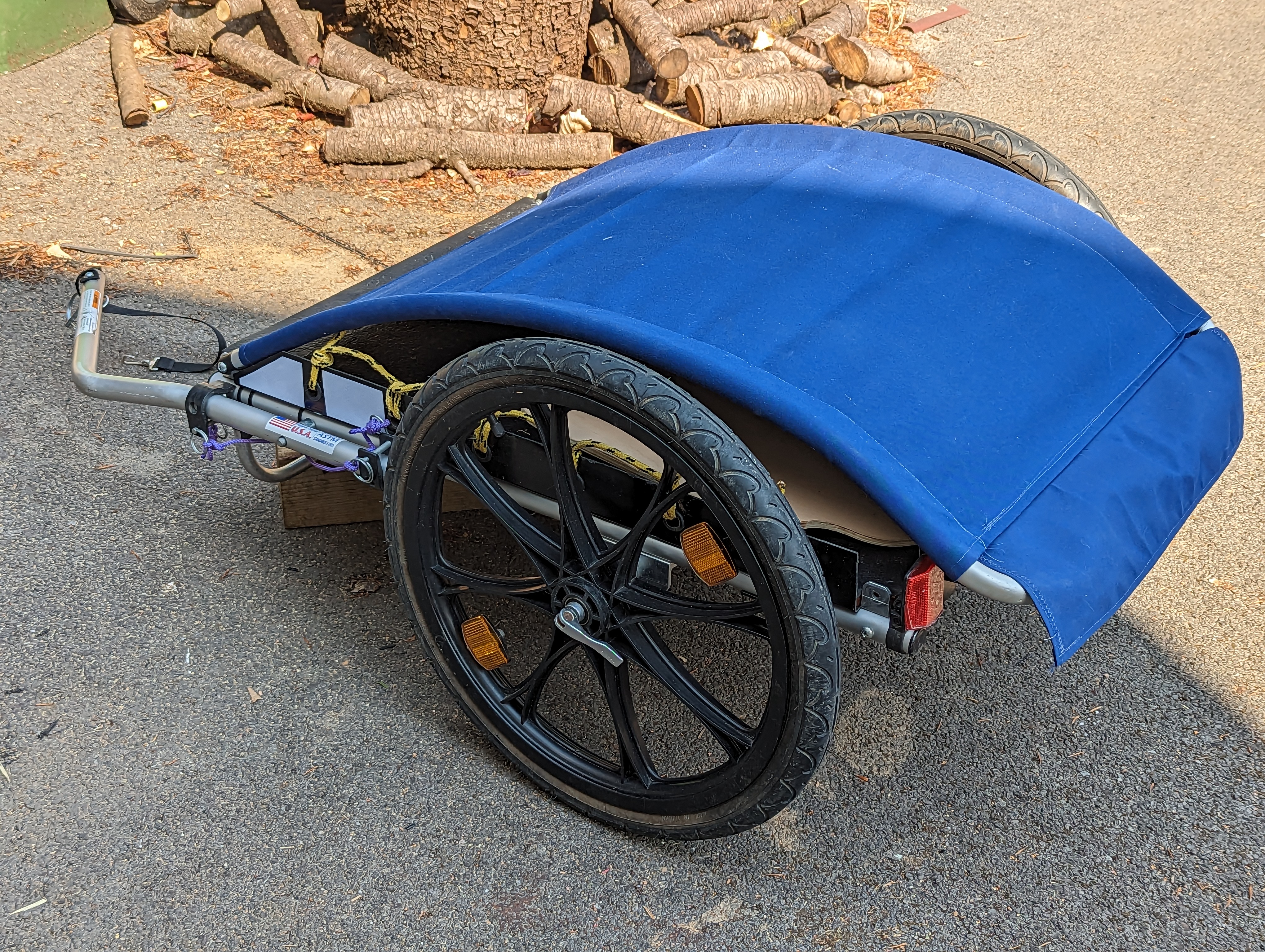

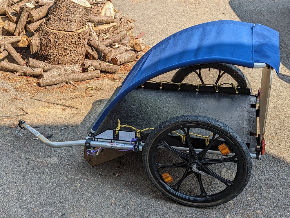

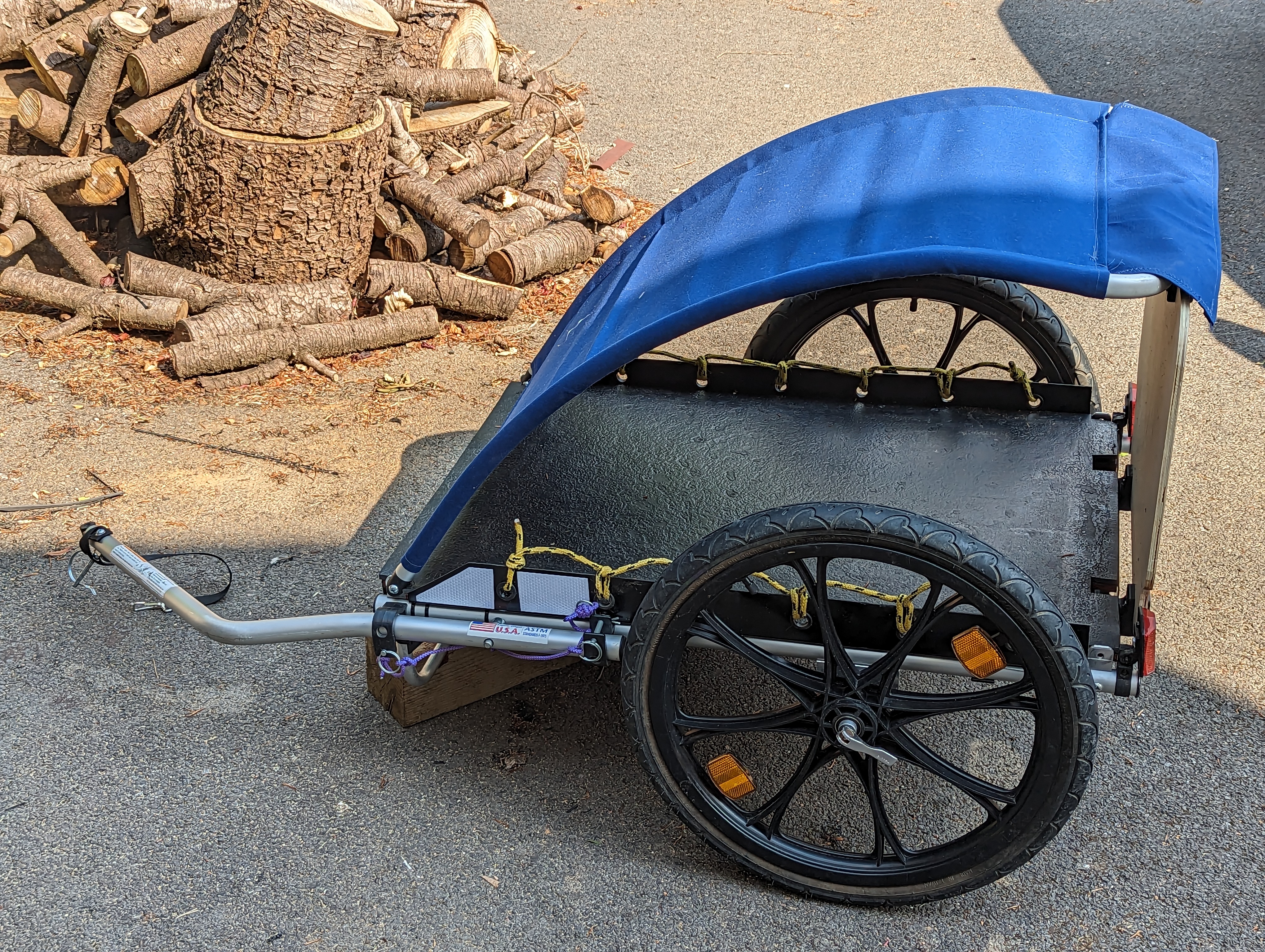

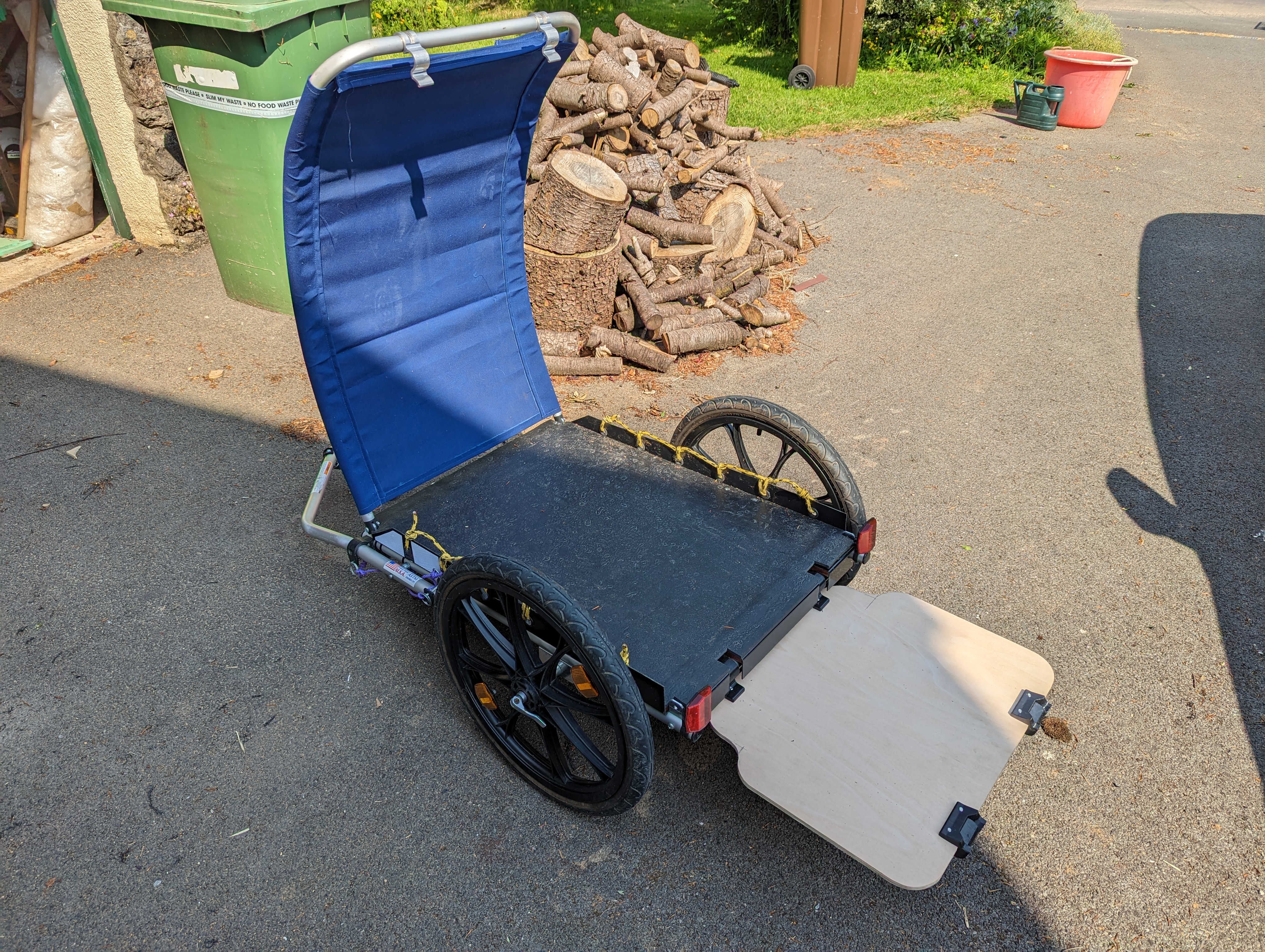

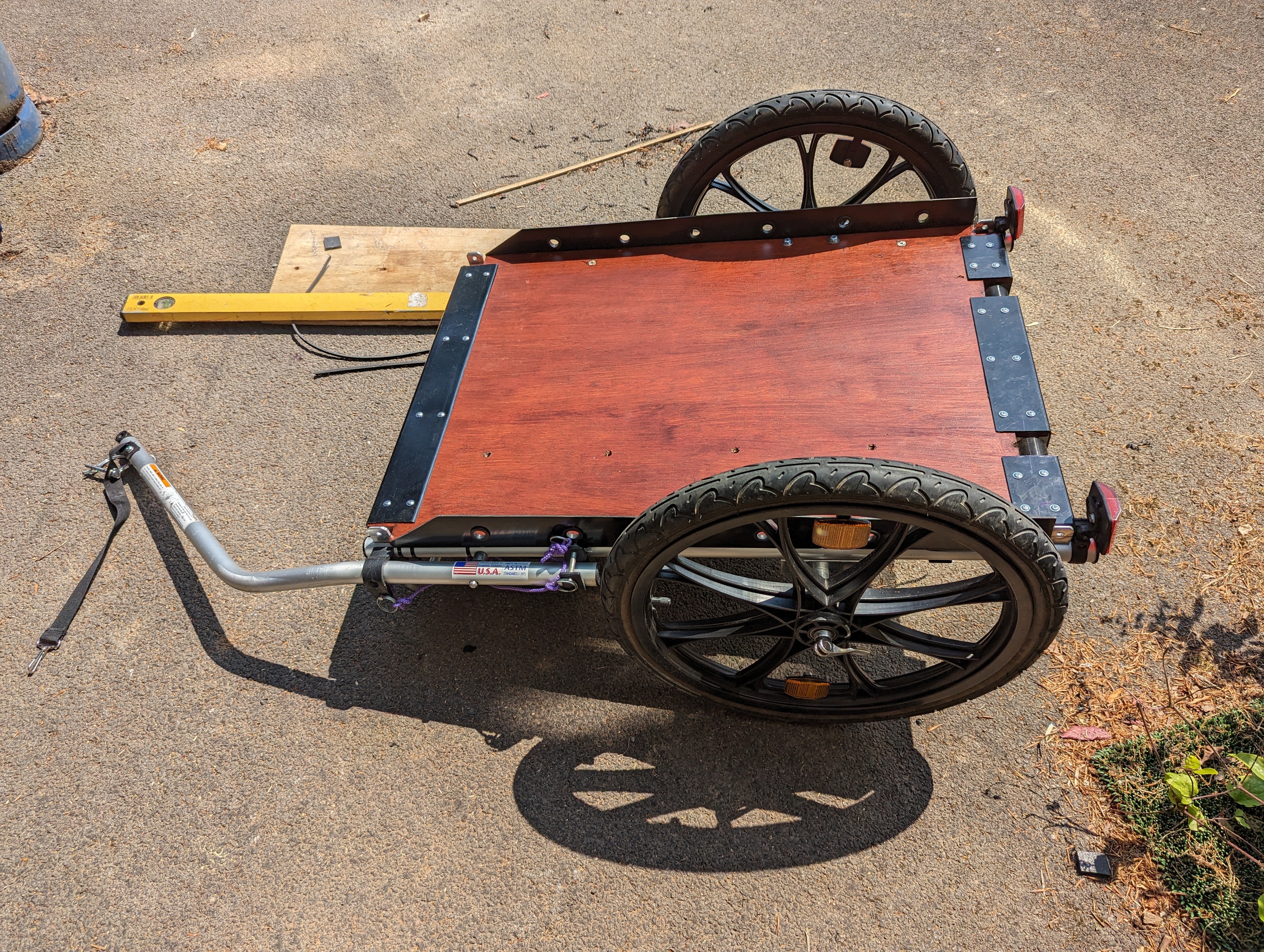

June 15, 20232 yr Part way through modification: And a few more: Need to varnish the tail gate. The cover and tailgate are quick to remove, although I'll get some quick release pins for the cover instead of nuts and bolts. Everything folds quite flat and the wheels are quick release. There is enough room for my caving kit and the cover will stop direct rain - my kit is usually in an open top trug so the sides are waterproof. Also plenty of room for a grocery shop. If I need to carry something bigger just remove the cover and tailgate. I have not modified any of the original parts at all so if I ever wanted I could revert back to a kids trailer. The weight is 9 kg without the cover / tailborad and 11 kg with. The load capacity is about 45kg. No Carry Freedom but perfectly adequate for my needs. I've got a 750kg Ifor Williams trailer for my car if I really need to move anything big. Edited June 15, 20232 yr by Bogmonster666
