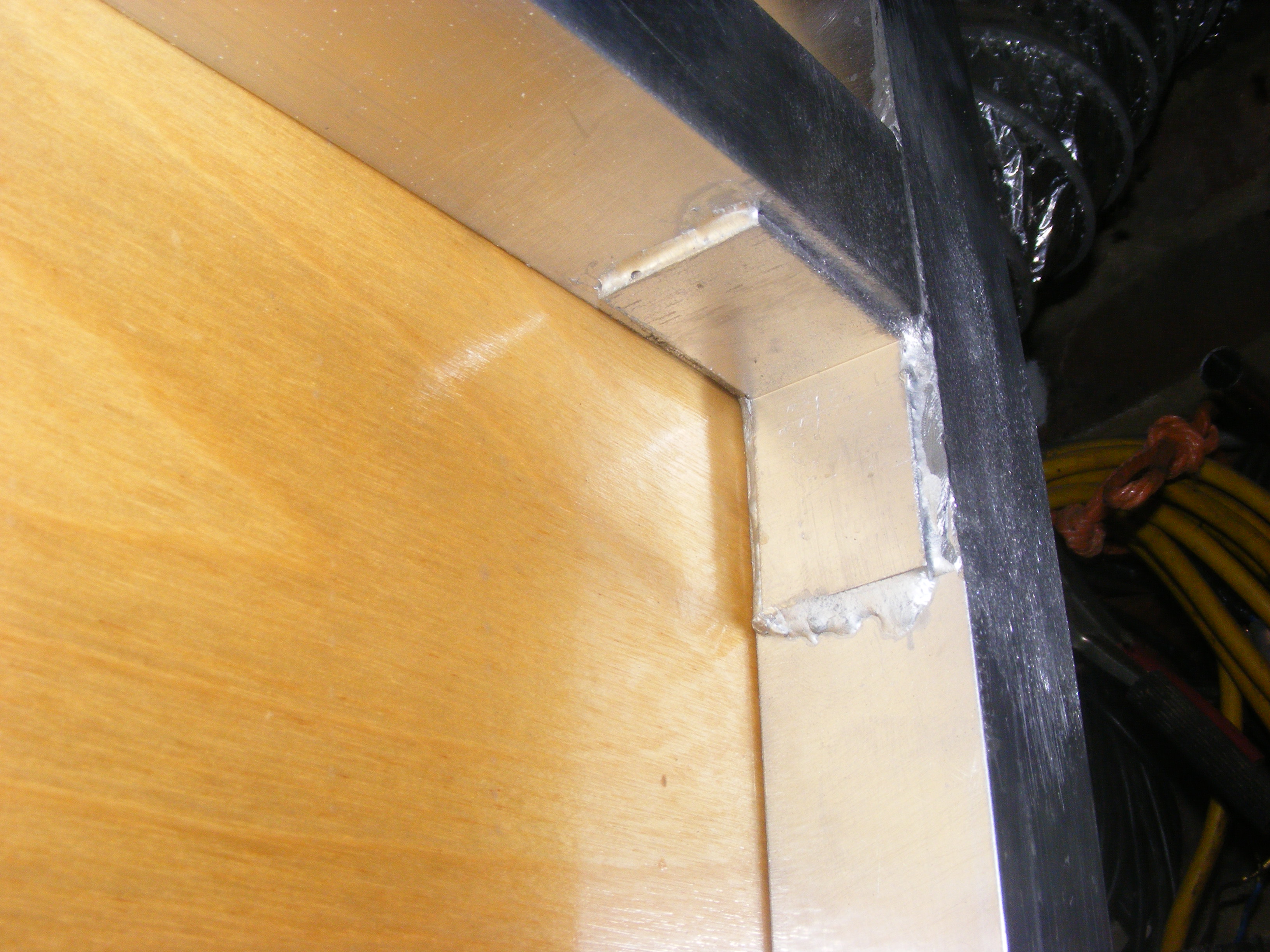

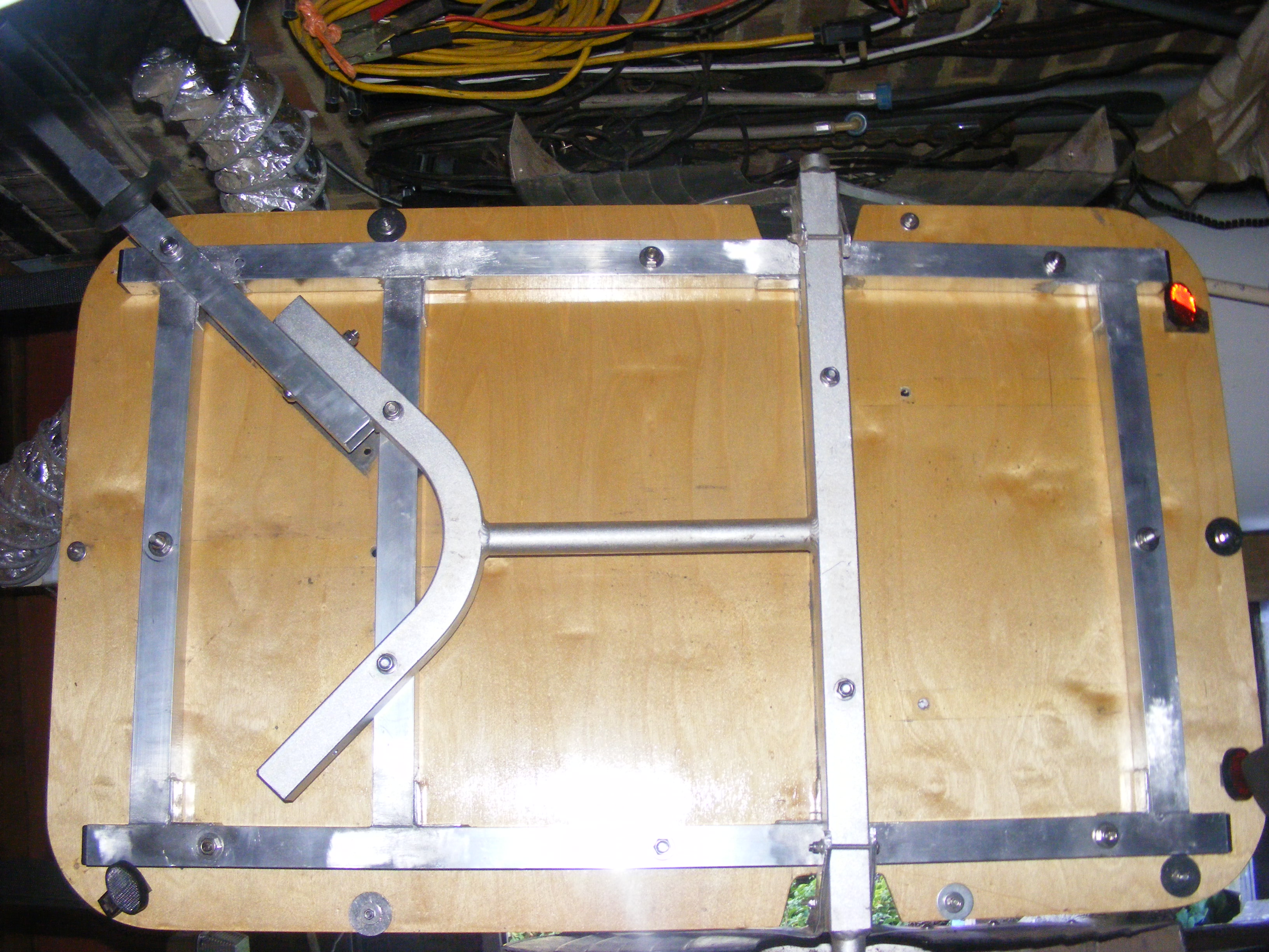

Flat plates brazed on the surface likely not much use, there is a brazed angle gusset on the inside of each corner. The aange bracket will have more strutural strength depth wise as it is rather then sitting on the surface.
  • Replies 192
  • Views 33.8k
Sags in use would easily be noticed; indicate broken welds, in which case you can always weld more on in various places - such as box section or flat bars over the rear corners?
[ATTACH type=full" alt="49127]49127[/ATTACH]
Edited by guerney
The great thing about aluminium is that it's so easy to work, therefore if the L plate welds failed, you could easily beat with a hammer, wider and longer L plates from 5mm thick ali in a strong vice, to weld to both inside and outside the right angles of the sub frame. Another possibility is drilling small holes through the L plates after welding to the corners, strengthening with pop rivets - a small hole first through the two box section walls and L plate, then a larger hole to get the popping part of of the rivet through the first side wall of the box section, then pop rivet the L plate and opposite side wall together. I was thinking of pop riveting a battery box frame together like that, but might use your ultra low temp welding rods instead, or as well as. But ultimately, adding more weight to the rear rack of my bike, is a bad idea.

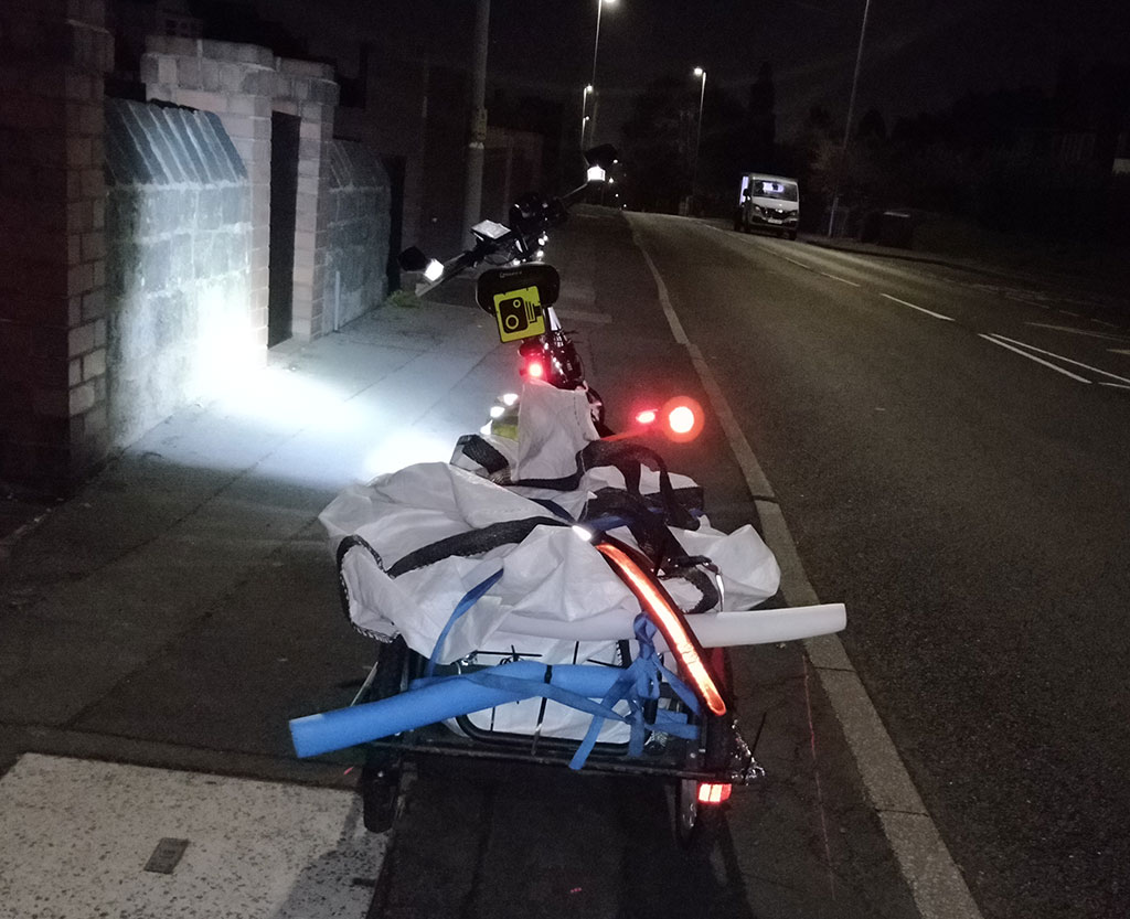

I've just bought 6m of 25mm wide red and orange reflective tape for mine, ideally applied after it's painted fridge bright white Hammerite, and possibly a layer of this reflective laquer spray:
71nVIzmnoqL._CR204,0,1224,1224_UX175.jpg81tsHfc846L._CR204,0,1224,1224_UX175.jpg71+rwyqFXfL._CR204,0,1224,1224_UX175.jpg
https://www.amazon.co.uk/Reflect-Light-reflective-lacquer-spray/dp/B000O5248M/
burley fitted lights

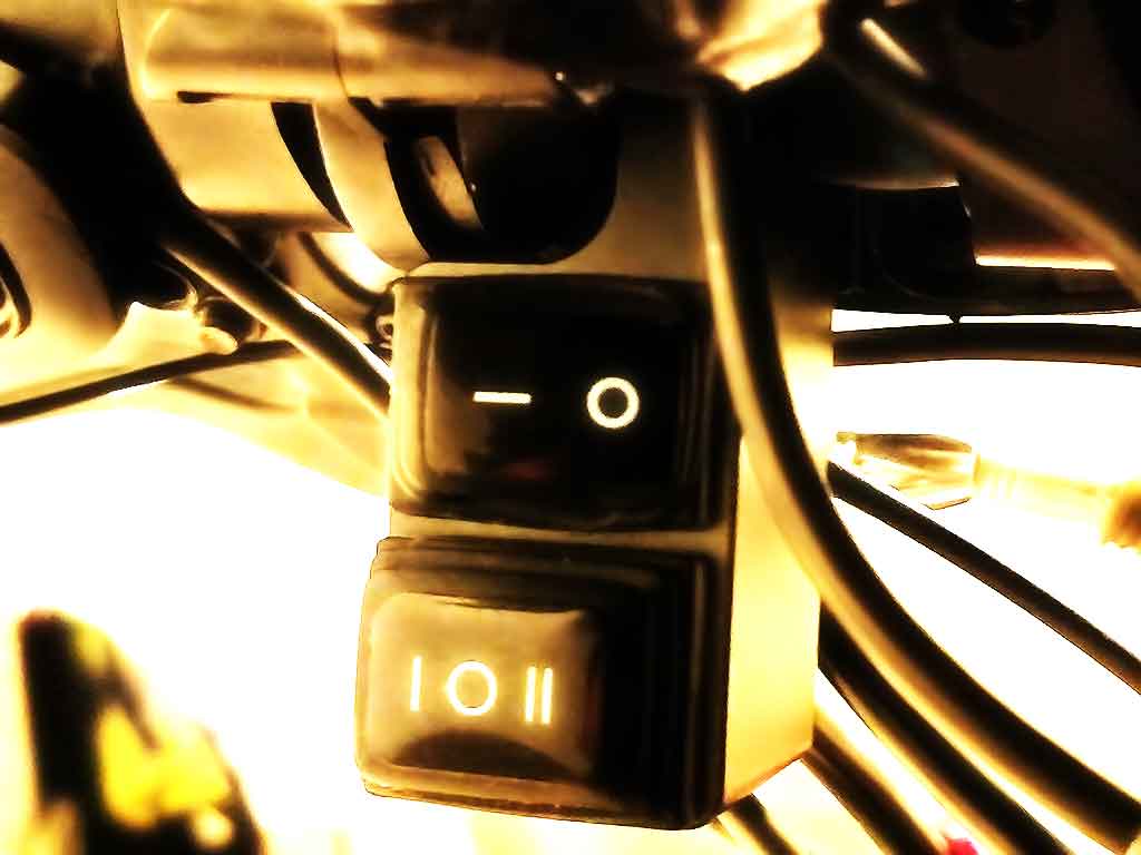

I was thinking of soldering the two now unused 5W Junstars headlights (will be made red for use either side at back) plus side and front lights, from the ebike battery to the Homcom via a spare handlebar switch (it wasn't the switch I ordered, but better - the second switch is two-way three position, presumably for indicators; dual position on the switch #2 - flick left for bike rear red only, flick right for trailer lights plus bike rear red light, middle for off).
Trouble is, I'd need to find a suitable waterproof connector for when I'm not hauling - saw some waterproof Andersons which might fit the bill. A mod for next harvest, methinks - bought 10m (I'll probably never finish it, but it was a bargain) of self-amalgamating waterproof tape... and a ebay seller of self-adhesive marine heat shrink sent me 2m "Free", after originally palming me off/selling me short by 1m - I wont be buying from him again.

First tow last Sunday with the modified sub chassis on the CF and all went well along with the better hitch arrangement , the combo is all set for another season of beekeeping and getting my stuff from A2B and back again.
With the stiffer base board /chassis attachment there is now no flexing of the base so the straps can't slacken to allow slight cargo shift.
As the original pics of the sub chassis have disappeared here they are again.
