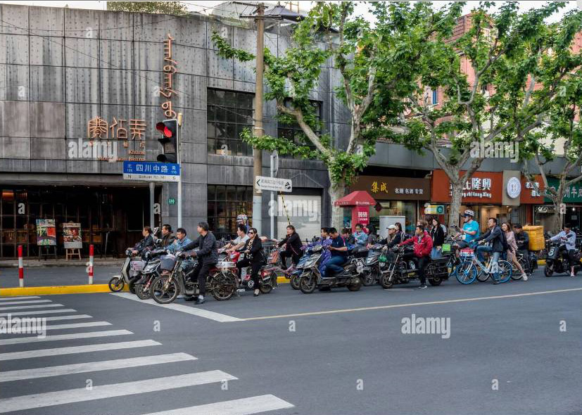

Read the article linked to later and you'll be much better informed about the dearth of cycling in China. The Chinese don't like pedalling and as Wai Won Ching, boss of Ezee Kinetics posted, they don't understand our obsession with cycling up hills, always walking up theirs. In that linked article you'll see a photo of them riding bicycles and not a deralleur in sight and they don't use hub gears either. So when it comes to having a motor they go the whole way with Moped style machines that they don't pedal.
So I trust you'll accept that Mr Ching knows best since he is a manufacturer of our kind of e-bikes which he only sells in the west, never in China. But if not, perhaps youll accept what d8veh says since he had been one of the most knowledgeable of our members. He has been to China to look at the scene there and has reported with photos exactly what I say about their e-bikes being almost entirely mopeds. And they really are as cheap as you say.
The photos below are what they call ebikes:
And below you'll see Honda's latest range of ebikes for the Chinese market. Note the very low geared near to useless pedals and the footrests and platforms to rest their legs on and the huge scooter style rear wheel motors:
Finally here's the link I mentioned. Please read it right though to be better informed about Chinese cycling from 1990 to today:
