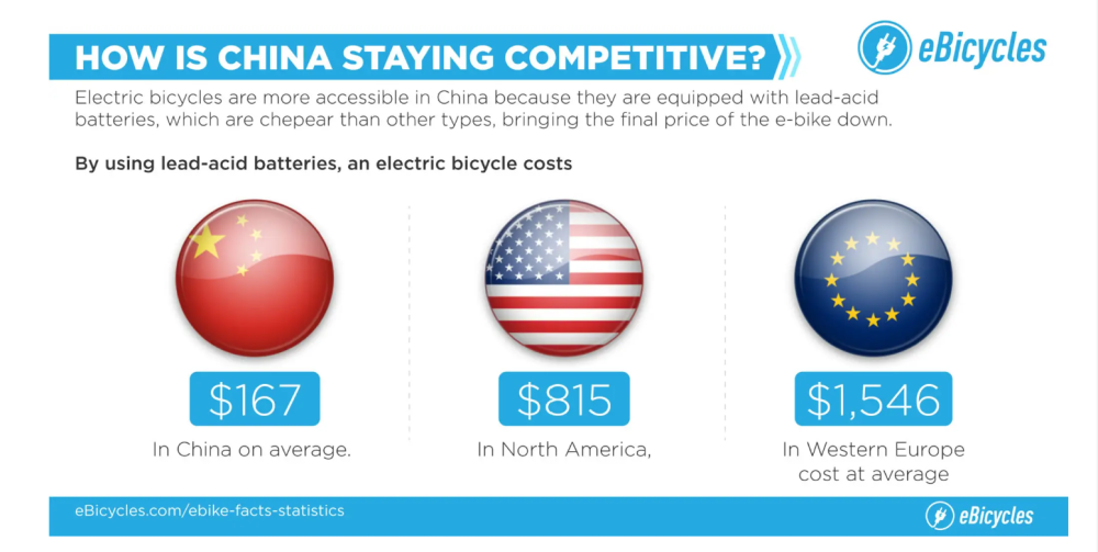

There is a statistic here that shows in China how much an average ebike costs compared to Europe and the US.
https://www.ebicycles.com/ebike-facts-statistics/
[ATTACH=full]50531[/ATTACH]
Ultimately readers will have to decide who is telling porkies and who is being factual. I completely stand by my comments that most people in the world use throttles with ebikes and most of those don't even have the option to choose pedal assist as not even fitted to their ebikes.

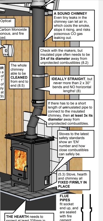

If you are fitting in your own boat (or a second hand one) I don't think RCDs (recreation craft directives) are enforceable.(or pertinent) At time I was fitting out and selling new boats. You will only have to pass your boat safety inspection (which I, d assumed by now would be at similar standards to RCD)
We had to fit only Stoves clearly marked with CE stamps of . (I had to remove two, which although we were told (and sold as) having been tested. Hence the issue.
I, d still be very wary in any boat with a Woodburner not CE marked (or its new British replacement?) or without proof of fitting by registered fitters. It's not a risk worth taking even if it passes boat safety inspection, which I, m not convinced it would.
What you are saying is you could fit a home made stove? You can't.
Not sure but I believe since Brexit RCD has changed name. When I was building barges we had a files of RCDs sent as they became statutory. I think it's RCF now. Stoves were covered.
Screenshot_20230306_220610_com.android.chrome.thumb.jpg.19d715b78044138e5022d6623b444d23.jpg
Screenshot_20230306_220702_com.google.android_apps_docs.thumb.jpg.2a5f38f0d36070b81457bebc650f9e39.jpg
Stoves must show an EN number. It was a CE mark when I was involved.
I never mentioned anything about emissions etc but I, d guess that's part of testing to get EN /CE markings.
Having said all that your own link says it must be an EN marked stove and be fitted to minimum standards (BS something or other)???? by registered professionals??

Rules don't say it MUST be fitted by a professional, only a recommendation. The illustration in your post only says that EN marked stoves are better, again no MUST. You are also presuming it's a home made stove, it's not. https://dowlingstoves.com/our%20stoves/little%20devil.html
While the stove came with the boat there is only the stove and hull below the gunnels left of the project I bought. Complete fit out after having a steel top welded on. I used the innards of a caravan for lots of it.
Rules don't say it MUST be fitted by a professional, only a recommendation. The illustration in your post only says that EN marked stoves are better, again no MUST. You are also presuming it's a home made stove, it's not. https://dowlingstoves.com/our stoves/little devil.html
At end of day it's entirely upto you. Even the RCDs I was working under were directives and at time (around 2001) it was a new scheme and builders could self certify (even putting on their own CE numbers) but that was for only a grace period.
Trying to establish a firm and selling boats with guarantees( and doing things "as directed") is a different boat to working on your own boat....
I, ve fitted my own Stove in my house.. And not a "EN/BS/Kite Mark" in site... Did fit it according to all regs but... I think its still risky nowadays.
I personally don't think you, d pass safety inspection if Stove doesn't show some markings... And by time you, ve followed all the guidance (as in both our links) its probably easier to simply pay for it fitting.. And let them take risk. (that was especially case with RCDs)
We had fitted 2 stoves supplied by customers. Was a massive mistake. (neither had CE markings)
I, ve fitted probably 15 barges out, certain jobs I now wouldn't contemplate... Major 240v electrical, any Gas (except coupling up) and stoves... Not because I can't... Don't want the comebacks.. And legislation.
It can come back to bite you.
But boats have always been the individualists home builders saviour.. (we are about last country to not enforce compulsory certification for boat use).
So, make a good job of it and you, ll be fine..I would try and find some markings on stove tho, or have a word with local surveyor/boat tester.
Nothing wrong with caravan stuff. It's fine..
Good luck. Sounds a good project..
