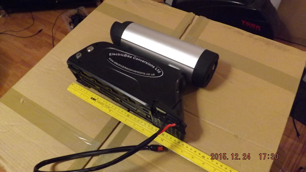

10.4 ah bottle battery 5.3 lbs
ebc battery 3.1 kg 6.8lbs with mounting plate (not sure how I separate battery from mount t
Use key to unlock battery, then slide the battery along the docking station, away from the power cable end.
